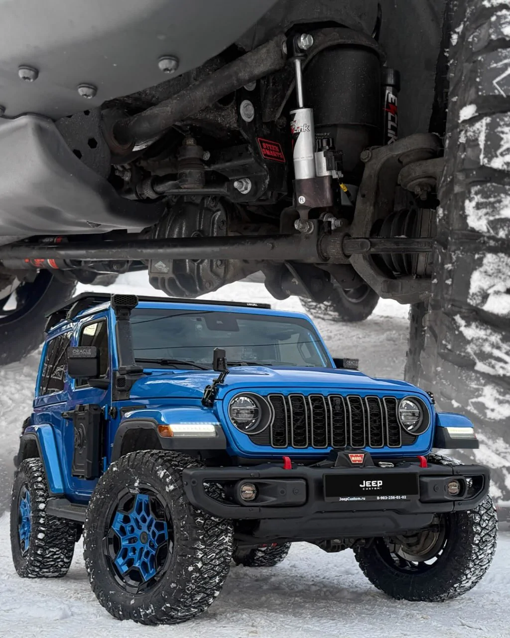

Because air is air. Im able to adjust high in seconds.

Its also not as capable as a properly designed spring system. Theres a reason you dont see them often.
That said there really isnt any reason the 4 door system probably wouldnt work on a 2 door. Other than maybe some fab for line length and tank placement.

Having installed one of these AccuAir systems on a 4 door, there would be not enough room under a 2 door for the AccuAir tank and compressor and valve block on the bracket it comes with. Now if you wanted to fab up your own mounting solution for the tank, compressor and valve block (I'm sure the tank would end up needing to go in the jeep) the actual suspension parts would bolt right on to a 2 door. But as it comes out of the box from AccuAir it would not be a direct bolt on.
Around the 3:40 time spot you can see the large bracket under the Jeep in this video

I saw it on Youtube guy named Evolved.Jeep.
Im affreid of customing tank and compresor possition. I Awould love to hove something plug and play for 2d.
