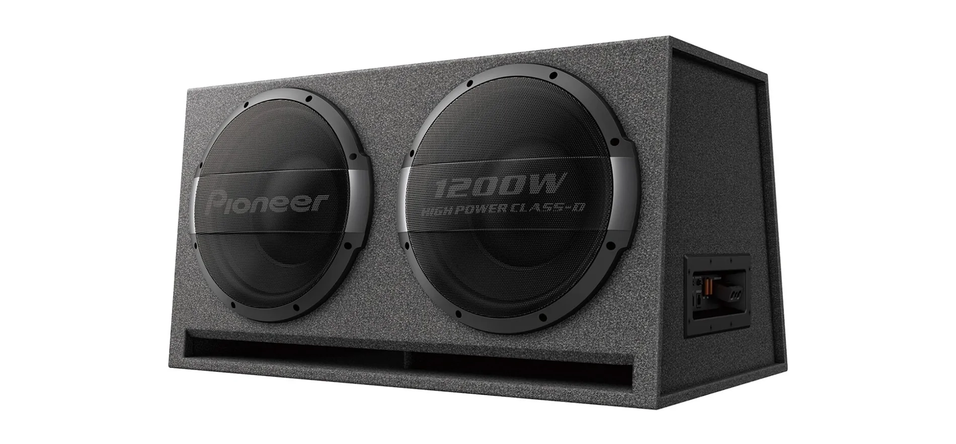

3a. large active 1200W subwoofer and connect it so that it can be removed
Jeep Wrangler JL Subwoofer 2D 003_60

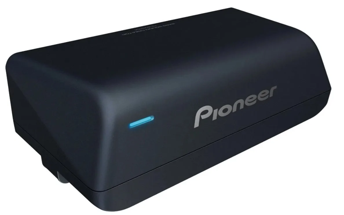

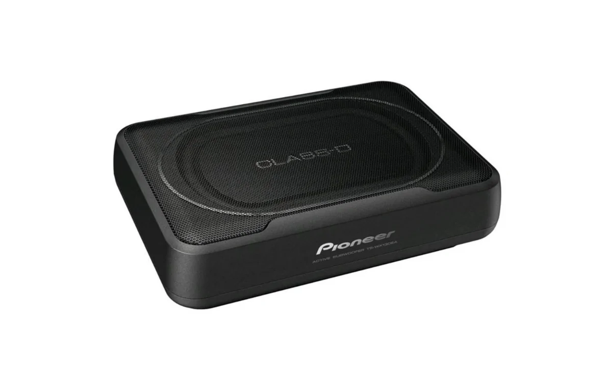

3b. small subwoofer one or two under the front seats
Jeep Wrangler JL Subwoofer 2D pio4
or
Jeep Wrangler JL Subwoofer 2D pio5

- Where are you going to put your suggested subwoofer boxes if not in the trunk? The seats don’t easily fit anything below unless it’s very compact, which doesn’t drive a ton of bass at that point.
- Your factory setup determines how easy this upgrade will be. Do you have the Alpine audio from factory or not? It will change the path you chose. In either case there isn’t just a simple “subwoofer out” or “speakers out” behind the head unit. You need to either splice into speaker wires or use additional tools.
