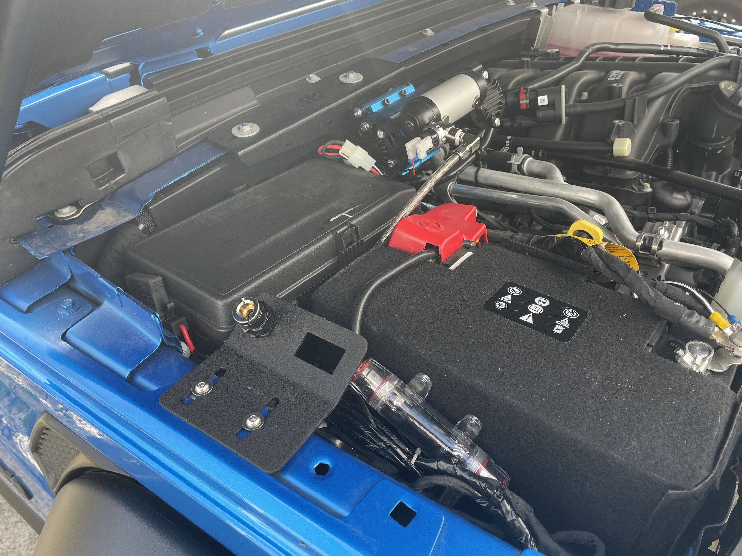

Under the hood but in a slightly different location.
Have you had any heat issues at all? I moved mine from under the hood to under the passenger due to a myriad of problems I was having with it in the original location.

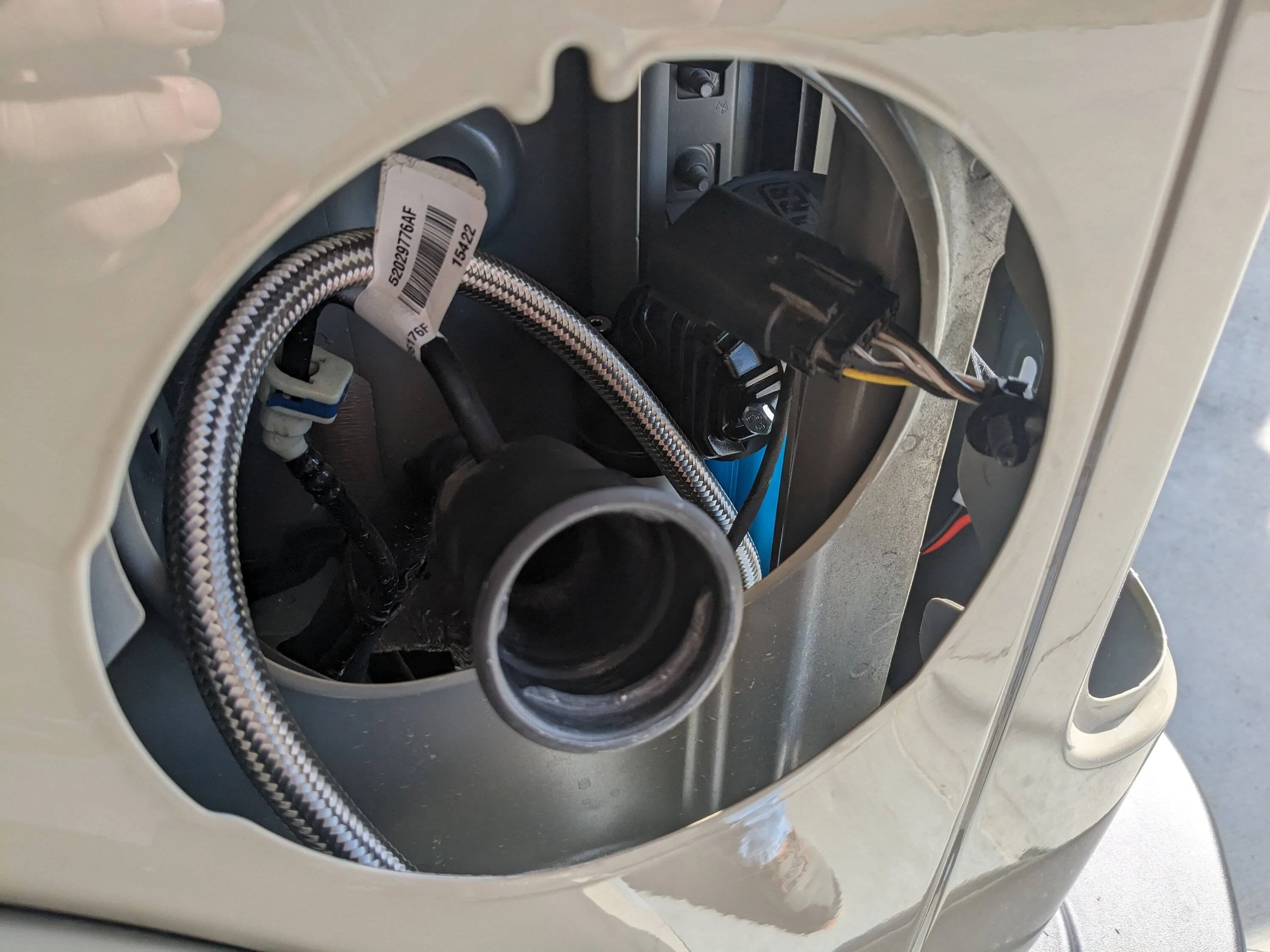

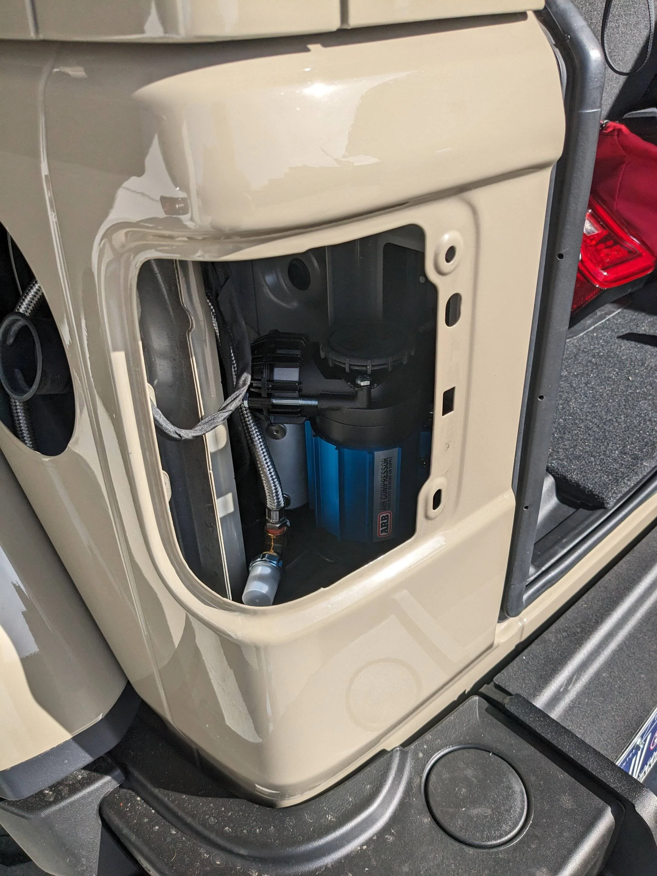

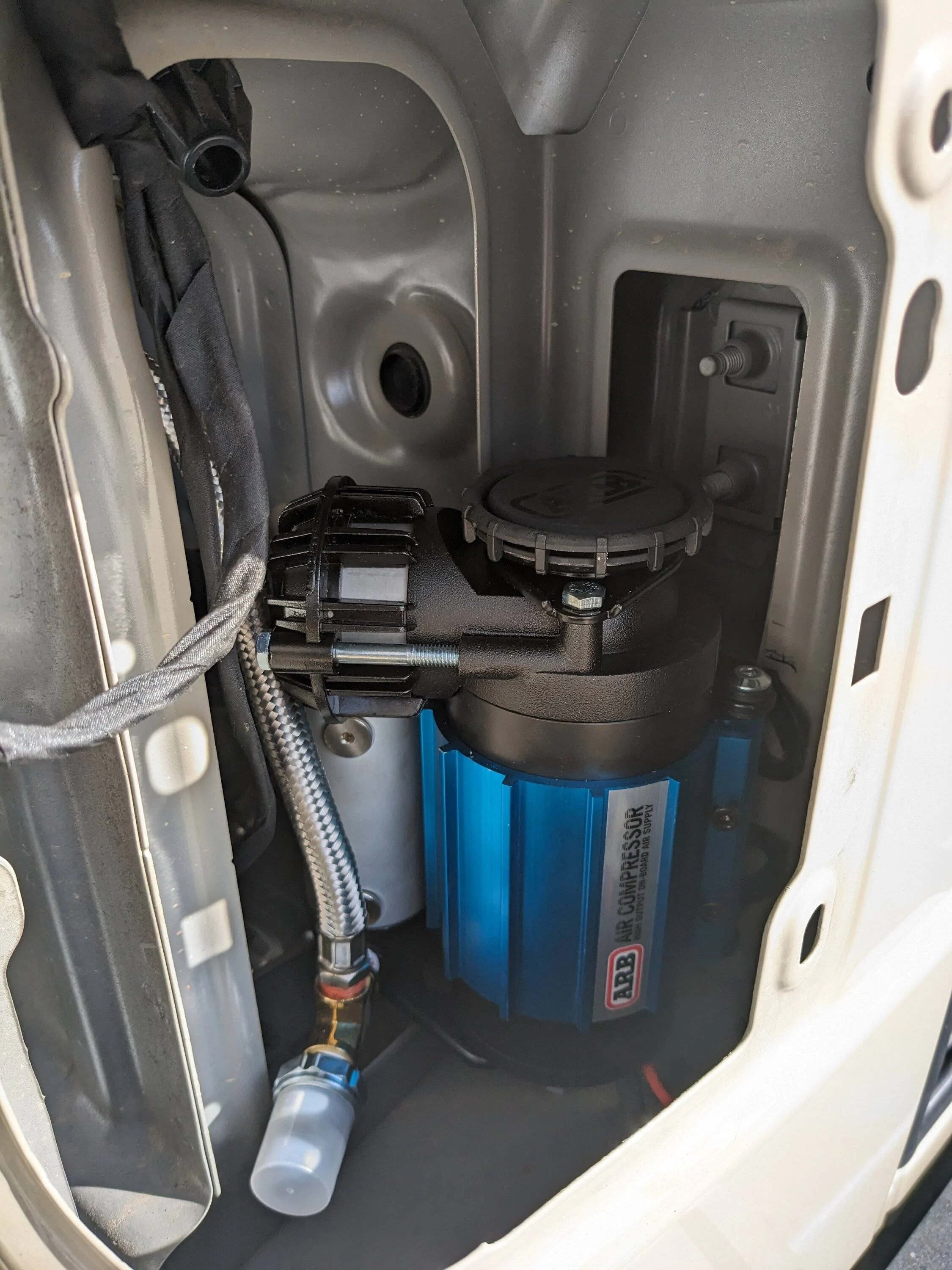

I took an idea from someone else on here (can't remember the username) and mounted behind the driver's side taillight.
For the chuck I mounted inside the fuel door using Next Ventures part. Also extended the air filter to inside the cab to draw cooler air.
Entire plan was to focus on space maximizing and not having to open my hood or doors in case I have to air up in the rain.
Nope. Not a one. I use it for my tires and when I do that the hood is open. The other use is the swaybar bisconnect so it only cycles for like 15 s every. 15-20 min
