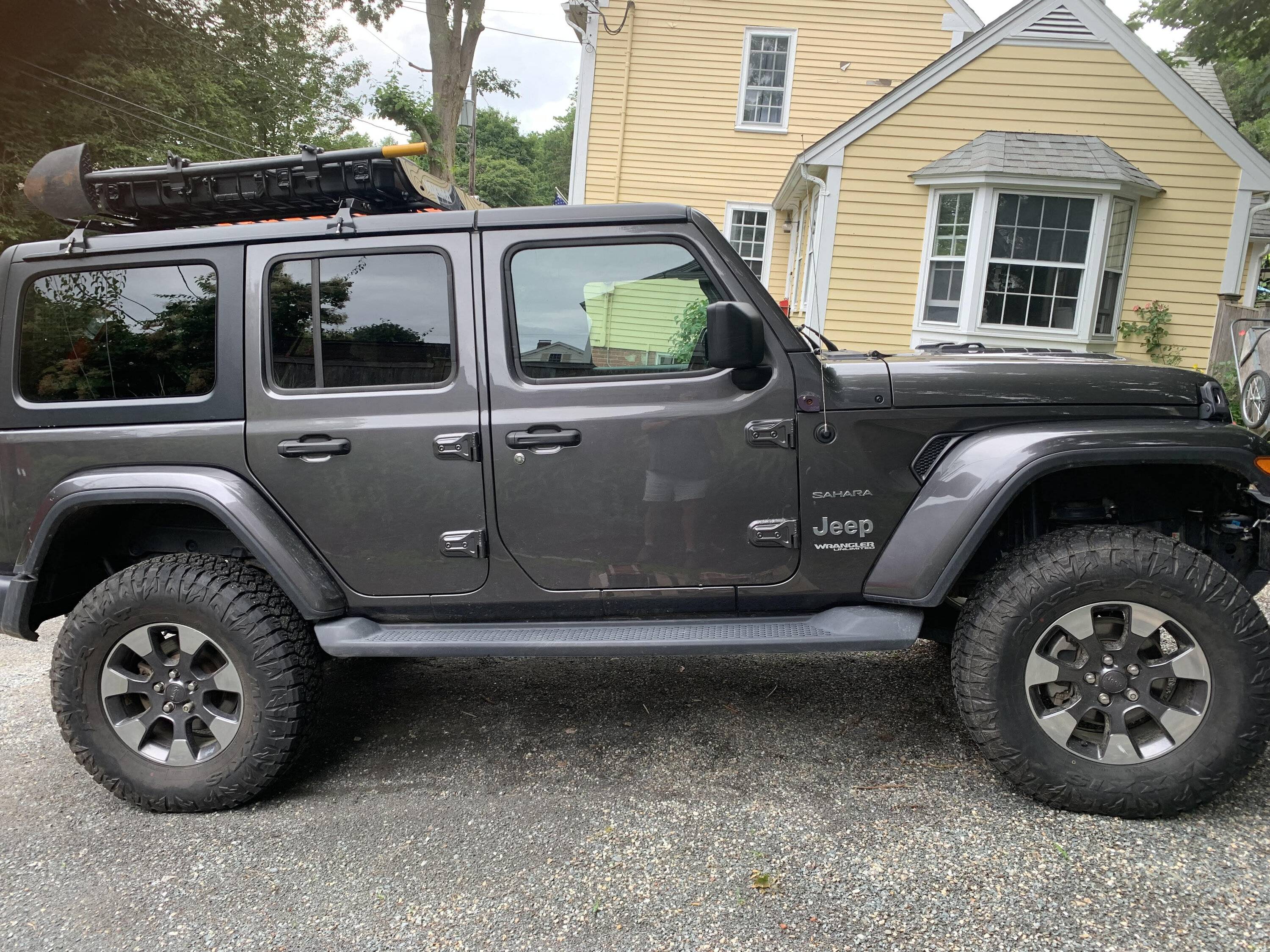

So as I start doing more and more advanced trails I've really noticed an almost brutal side to side "whipping" motion going through rock gardens and the like. I don't know what I don't know, and this might be perfectly normal, but if it is I have no idea how anyone brings dogs with them offroad, they'd be shot clean out the window! I have been trying to research ways to minimize the motion, 100% understanding that the major percentage of the movement will always be there no matter what I do. There isn't too much information available out there that I could readily find, but I have been able to break the info down into 3 camps:
Rock Jock Antirock swaybar to better control the motion offroad while still maintaining a fairly drivable on-road feel;
Adjustable or firmer shocks to slow the side to side movement;
A 5-point harness as the head follows the body. If the body is well planted, so should the head in theory.
Anyway I'm hoping someone can share their experience with head-snap, what they have done about it and if there is any merit to pursing any of the above.
For reference I have a 2018 JLU Sahara hardtop, 2-1/2" MC lift, MC Rock Sport shocks and a roof rack with a very modest amount of weight up high.
