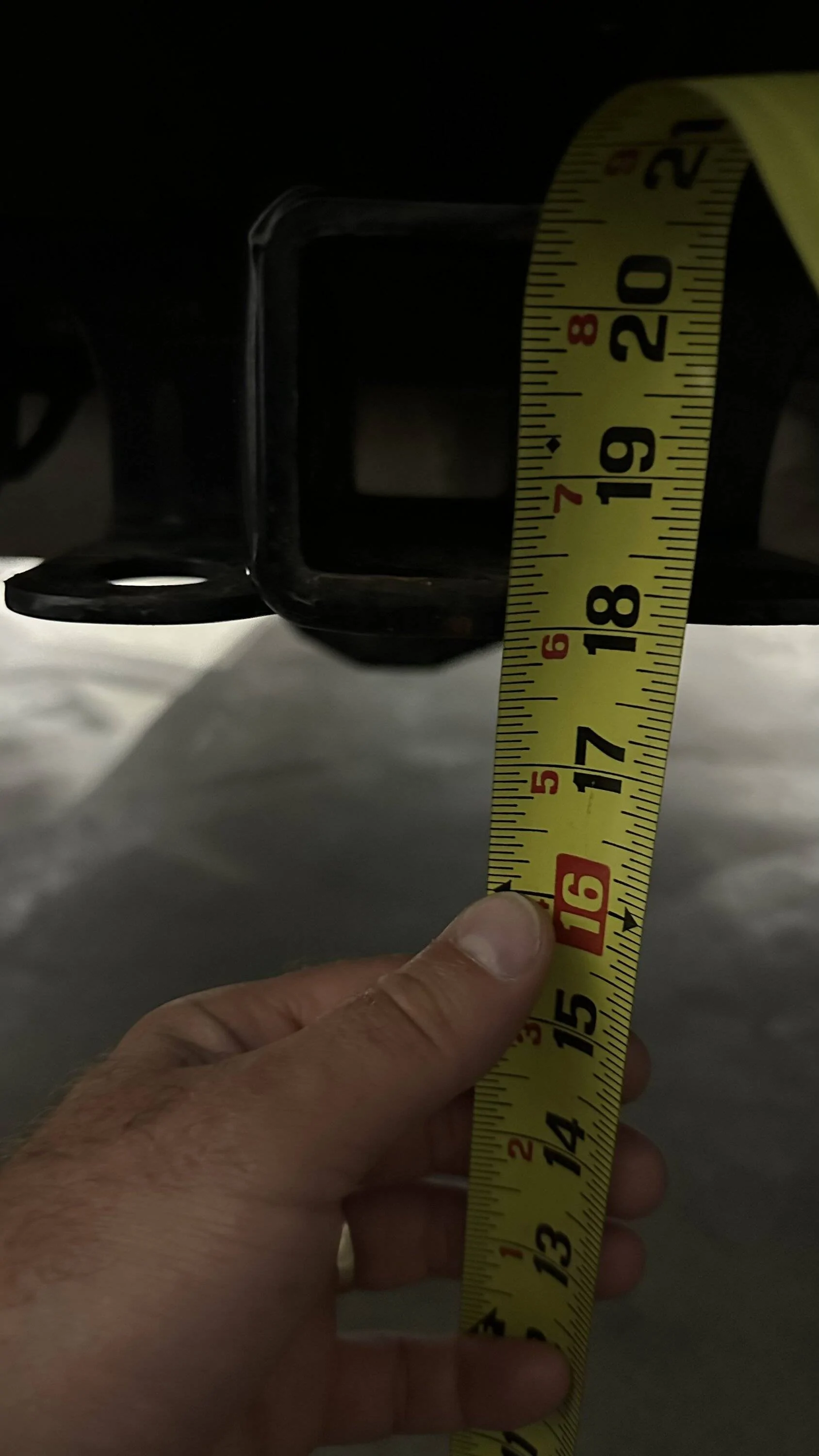

Post installation update: Well, I got the Old Man Emu #3161 (2-door) medium load springs installed a week ago, and have been daily driving it trying to get them settled in. Overall, this was a huge step in the right direction, however I wish I had a set of the next heavier springs to try for comparison. More below:
First, as I mentioned above, this JLR was factory equipped with a hardtop, towing package, and steel bumpers, which I'd think would've provided the stiffest spring combination. Upon disassembly, I had 9111AA springs on both the left and right hand side, and I know some JLR's had different springs on each side however mine were the same.
Free length difference: When you put the OEM 9111AA springs next to the OME springs, the OME's were 1.5" longer. I was happy to see that too as I was hoping that would translate to lift.
Height gain: No matter what this was a win as I gained 1.5" from my previous spring if I hadn't had the 1" spacers installed. Elaborating, my ride height with these springs without any spacers gained me 1/2" lift vs. the ride height I had before with 1" spacers installed.
Measurements: I took quite a few measurements before and after, and feel free to PM me if you'd like any specifics. The one I've been referencing the most is the distance from the floor to the bottom of the receive hitch, and I'm referencing that one because my daughters (factory) JLUR has an identical Mopar hitch on it as well, but for reference, hers doesn't have a factory steel bumper or factory towing package.
This was also an area of a little disappointment for me, as her Jeep in it's factory configuration is still 1/2" higher than mine on that distance, and that's without my bike rack installed. I'm guessing I would probably pick up at least 1/4" of that height if I took off the American Adventure Labs tailgate table, simply because it's pretty heavy for what it is (which is totally fine by the way, it's awesome!). Other than that difference, both my daughters JLUR and my JLR were totally empty. The only other difference that would contribute to a weight difference would be my Teraflex spare rim probably weighing a couple pounds more than OEM, and the Rhino-rack cross bars I have installed, which again are only a few pounds each. I'd consider both of those a non-event, and for reference, as you can see in the picture, mine measures 18" and hers measures 18.5". I was really, really hoping to at least get to her Jeep's level, which is why I kind of regret not getting the stiffer spring.
Spring rate: This is one area I know I improved upon too, because even though I don't have a spring rate measuring machine, there is enough difference you can tell it just by trying to compress the two different springs using body weight/strength. From there, it's also noticeable when driving it too. With the OME's, it feels less spongy in the back, and you can tell there is less spring compression where there would have been before. So even though I might not have got the entire lift I wanted, I don't think it will squat as much when loaded down as a result of these springs. I'd also say the ride quality improved as a result of these springs, because the last ones were spongy enough they probably made the shocks work harder. I just can't feel as much rear bounce as I had before, which is a welcome change, and that is with my bike rack installed too.
Conclusion: Overall this was a step in the right direction and I have zero regrets swapping these springs out as it's an improvement in every way. I'd also argue this is a lot closer to how it should have been from the factory too. All that said, I'd rather it be a little stiffer rate - but its close. Because I still have the spacers left over (2 sets of half-inch were stacked together), I'm planning on adding (at minimum) one set of 1/2" spacers to offset the squat my bike rack causes. While I don't mind a tiny bit of positive rake in the rear, I have no desire to recreate the '70's by having it jacked way up in the back. No matter what, I have a win, and can dial it in a little bit with stuff I've already got.
