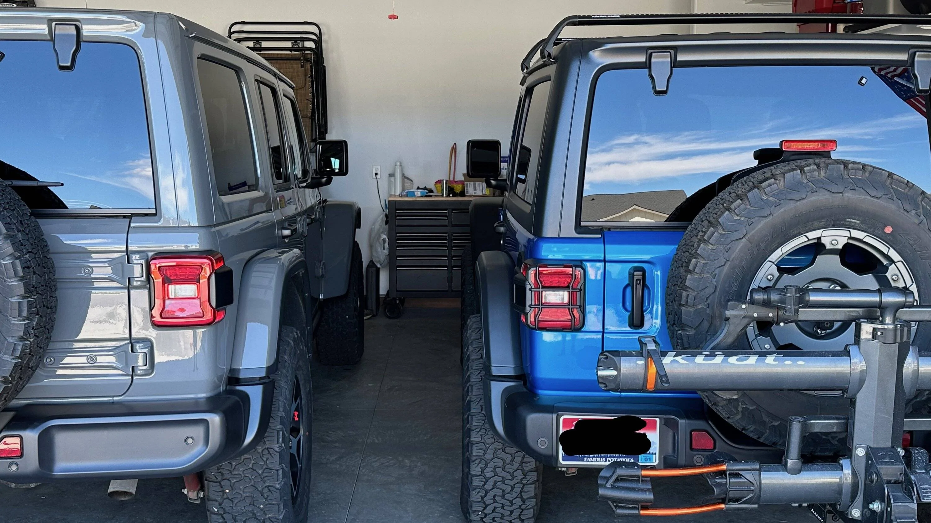

I was on the road for work this past week and didn't have time to do much with this, but it's on the list for this week. Here's a good comparison of why I'm so frustrated. This is my JLR (on the right) next to my daughters '22 JLUR. There's nothing inside the back of either Jeep, and the only two "notable" items on mine that should account for any sag are the bike rack and tailgate table. Plus, as I mentioned before, there are 1" spacers installed on mine too, so obviously without those it would be 1" lower yet.
Note, I don't know exactly how much, but the stock stance (rake) is different between the JL and JLU, at least per teraflex.
If you base it off of how TF does their 1.5" spacer lift, the stock rake front to rear is .5" higher front on the JL and .5" lower front on the JLU. That could mean that the difference is actually in the rear stock.
Thanks, and I have read about this as well. I can't comprehend why Jeep would ever do this, and I'm guessing they achieve this by a lower spring rate. That seems to be counterproductive to off-road capability, especially when loaded with camping gear, etc.
Only thing I can guess is that it’s related to the differences in rated towing and payload and potentially the impact of the wheelbase on load distribution.
