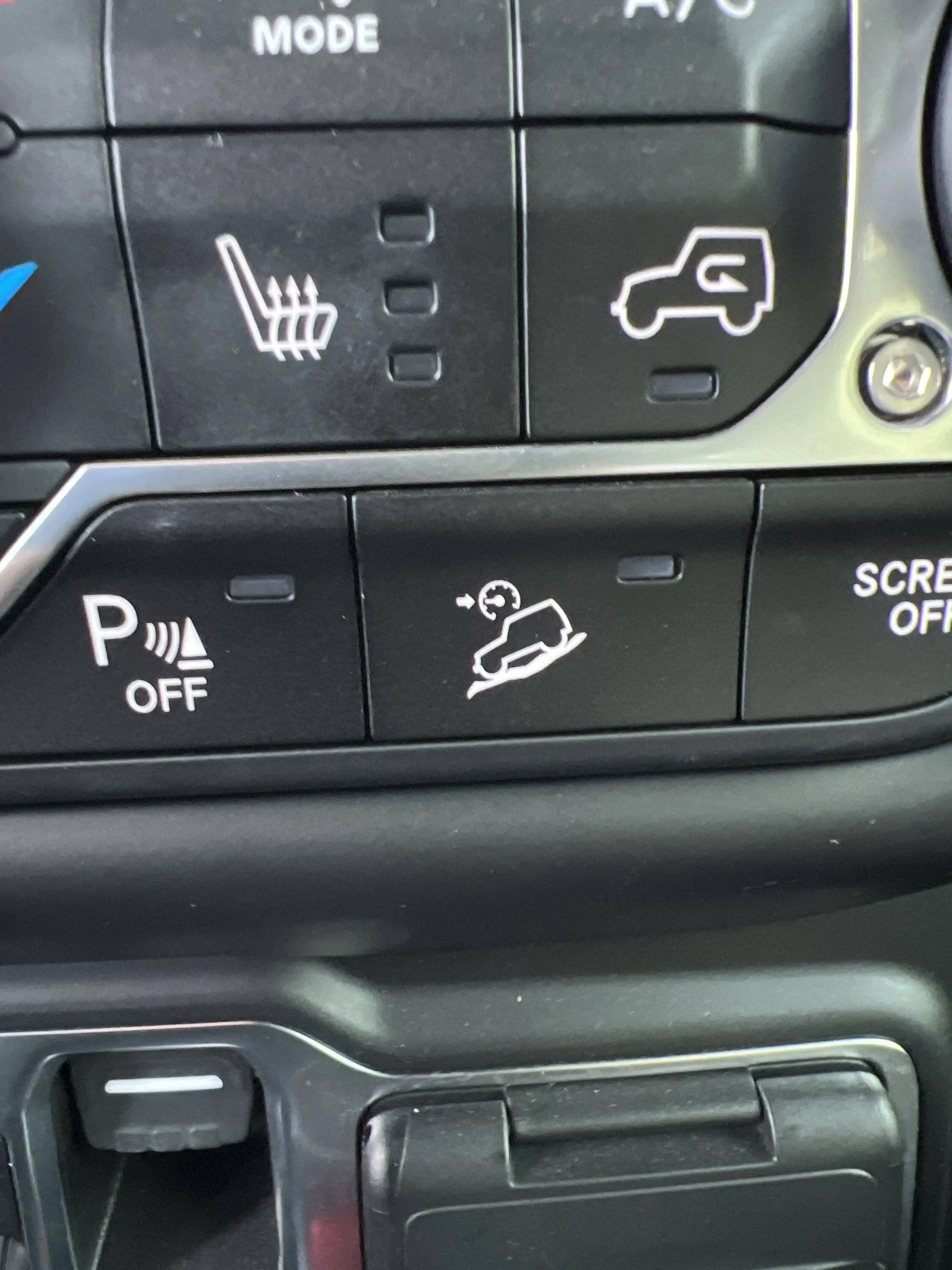

The button that looks like a duck is great for downhill. The default might be 0mph so after you push the button use the -M+ on your shifter to adjust the speed.
