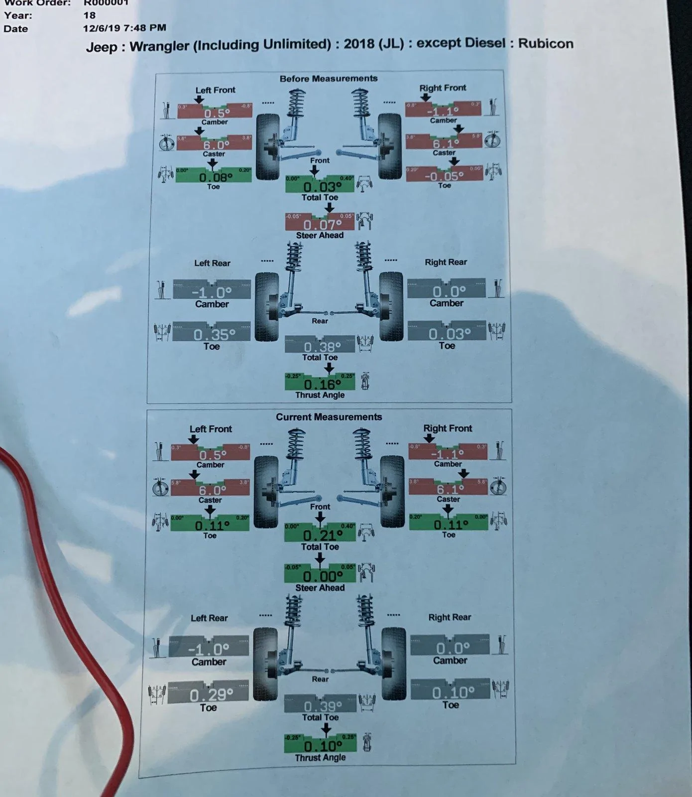

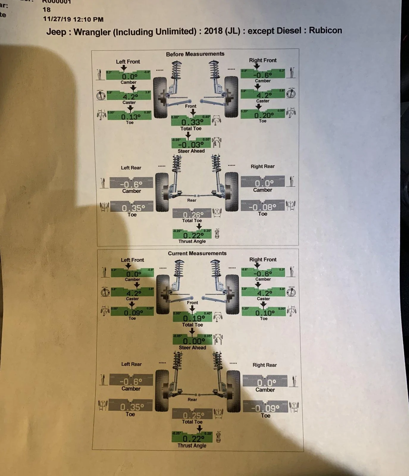

I had installed a mopar 2" lift kit. Jeep drove pretty good but steering was little sensitive/squirrely. I decided to install geometry correction brackets and Steer Smarts XD Track bar to center front axle.
The 1st image is the alignment after installing mopar lift kit only.
The 2nd image is the alignment after geometry correction brackets and Steer Smarts XD Track bar.
Jeep drives better than before, besides a slight pull to the right to do the camber , it pulled to right also before.
How was camber changed when there is no adjustment. I didn't think caster would change camber??
