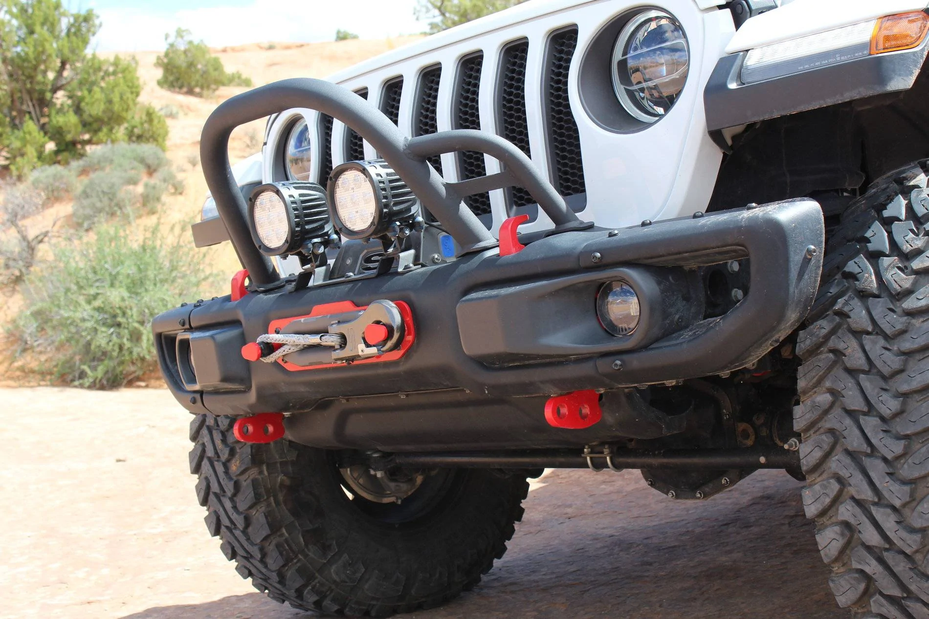

In case anyone finds this thread and is curious about a part number. It is in the Wrangler/Gladiator performance parts catalog.
Jeep Wrangler JL Mopar's "Version 2" Steel Front Bumper 20210223_134632

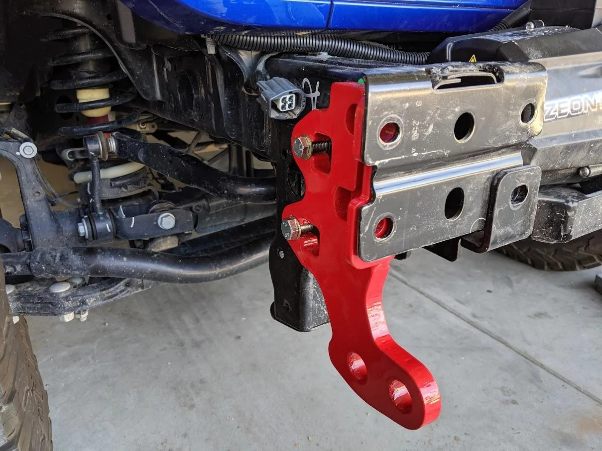

FYI: Maximus-3 and Warn make recovery points that you can add on to the OEM steel bumper.
I've looked into the Maximus 3 (seeing as how just about everything on my bumper is by them), but you have to cut into the bumper and the skid plate. That's a bit too much for me. I'd already have them if that wasn't the case.
Understood. I have them and it was a fair amount of cutting, which involved the bottom web for the outer bolt-on portion.
They're instructions were millimeter accurate though (figuratively and literally... I had to buy a metric tape measure).

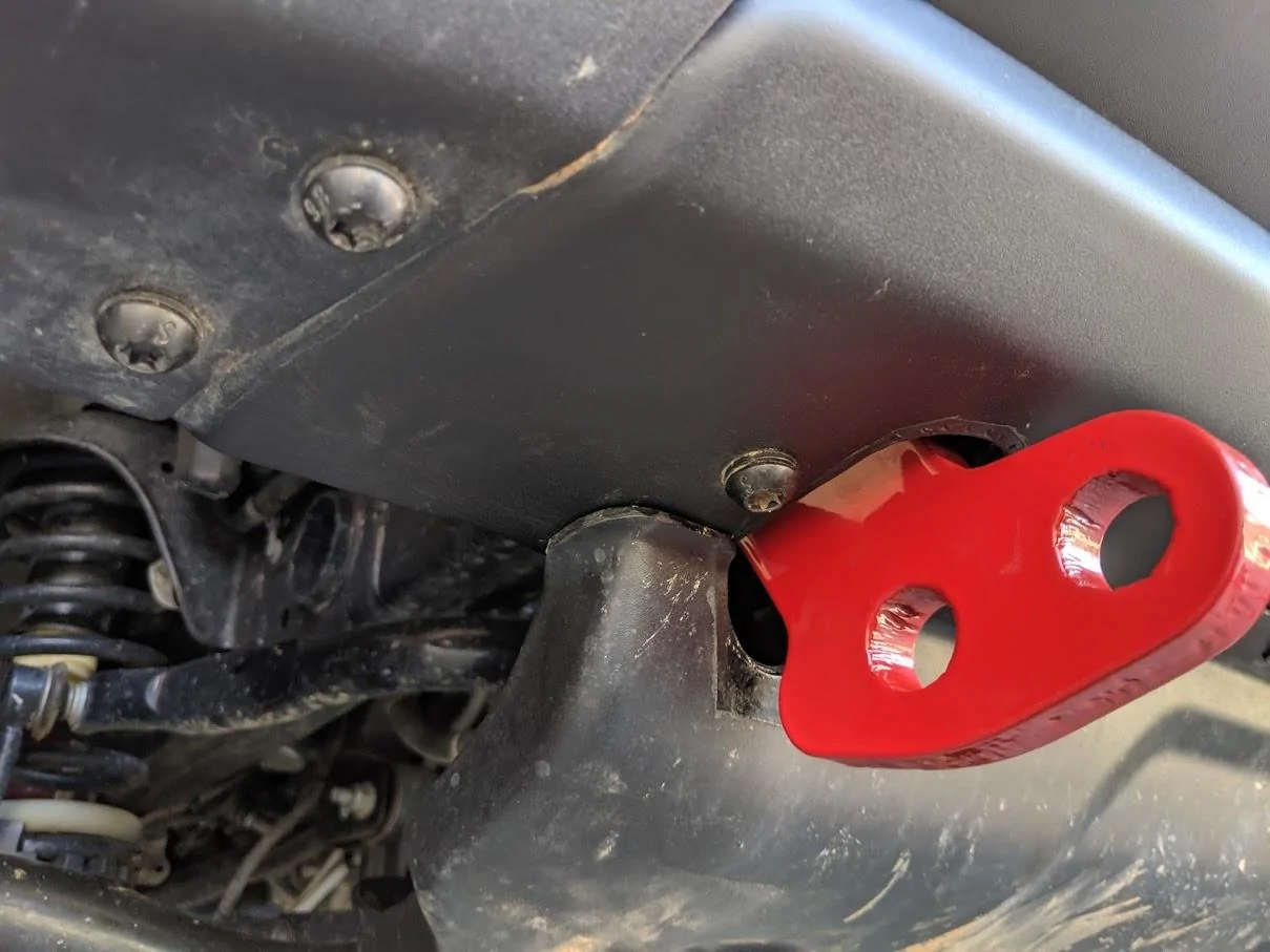

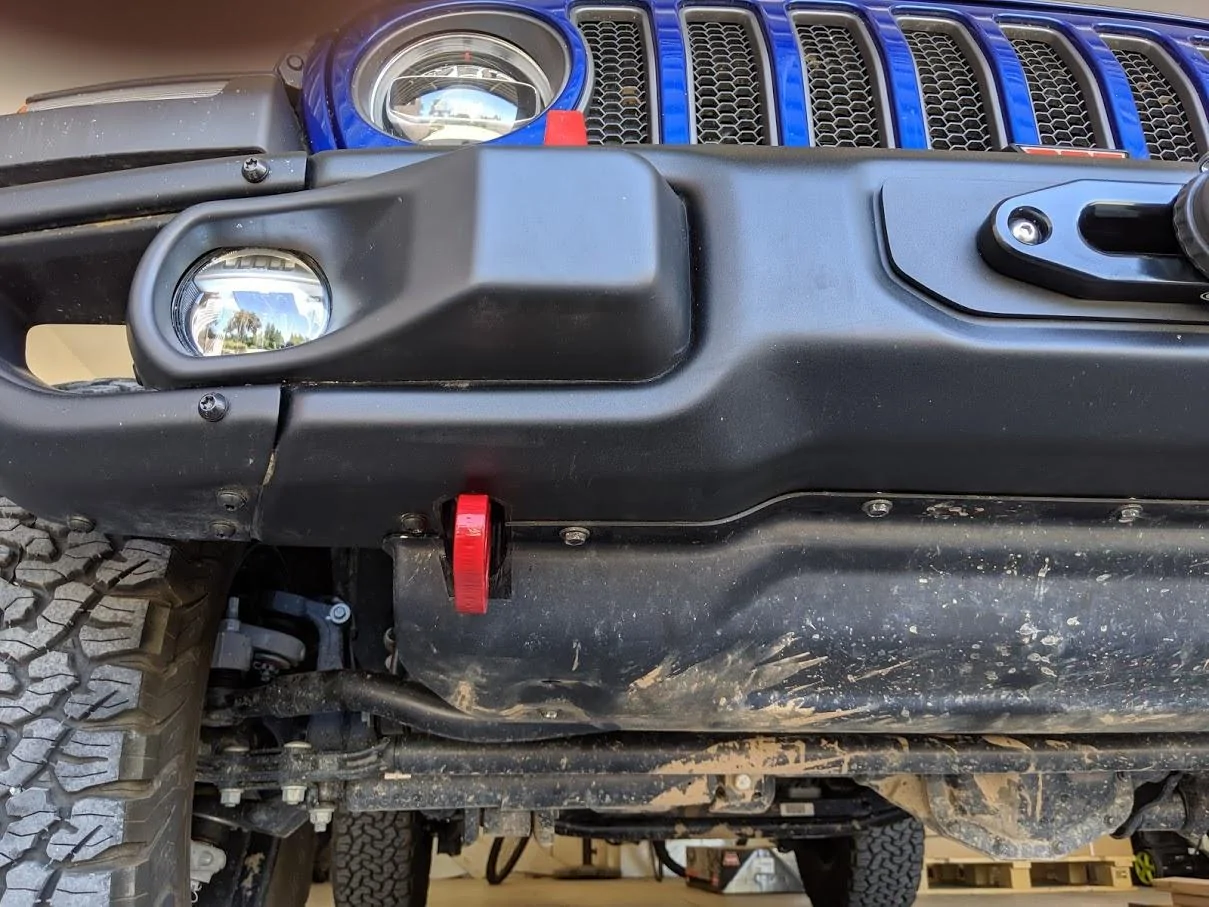

It requires a pilot drill bit, a (preferably new) hole saw to get the rounded portions, and I used an angle grinder with a cut-off wheel to cut the slot. Some light grinding is required to clean up the burrs.
I took the bumper & skid plate off completely before making any cuts, but I'm not sure it's necessarily easier than doing some of it while on the Jeep.
See this post for some close-up photos:
I recently installed the front tow loops (with winch plate), and figured I would share some pictures that show the cutting required.

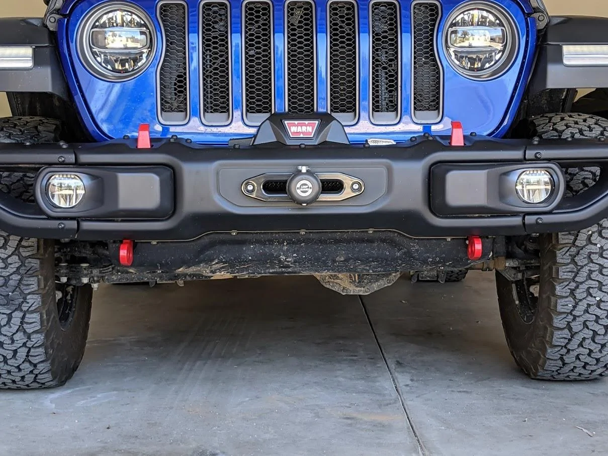

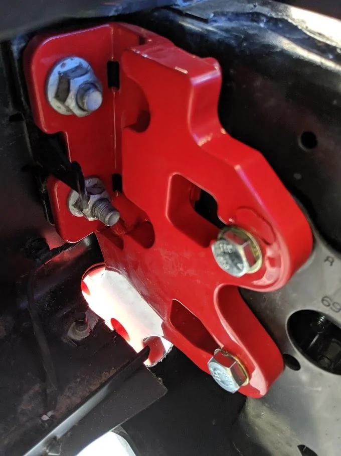

to me those look too thin. Where. Decent side load (Say 30-45 degree angle) would bend them. That to me is an unacceptable recovery point because it could lead to issues of safety or failure. Also on the bottom of the bumper is pretty inconvenient.
They're 5/8" thick steel plate, and certainly safer than the cast OEM hooks. I'm more worried about the frame bending than these deflecting or breaking. Maximus-3 doesn't actually sell these as "recovery hooks" though, that's a different product (see photo below)
Yes, being mounted on the bottom could be an issue if you're stuck in a hole, but they don't really change the approach angle as much as you would think on a stock JLR.
There's also this option, but it would look so much better if it was powdercoated to match the bumper: https://www.hkoffroad.com/products/jeep-wrangler-jl-jt-shackle-tab-kit-for-stock-rubicon-bumpers

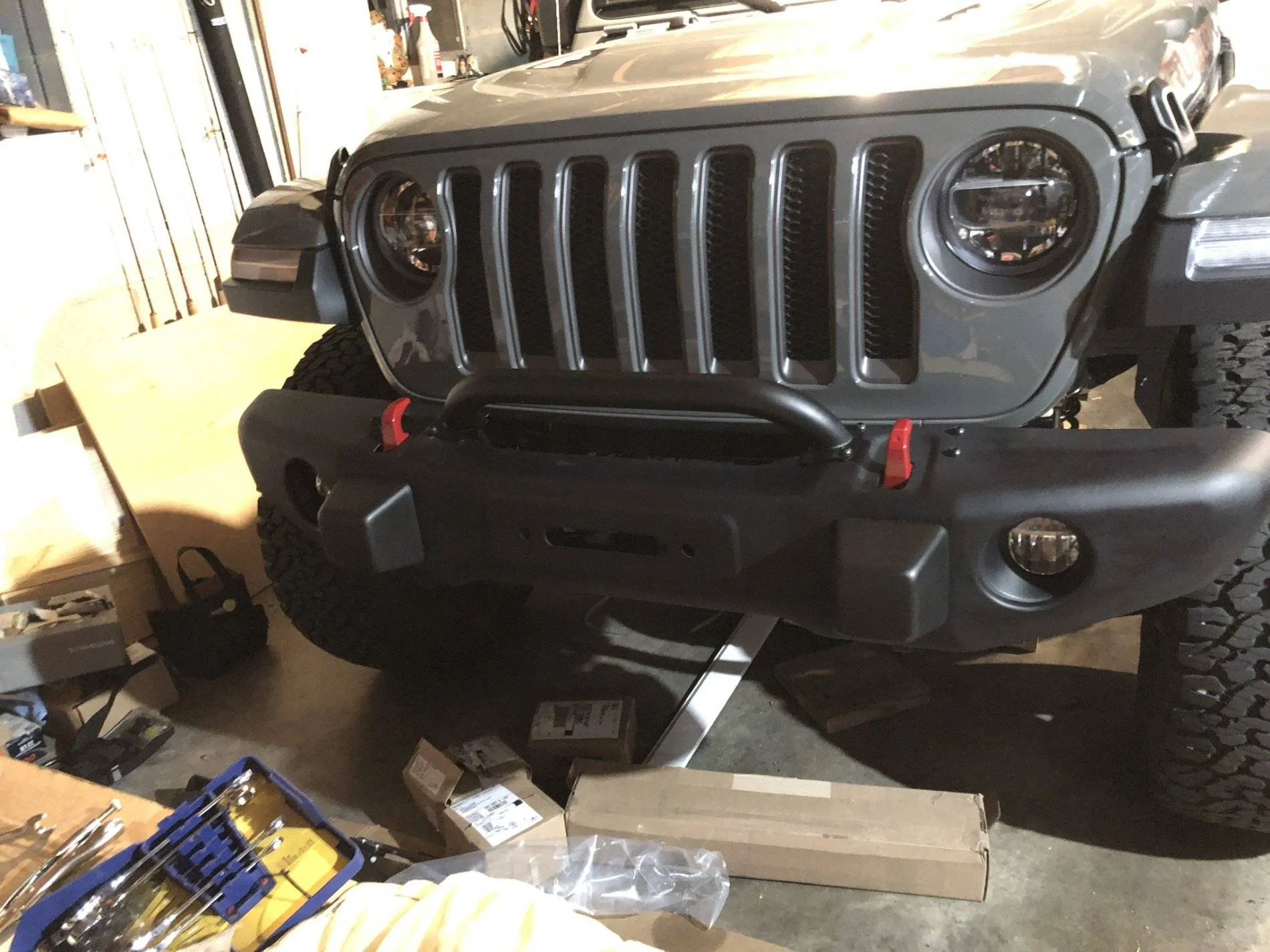

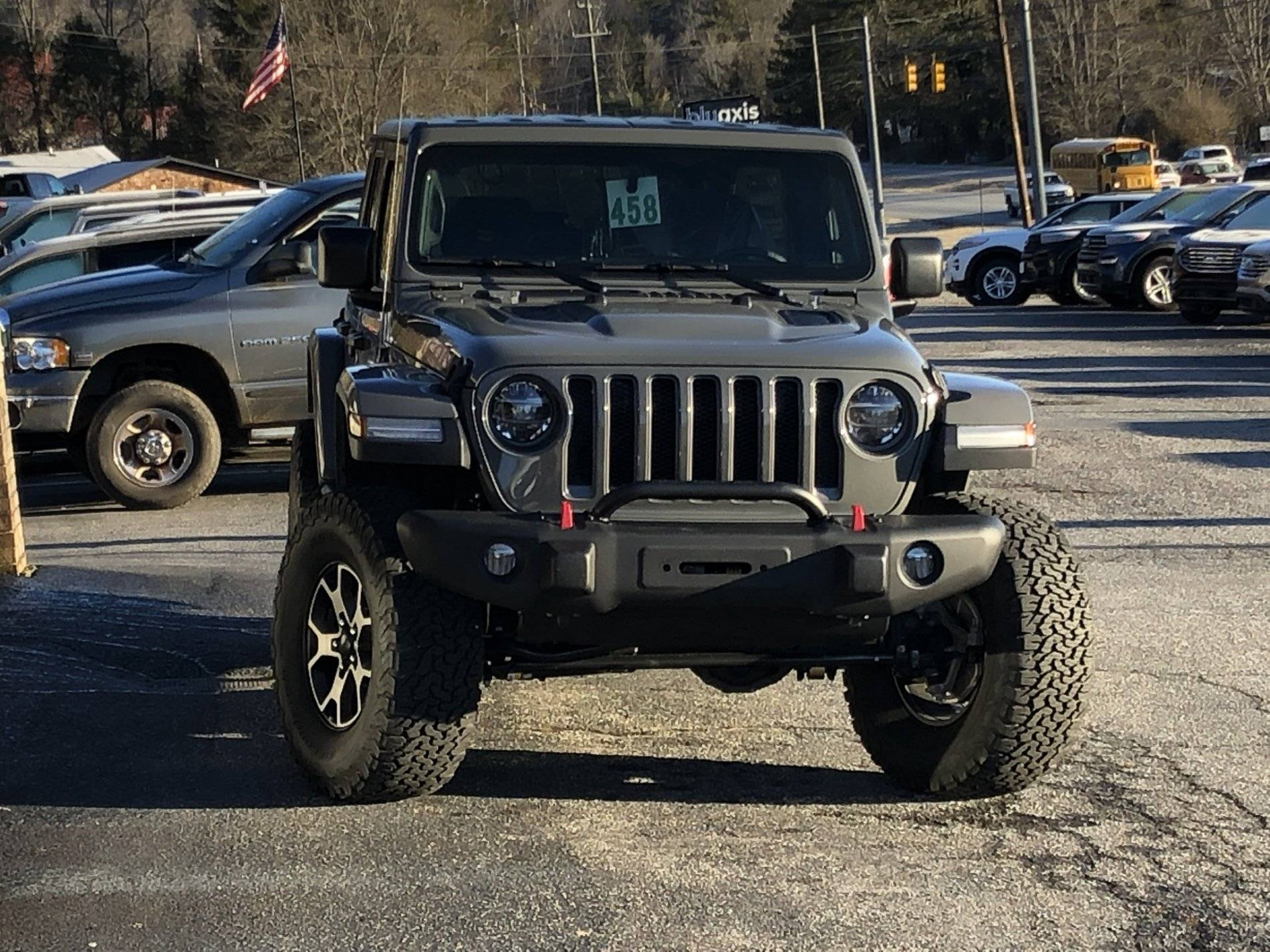

I have it. Picked up from a guy with the skid and winch plate for 700. Too good of a deal to pass up. It’s more of a mid-width and the only plastic on it is the crush can covers. Definitely more solid.
Got to get a winch in there.
Wow, I like it even more inu these pics! Love the smooth look to it.

Thanks. I thought the same. When I saw the mopar pics, I wasn’t impressed. Then I came across a good deal and gave it a shot. Really liked it once installed. I’ll run it until I see a front bumper I like more. I struggle deciding on a front bumper that doesn’t look like a big block of steel up front.

It definitely looks better in your pics than in the Mopar ad. So you got the skid plate too?
I'm assuming the bar is removable?
