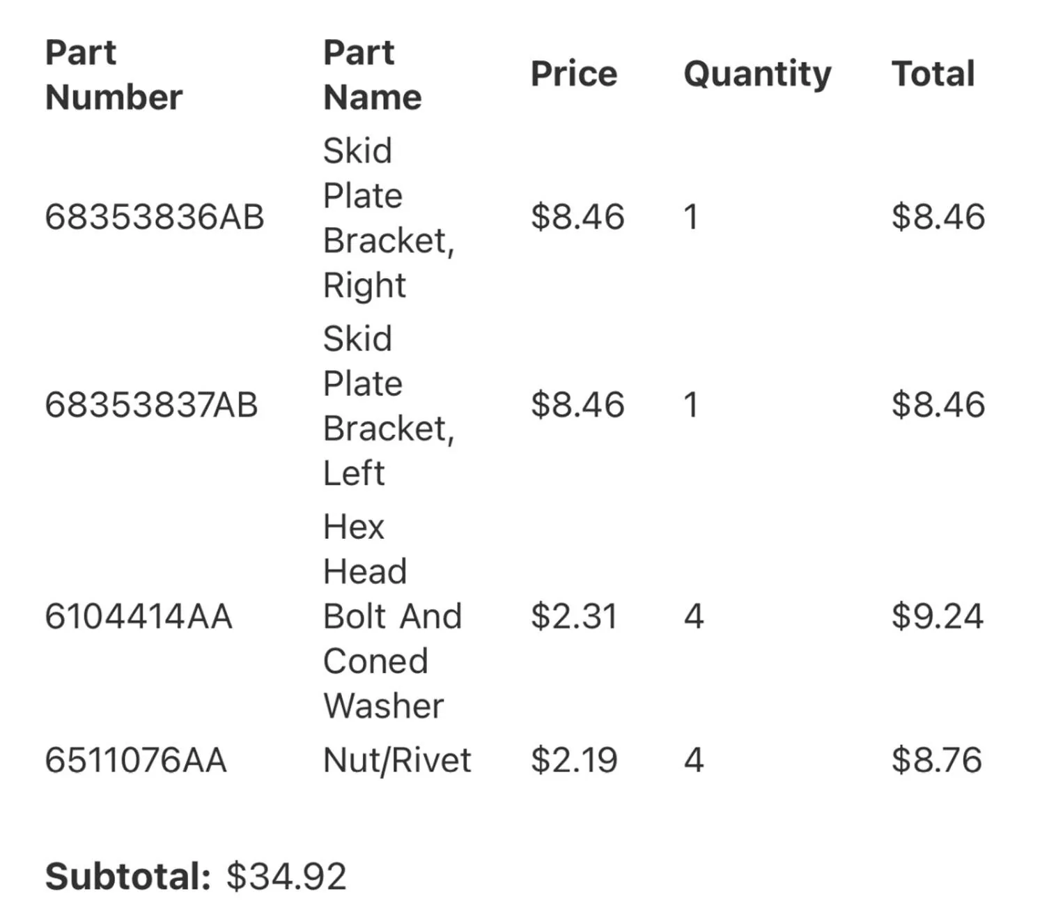

LED fogs will require a new mounting bracket if you pick up a bare bumper. Other miscellaneous steel skid plate nuts and bolts below as well.

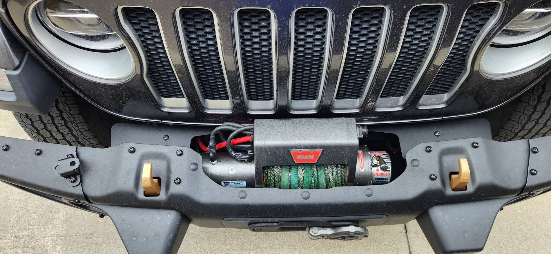

Hybryd40, I found an as new Mopar Steel bumper at a local salvage yard for 1/3 of retail price. Researched the available winch plates and saw that some had few / substandard attachment points to the vehicle and were bending under load. I went with a Mopar winch mount. Space is tight for Warn Winch Wiring up next to the grill. Very pleased with this set up. Factory engineered parts. Good luck.

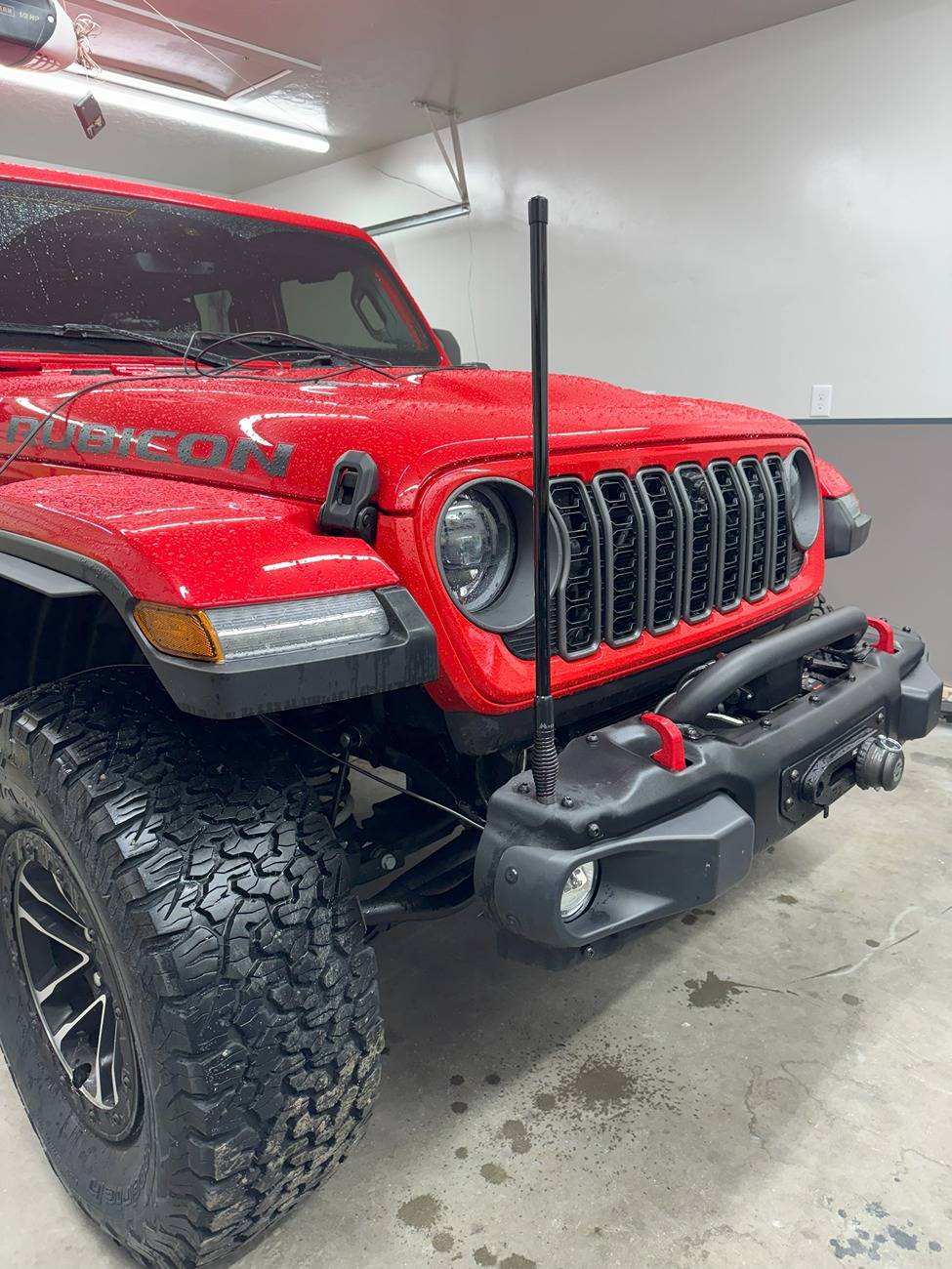

I just did this swap.
Steel Bumper and hardware
Steel Skid and hardware
Skid mounting brackets and nutcerts to install in frame
Winch Plate if installing winch
Fairlead if installing winch
I went with Maximus3 metal closeout panels to fill the big gaps between the bumper and grille instead of cutting the flimsy stock plastic one
Foglight 2 bolt adapter brackets, Oracle has a nice set, I bought cheap ones on Amazon and then had to spend $20 to get the correct hardware for them, Oracle would have been the better choice.
Mine was a factory winch bumper that came with a winch, so it has the longer crush can covers on it. I'm going to look for some shorter ones and swap them out. I also installed the Maximus3 flag mount on the passenger side for when I go to the sand dunes.
I believe that was everything.

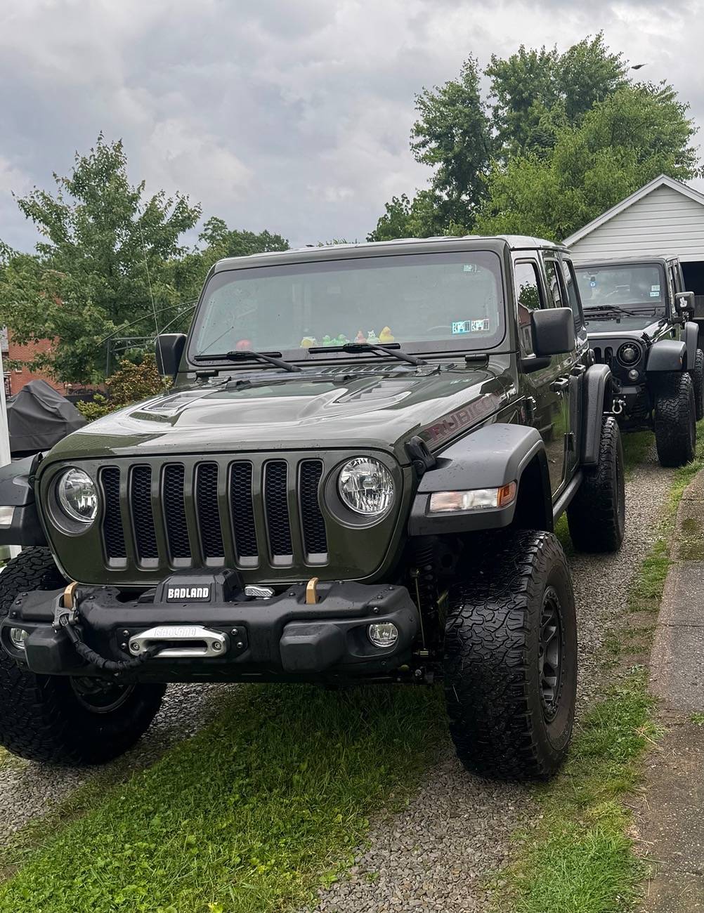

Shop Facebook marketplace, I picked up a oem bumper with end caps, winch plate, fairlead, and winch for 650. I had to drive a couple hours to get it but well worth the drive.
Wow that was a deal! I've been looking for a couple months and just the full width bumper that came off of a Moab edition for $750. Congrats.
Did you have any issues with the Badlands winch install? I have one that's been sitting in my storage unit til I found the bumper. Now I just need the winch plate and skid. Figure I'd install it all at once instead of having to take things on and off.
