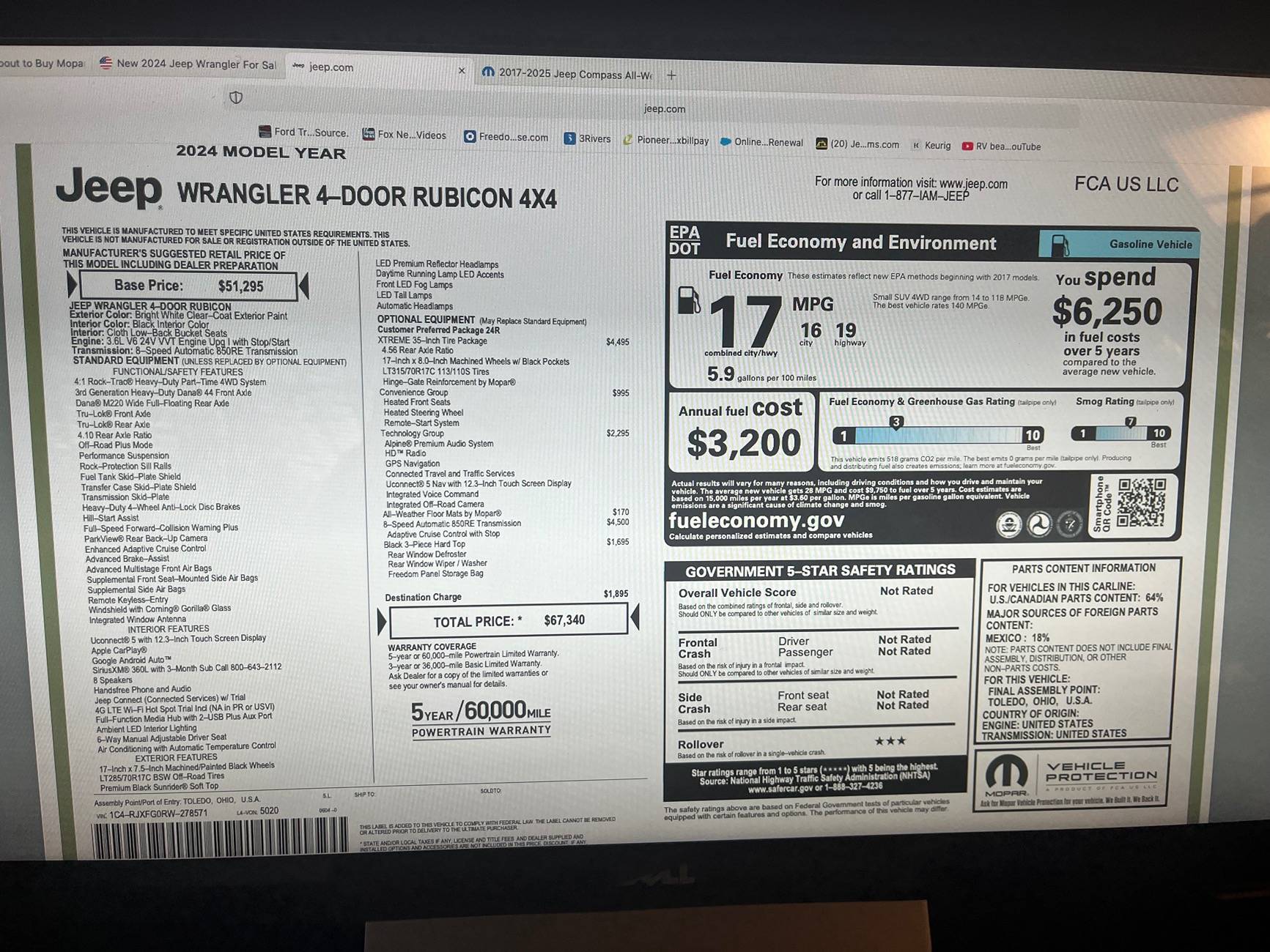

I'm curious why your 24 Rubicon XR did not come with a steel front bumper... Mine did. That is part of the XR package. Do you have your window sticker? If it shows it and the Jeep did not come with it I would be back at my dealer asking for it to be replaced with what it was supposed to come with...
Jeep Wrangler JL Mopar Steel Front Bumper Help 20250202_171807093_iOS
Pretty sure it didn’t, If you have leather package and the painted hardtop and fenders they come with the steel bumpers. I paid 54,000 for a 67,000 dollar jeep. I will buy a bumper 😉

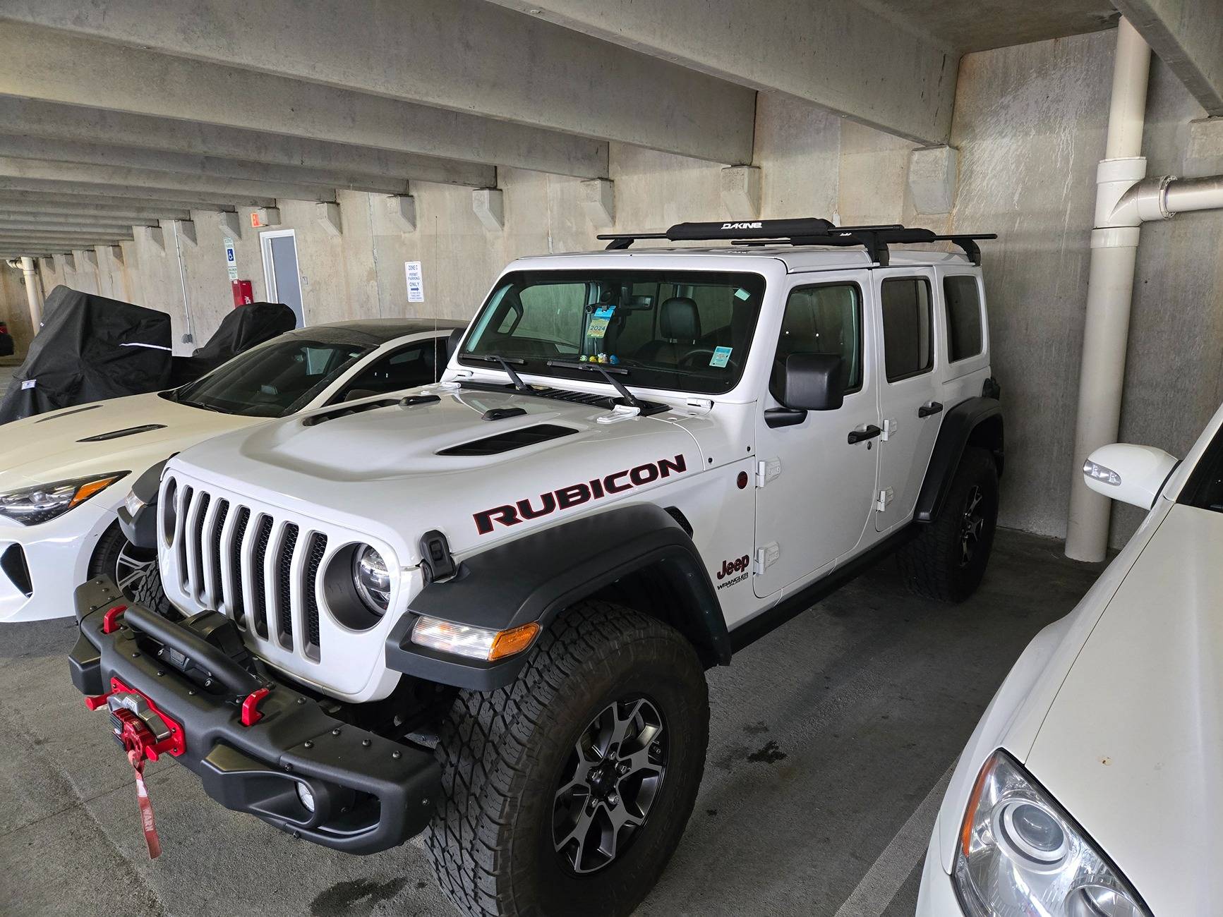

I had purchased the Mopar Steel Bumper and Jeep Warn Winch package from my dealer last year to install on my 2018 JLUR. I just traded the 2018 in for a new 2025 JLUR XTreme package and had the dealer swap my steel bumper over to the new Jeep. Apparently the fog light plugs are different. The dealer ran into this issue during the install. I'm not sure what they did or if they did anything. They claimed they completed the install. When I picked up the Jeep the fogs didn't work. I had an appointment tomorrow for them to fix the fogs but they called late today to reschedule. So I'm going to try and do some trouble shooting myself.
Anyone here have suggestions I might miss...

23 and earlier have a 4 pin connector and the 24 and up have a 12 pin connector...you can pull the pins from 4pin and install them in the 12 pin....look on the passenger side and see if the connector is connected....the first photo is the 12 pin and the second is the harness from pre 24's..
