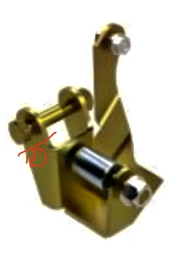

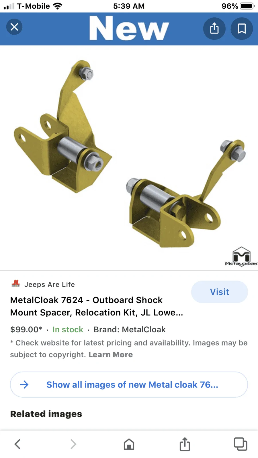

??? More like I know my limits of trying to explain things and know when to leave certain things up to an engineer to explain. LOL
Hi Jon, can you clear this up for me, I was looking for these.......are they a real thing ?
Jeep Wrangler JL Metalcloak 2.5 Gamechanger 6E4BE584-020B-4069-8F25-4B28BB3D3B46
But they seem to have the same part number as the brackets that lift and outboard. I messaged MC but haven’t heard back. Thanks.

@Roky Jon to confirm, but I bet that photo is an older revision of that part number.
As @morlan52 mentioned it is an older revision in that photo. We make changes over time as we see needed to parts, but continue to use the same part number. If you ordered those from them I would imagine you would get our most current ones.
Ok, so do these exist ? I would imagine they still sell the relo brackets that raise the shock for the six packs, as they benefit from being raised. Im running a long travel shock with a shorter spring so I can afford the 1-1/2” of less up travel. But I would like to orient the eyelet the other way.
We do not unfortunately have this style mount any longer. Us making the bracket sit a little higher let our Rocksport shocks get more droop and took away up travel most were not even using due to larger tires and overall length of the shocks.
The Outboard mounts do work great with other shocks as the bushing size everyone uses is pretty universal, but they are designed around the length of one shock so unfortunately it can be a little more tricky to use with other shocks for sure.
