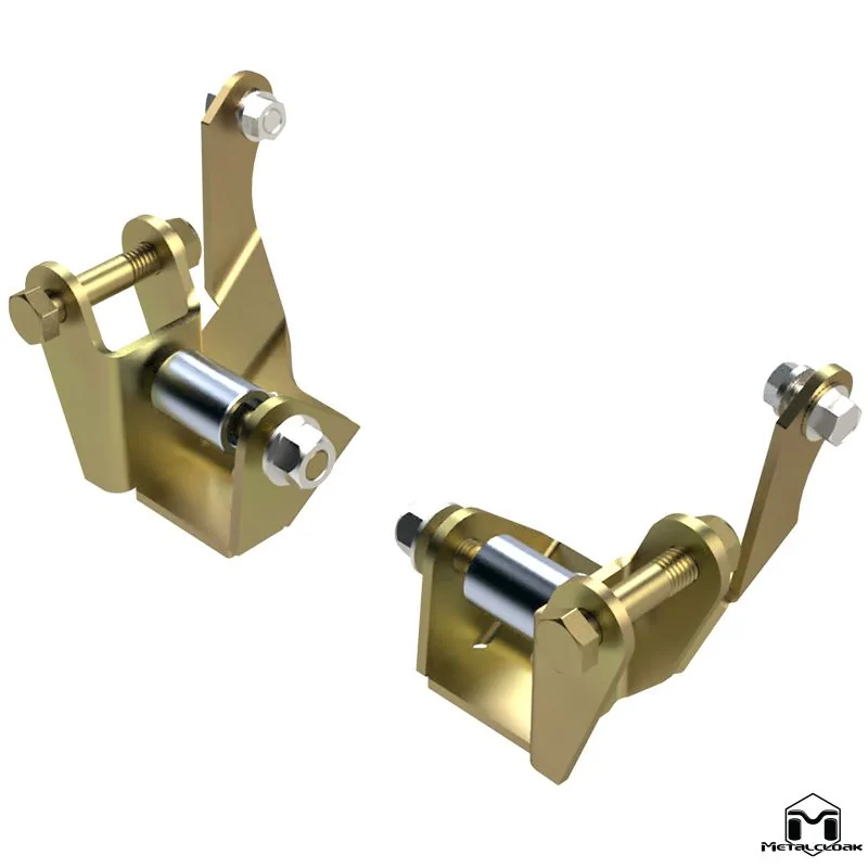

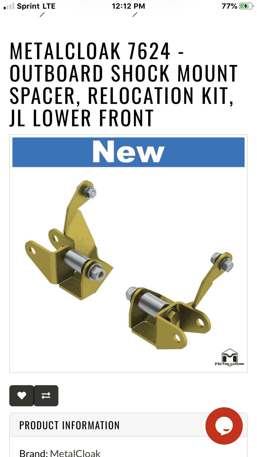

I just installed the 3.5 Gamechanger with Rocksport shocks. I have 4.75" backspacing on my wheels and I am not incurring any rubbing. I was told if you have a Rubicon their axles are slightly wider and therefore a slightly higher backspacing will be okay. Anything more than 4.75" I cannot comment on.
This is correct. With the Rubicon having a slightly wider axle a 4.75" will be just fine. Anymore than that you do risk starting to rub the wheel into the Outboard mounts. My personal JLUR is on 17" Methods with 4.75" backspace running 38s with no rubbing issues. (Profile Pic)
-Jon

Thank you for the confirmation Jon.

I wonder if the up and out or the out but not up relocation brackets could be matched to help the shock travel match the two different spring extension capabilities?
