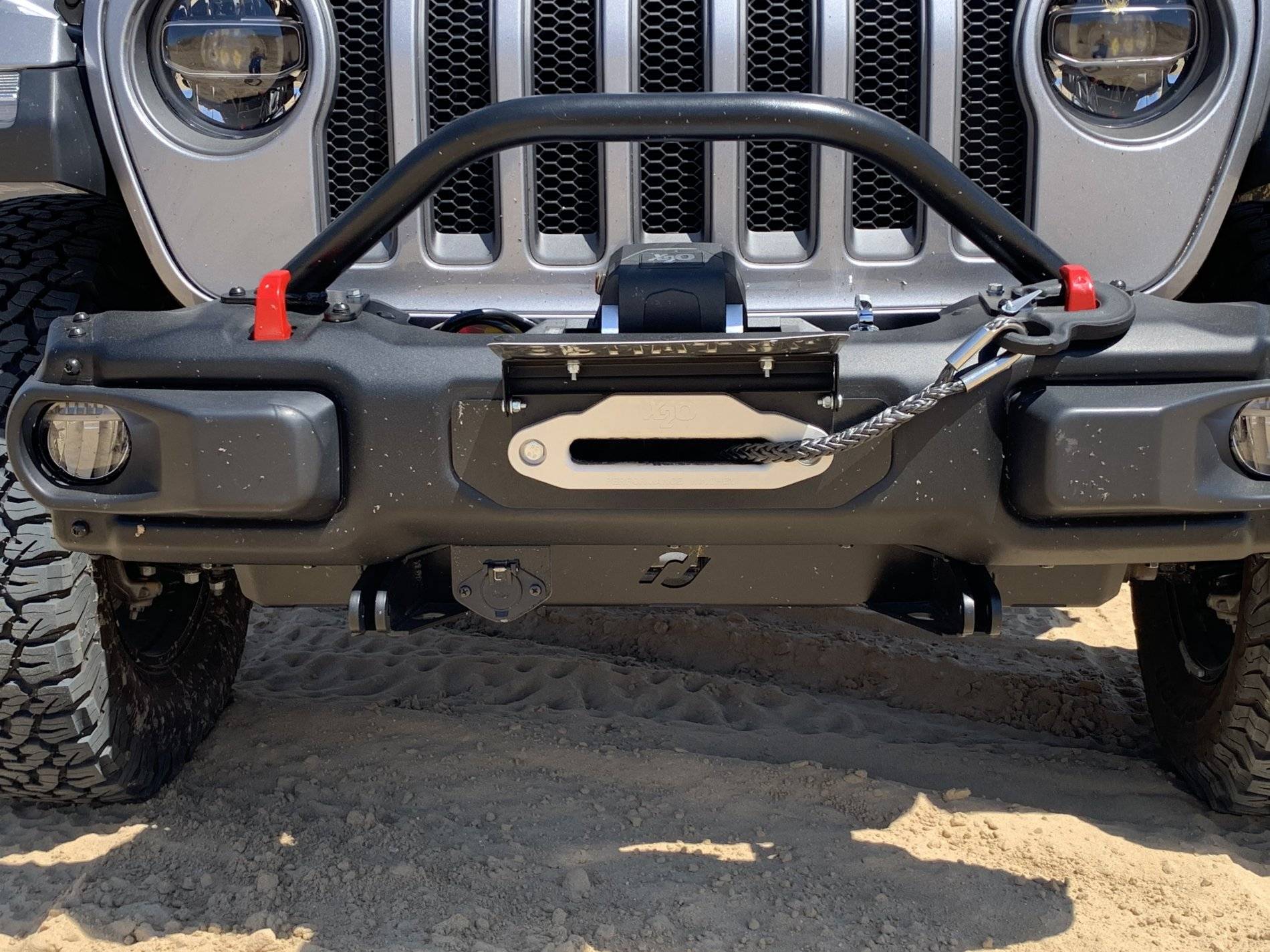

This is such a shame; I really liked the look of the Maximus-3 front tow hoops. Does anyone have any pictures of the Rockjock front towing plate installed?

Thanks for the picture; is there a cutout for the umbilical cord from the tow bar and for a break-away cable?
I don't see a hole for the wiring connector but you can use a hole saw to put one in where you like. A breakaway cable can be easily mounted and there is a place to connect your safety cables.

Nice!!
Thanks; exactly what I wanted to know.
