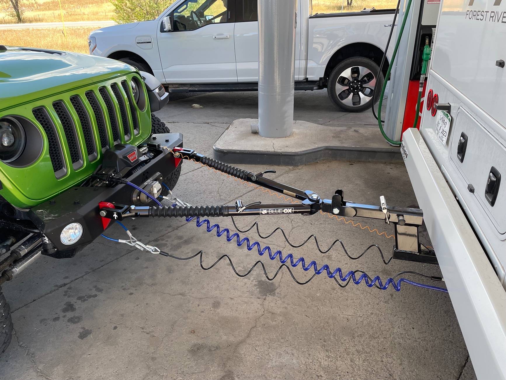

You can mount the plug and breakaway anywhere on the bumper you can use an existing bolt.
Here's a picture of my set up:

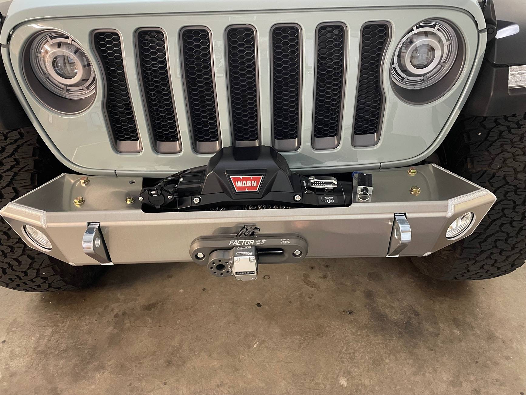

You've led me to additional questions for you. Do you use an RVI brake system?
What bumper is that and do you tow from those loops on the bumper?
What is that you have on the end of your winch cable?

Yes, pricey but...
Yes I use a RVI 3 brake
Bumper is a Next Venture and I do tow from those points, they are a part of the winch tray (all Steel) which bolts directly to the frame. Check them out - good company.
https://nextventuremotorsports.com/.../jl-jt-front-bumper-aluminum-adventure-series
Look at the install videos and you will see how it attaches.
The Aluminum shell is just for bling.
The end of the winch line is Fato 55

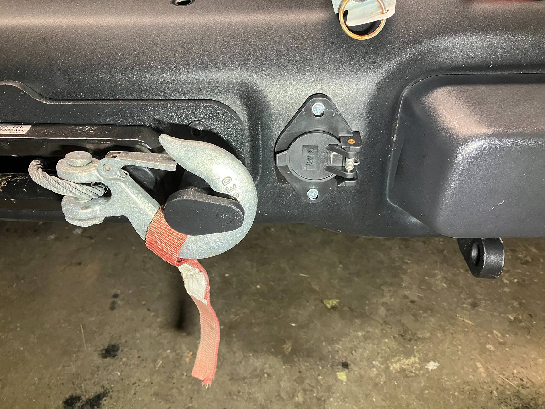

I installed a 6 pin socket on the face of my bumper. From the 6 pin, I ran a wire to charge the battery and some more wires to power a 4 pin plug.
For turn signals and brake lights, I bought magnetic LED brake/turn signals at Harbor Freight. I stick them to my rear bumper and plug the cable into the 4 pin plug on the front socket. If the LED light cable was long enough, I could plug it directly in the rear of my tow vehicle. With possible issues of draining the battery, I thought this was a less complicated option.

This is what the 6 pin socket installation looks, along with the 4 pin plug at the rear of the front bumper. You can see the Maximus 3 tow loop peeking out in the first picture.
