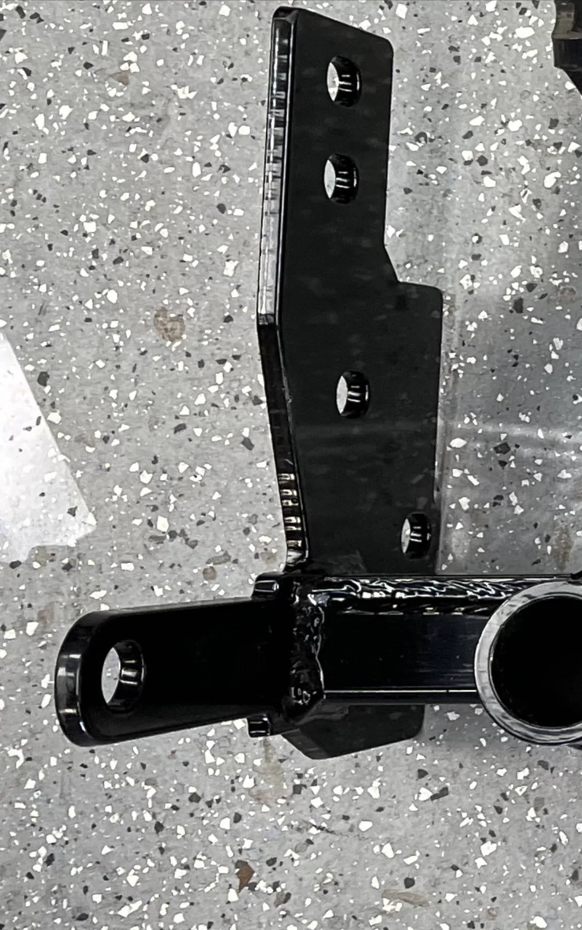

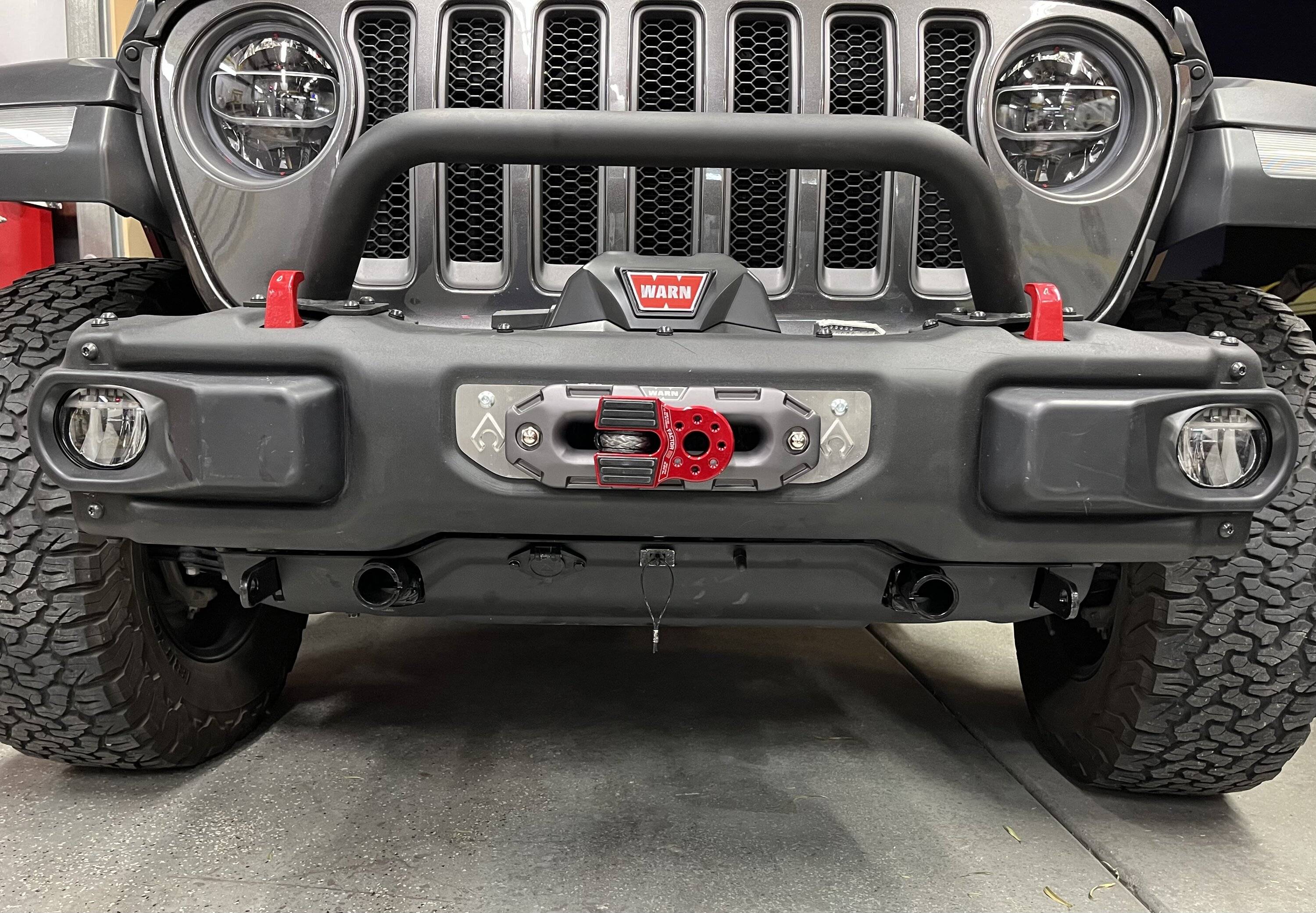

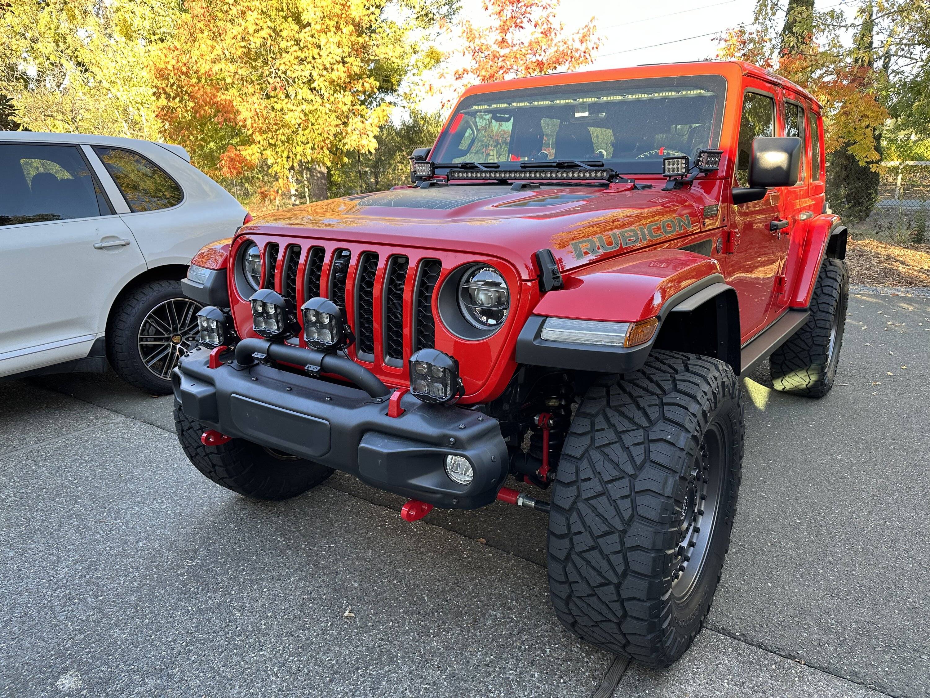

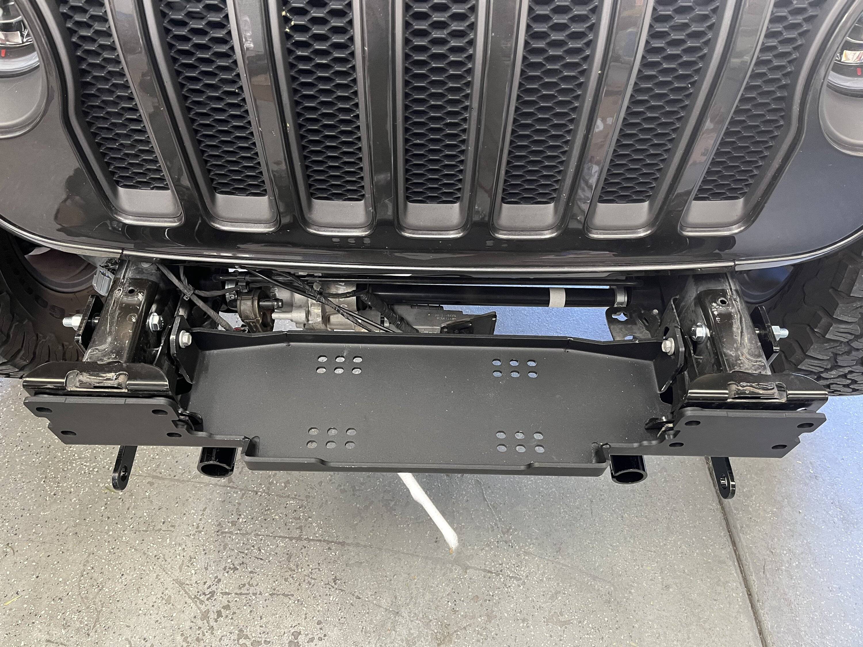

I went with the Roadmaster 521456-5 base plate exactly because of the cost you mentioned after looking into it. The base plate was $430 from eTrailer.
Jeep Wrangler JL Maximus 3 Tow Loops 5D1B94AC-88A4-451E-A322-37F59DF69706
Jeep Wrangler JL Maximus 3 Tow Loops 52CC5F42-516D-4F68-B93C-EB19BBC6345B
Jeep Wrangler JL Maximus 3 Tow Loops 7AF97D56-1217-4F8E-A3A6-33541CFC2D76

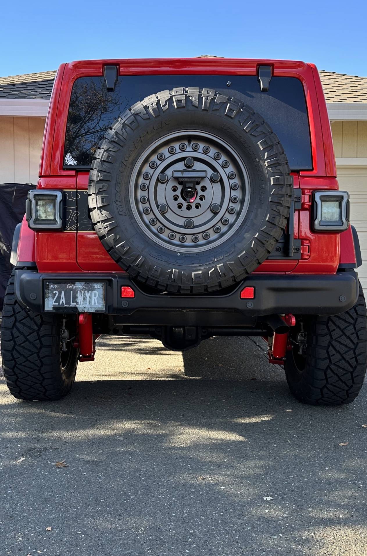

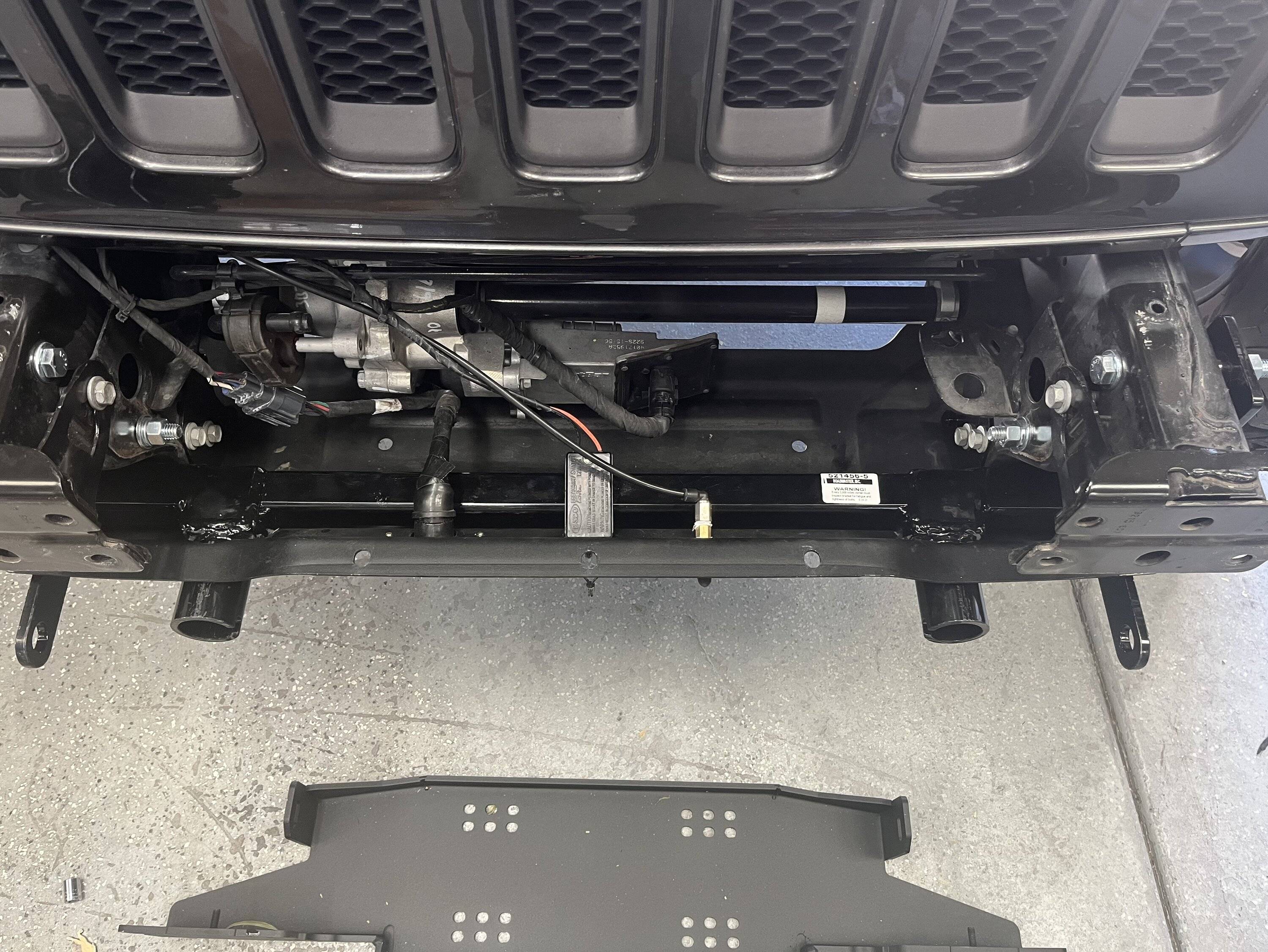

I have the tow loops and never have any intention to ever flat tow, glad they didn’t force me to buy the complete tow package. To be honest I bought it because I like how it looks, at worst, it can be a recovery point. I also installed the rears
Jeep Wrangler JL Maximus 3 Tow Loops 71F84E72-9EFA-4E46-85DC-859E9E7486FA
Jeep Wrangler JL Maximus 3 Tow Loops CE6E5AC1-164C-4A2F-A28F-1A1B6E9A4536

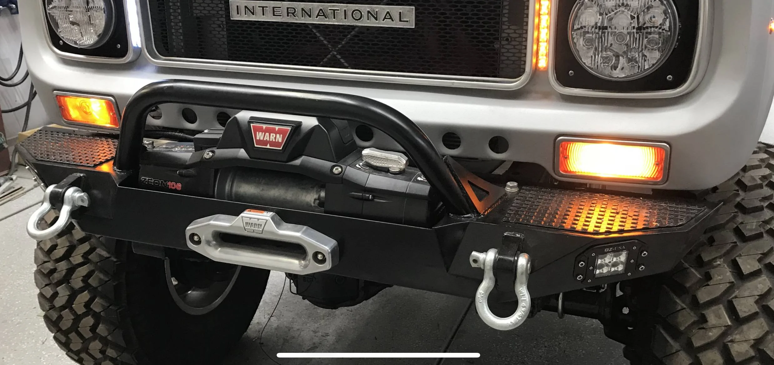

I don’t but guess they could be used in a pinch. The length and 1/4” thickness would probably bend if pulled at even a slight angle.
Jeep Wrangler JL Maximus 3 Tow Loops DB028855-ED73-47C1-8961-1A8BA8E1C7BD
My opinion is that anything less than 1” thick and well tied into the bumper (welded) is not adequate for recovery.
Jeep Wrangler JL Maximus 3 Tow Loops FCAC493E-C8F1-48D1-9B7E-F0A23FA6DD5F
I’m relying on the winch for any recovery. ?
Understand that the Roadmaster you installed is several generations as Roadmaster has in recent years casued damage to the supporting frame structure of the Wranglers similar to M#. In addition the Roadmaster baseplate is seveeal parts welded together, whereas as more often thatn not base plate failures as well as Bumper towing failures are casued from over stressed welds that fail over time. I am not saying tgat the Roadmaster baseplate you used is a problem however due to its welded components it does wequire more rigorous instection and un fortinately somew of those welds are concealed by the bumper requiring periodic bumper removal to inspoect those welds.
This is why I decided against the Roadmaster and stuck with Maximus whereas the solid 3/4" steel tow loop there are no welds to fail since theat 3/4" plate is through bolted to the side of the main frame.
Look I originally had a Blue Ox base plate that broke a weld, I was fortunate to catch it in time. Welds seem to be the weak link of any tow system.
Also not that the Roadmaster baseplate prevents mounting of recessed winches which is how most winch plates mount. The Maximus 3 has no winch interferance.

Let me add to @Twojayhawks observations. The reason maximus added the tie rod is to reduce the lateral forces that were casuing the loops to bend and crack the frame horns. It should be noted that the Roadmaster base plate has also had an issue with cracking frame horns. Just becuase Roadmaster is NOT selling a Tie rod with thier base plate does not mean thier base plate should not use one. In Fact what Roadmaster does is they have a Tie rod option for thier Tow bars instead of with thier base plate. So technically that cost is there for both Maximus and Roadmaster and it is optional with both. The Tie rod is not a base plate component it is a Tow bar component. Maximus since they accomodate all tow bars they offer the Tie Rod option. So if you are using the Roadnmaster towbar and you also have the optional tie rod/plate with say the nighthawk then you do not need to the Maximus Tie rod. The cost is all relevent.
By the way of you are running Blue Ox you would need adapters for the Roadmaster also.
The real comparison cost is the base plate and frame tie in which is equivalenmt to Roadmaster and Curt/Blue Ox you should need adapters and should use Tie Rod for all of them.

Note: the maximus 3 loops are not a good recovery point without the frame tie in. Without the frame tie in they only bolt to the very thin frame horn and easily break with any lateral forces.
What data do you have to prove that statement? I have yet to hear of one of these shearing off? Most D ring mounts I see people using for recovery are not bolted or welded all the way through the bumper and people are using them every day. It would take one hell of a pull to do anything other than bend these.
First off I am referring to the Tow loops without the frame tie in (even then lateral pulls you run the risk of bending the tow loop)... Second both frame horns on my wrangler are cracked from the pre-frame tie in towing, so personal experience also supports that . I also had the bent tow loops. The tow loops without the Tie rod are NOT designed for any lateral forces and recovery often requires lateral pulls.
You realize that Jeep does not warranty any equipment failures from recovery events, they provide NO guaranty of thier recovery hooks or mounting. There are limits. Just watch Matts Offroad on Youtube to see factory recovery hooks fail or become damaged. By the way all newer cars are required to have factory front recovery point/connections the Wrangler just happen to be visible hooks. Using factory recoivery pooints does not mean the vehicle will not be damaged wehn using them.
This is incorrect - Roadmaster base plate, recessed Aztec winch mount and Zeon 10s winch.
Roadmaster sells two styles of base plates - direct connect and crossbar style. The 521456-5 base plate I installed is a direct connect and a crossbar is not required.
Now if it was this style of Roadmaster I would definitely use a crossbar.
Jeep Wrangler JL Maximus 3 Tow Loops 34C59AA2-5355-496D-91FC-77AA3FDB50BA
I just upgrade from a plastic bumper to the OEM bumper and had to replace the old Roadmaster base plate. The old baseplate is three years old and has over 30K miles of towing on it. Looks brand new, no damage to Jeep and no crossbar required.
Jeep Wrangler JL Maximus 3 Tow Loops FE1525F8-B543-451B-B914-33753FCE8B1F
I do agree that the Jeep has very thin frame horns and anything bolted to this area for towing or recover should be inspected frequently.
I too am not trying to persuade anyone either way. Just sharing what I did when I looked at cost and what I felt was the safest way to tow the Jeep along with adding a winch to it.
