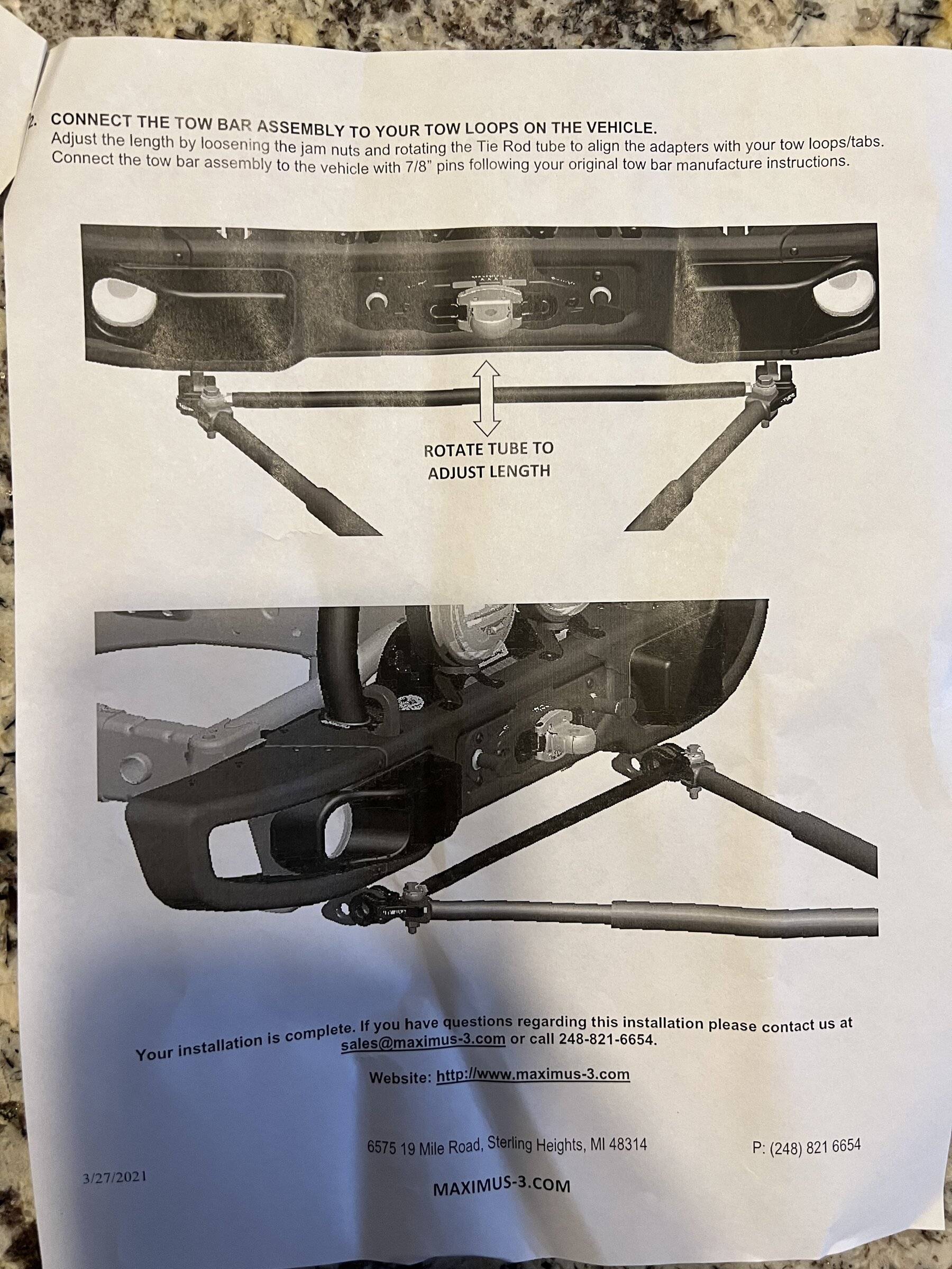

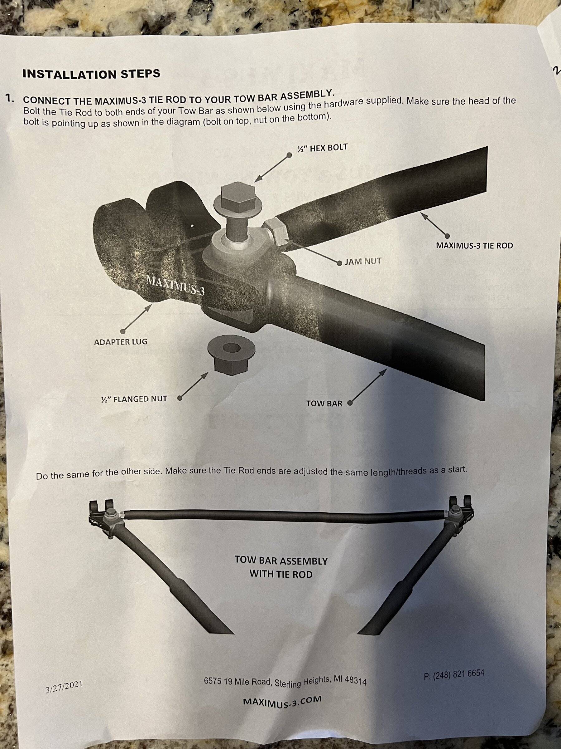

I have not flat towed yet with the Maximus system, but here are the instructions included with the strut bar. I just finished wiring up the cooltech/stay and play brakes/and rvi charger yesterday and am hesitant to try it out given the issues noted here.

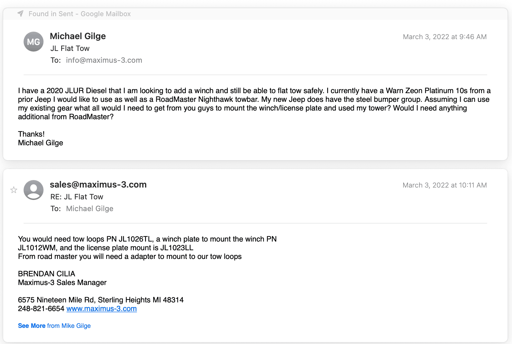

I just recently purchased these myself to replace Roadmaster brackets that did not allow for the installation of a winch. Not only does the info not state you need this added bar I emailed Maximus and asked them what I needed to FLAT TOW my Jeep and here is my email and their response. Extremely pissed as I just spent the weekend installing these + a winch.
I have a RoadMaster Tow Bar, doesn't look like that's going to work for me.
