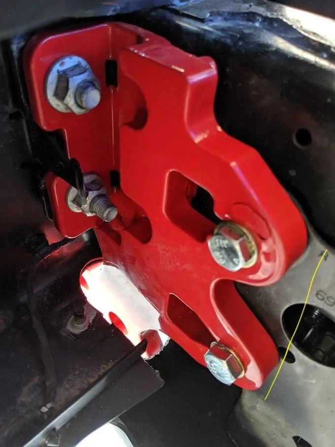

I purchased the Maximus 3 tow hooks for flat towing my JLUR. I have towed it over 10k miles since setup in 2020.
I saw on another forum where a user that was also flat towing with these had developed a crack in the frame, shown here:
He then removed the bumper to address the problem, and this is what he found hidden behind:
I immediately had @rustyshakelford look at mine, and I have a much worse crack showing on both sides.
It is going to be a lot of work to tear mine down, as I have a warn winch installed as well.
This product is very dangerous, and not engineered for towing. There are several users that are in communication that all have the same issue. I am filing an NHTSA report once I get all of the pictures in an effort to ensure everyone's safety.
All tow base plates for the jeep have provisions to tie the force of each side together. A hard pull on the driver side would in turn pull the passenger side towards driver, and vice versa.
Maximus 3 is not designed that way. They are attached to the frame ends independently of each other. What's worse, they do not clamp around the frame end on each side, but rather use a very small bolt and washer as a pass thru.
DO not flat tow with a Maximus 3 tow system. This product is dangerous.

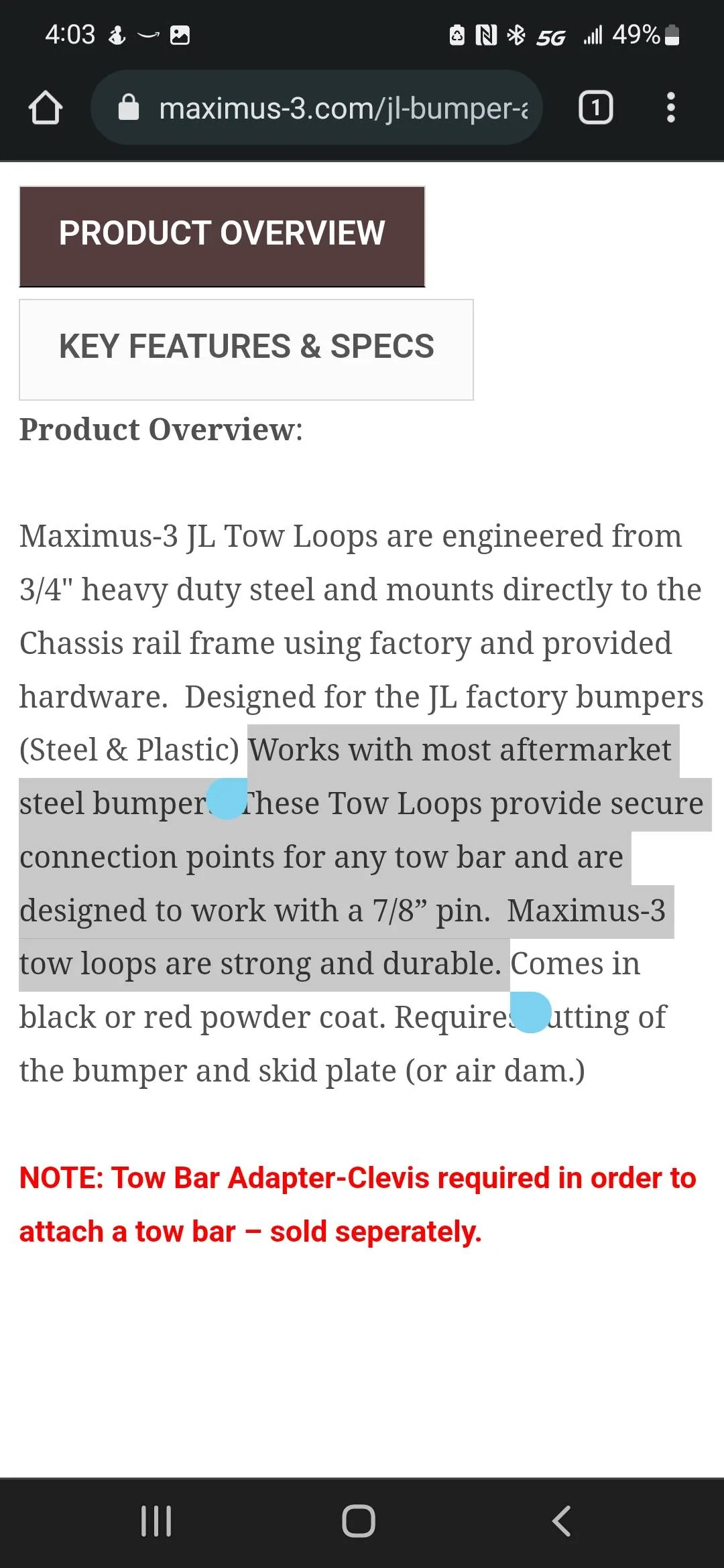

Maximus Folks,
With all due respect, on your website where the Tow Loops are listed, there’s no recommendation in the Product Overview to add a Towing Tie Rod to an order for the Tow Loops if you plan to flat tow. The only notation you have is to include the Adapter-Clevis to attach a tow bar, which is rather obvious. Saying as you do above that some customers opt out of this option is a bit disingenuous to those of us who were never made aware of this to begin with.
Copied/pasted from the Tow Loop product description:
Maximus-3 JL Tow Loops are engineered from 3/4" heavy duty steel and mounts directly to the Chassis rail frame using factory and provided hardware. Designed for the JL factory bumpers (Steel & Plastic) Works with most aftermarket steel bumpers. These Tow Loops provide secure connection points for any tow bar and are designed to work with a 7/8” pin. Maximus-3 tow loops are strong and durable. Comes in black or red powder coat. Requires cutting of the bumper and skid plate (or air dam.)
NOTE: Tow Bar Adapter-Clevis required in order to attach a tow bar – sold seperately.
I just went to the link you posted above and sure enough, looks like the towing tie rod is available as a package for folks who don’t use a Blue Ox tow bar, sadly there does not appear to be a way to order the tie rod separately for non-Blue Ox customers such as myself (that have already ordered the Tow Loops).
And getting back to the original issue of Jeep frames cracking and tearing when your tow loops are used, how exactly does the Towing Tie Rod solve the problem? In the one photo you have on the website it’s not clear what it attaches to or how it’s installed.
Thank You,
Your Tow Loop Customers

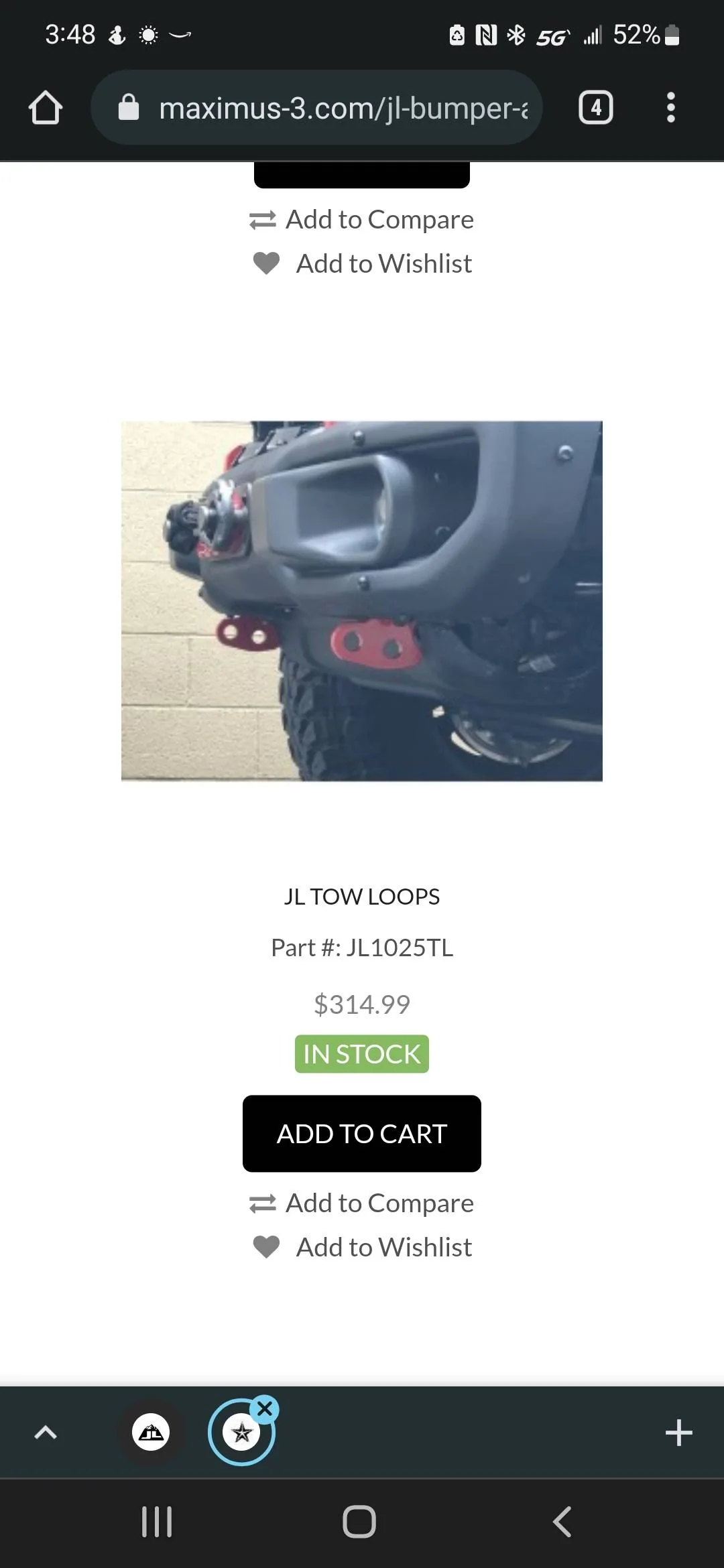

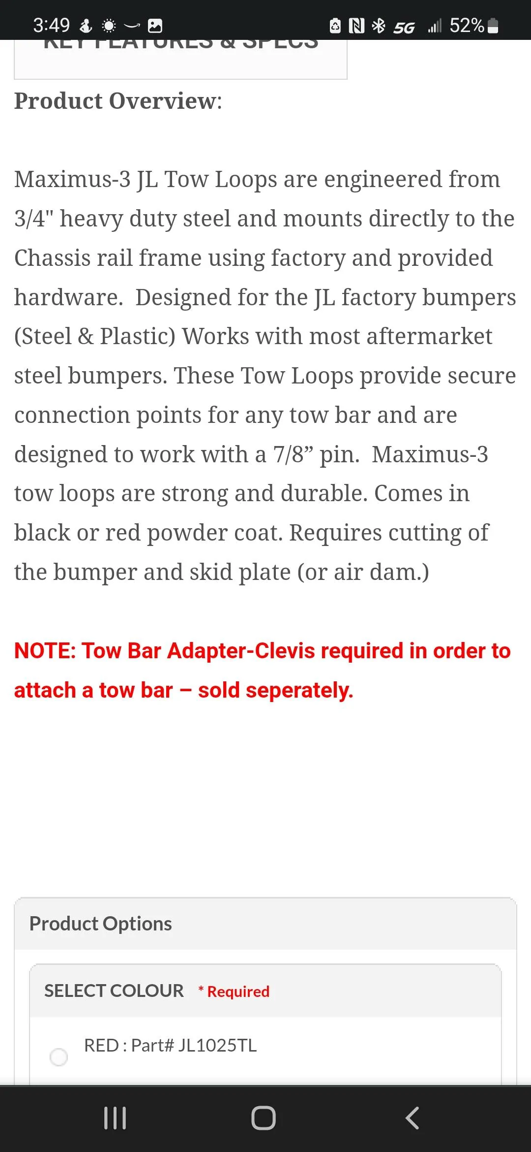

As I stated earlier, I purchased in early 2020, and was never offered anything other than the tow loops.
I own a Wrangler JL. I used the links on maximus 3.com website to make my purchase. Today the links have the same information as they did before, with no suggestion that another product was required.
The link provided above is not for my vehicle and was not on the product page I looked at just now. Posting here for all to see.
Jeep Wrangler JL Maximus 3 Tow Loops Screenshot_20220401-154821_Chrom
Jeep Wrangler JL Maximus 3 Tow Loops Screenshot_20220401-154913_Chrom

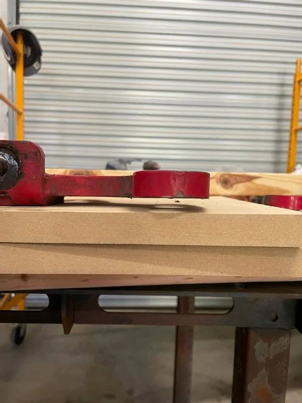

They clearly say these are strong and durable, designed for towing.
Jeep Wrangler JL Maximus 3 Tow Loops Screenshot_20220401-160400_Chrom
Here is how strong and durable these are when only being used for towing forward, never in reverse.
Jeep Wrangler JL Maximus 3 Tow Loops IMG_1138
Jeep Wrangler JL Maximus 3 Tow Loops IMG_1137
