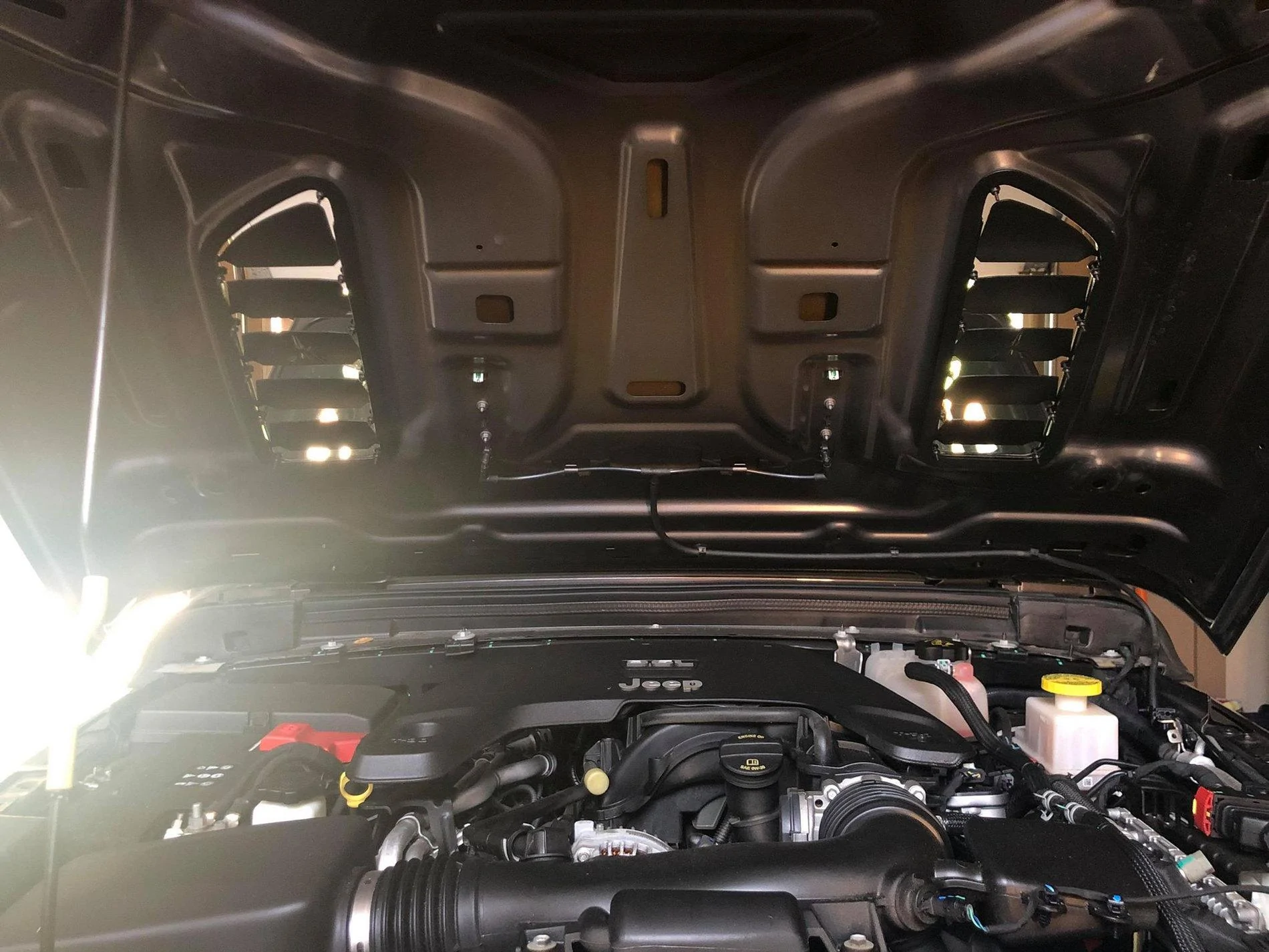

I like these but I'm not seeing any photos of the underside of the hood with these installed. I'm not a fan of water just dumping on the motor. I emailed them for more info.
Yeah, as far as I can tell it’s wide open underneath... they look cool but kind of pricey in my opinion
AnnDee4444
Jan 14, 2019
54
5,529
7,948
'18 JLR 2.0
Update: this is a very incomplete idea IMO. I asked about water control. They said, replacing hood liner was an option. LOL you'd lose the air flow. Or said as another option, I could make a panel to cover the battery area, but they had no issues and been making hood louvers for years, haha right.
