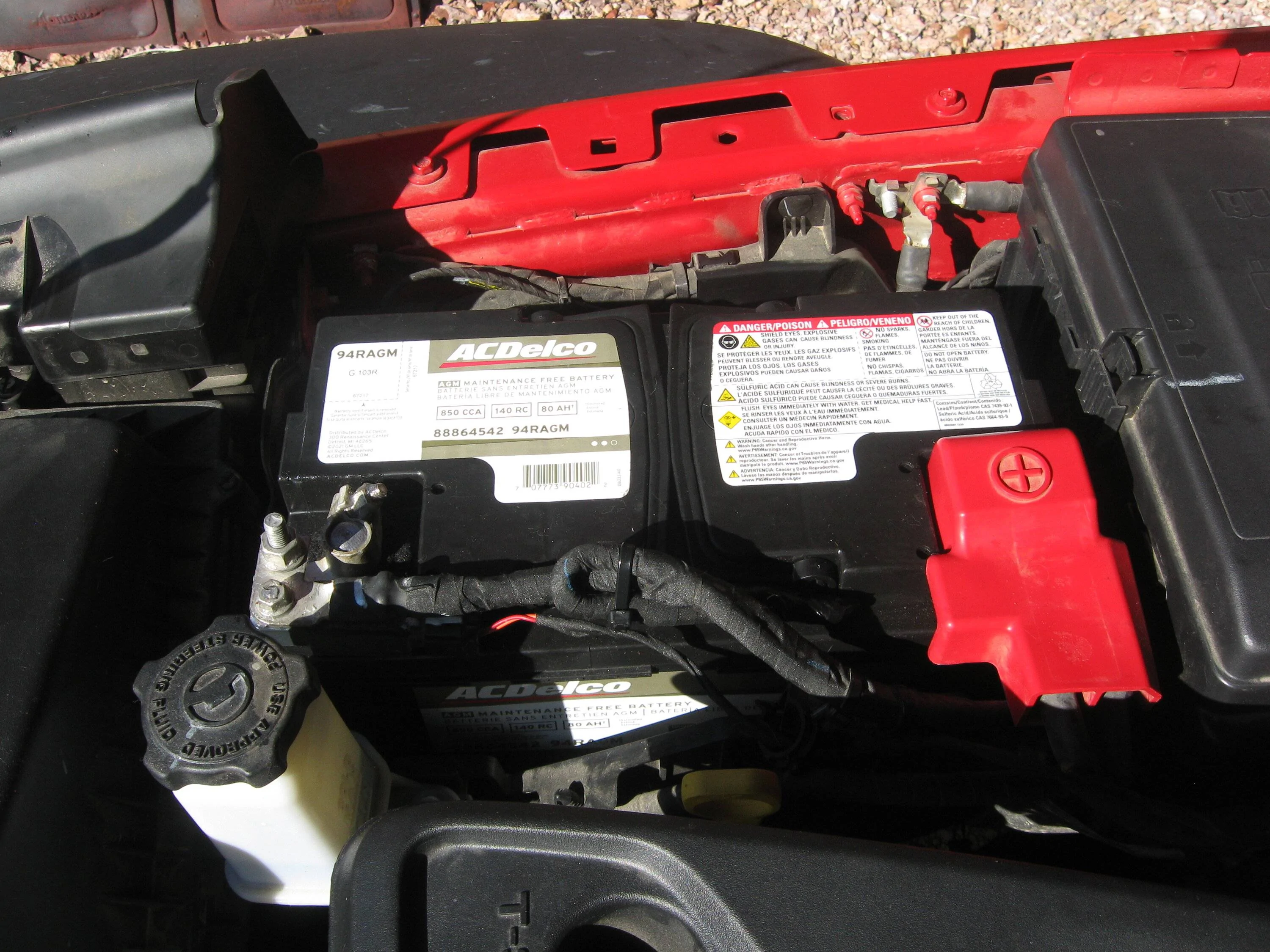

You can add the AC Delco 94RAGM to the list. 850 CCA, 140 RC, 52 lbs... a vastly superior battery to the stock one.
It fits better than the original 650 CCA battery. The plastic clip on the positive terminal actually snapped over the top edge of the Delco battery, you know, like it was supposed to. (It was a loose, sloppy fit on the MOPAR H6 battery.)
The IBS wire was plenty long, but the battery blanket was way too small to fit the bigger battery. In the trash it went.
I ordered it from RockAuto for $159.76, (196.91 after tax & FedEx), and it arrived promptly and very well packed.
