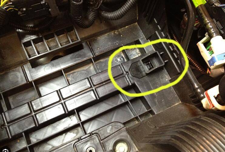

With that said, if you go to install an H7-AGM Group Size 94R battery in a JL or JT that left the factory with a Group 48 H6 battery you will, in order to install the H7, have to remove a small plastic stay/cleat you will find in the bottom of the Main's battery holder box. The stay/cleat comes out very easily.
-->Pic of stay/cleat found in the Main battery box on a JL/JT that leaves the factory with a Group 48 H6 battery:

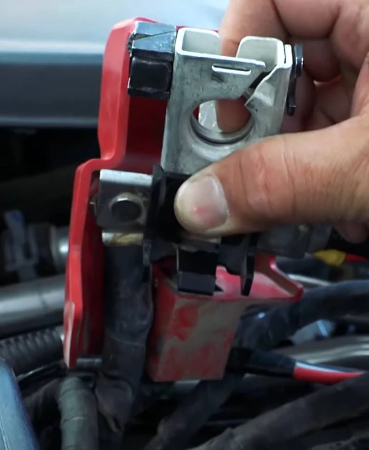

Main Battery:
IF.... if, you do not release this black plastic retaining clip it will break... (see pic)
When you go to replace the Main battery or if for some reason you will be disconnecting the Pos side of the Main battery, do know there is a black plastic retaining clip that needs to be released with a small plastic tab just as you go to pry up the Pos cable connection...
IF you break the black plastic retaining clip, do know that it is not critical to have so don't bother trying to find/buy another... Of course, would be nice if you did not break that retaining clip.
See pic which displays the black plastic clip and the tab (just below the thumb in the pic) you need to push on it before you pry up the pos cable connection...

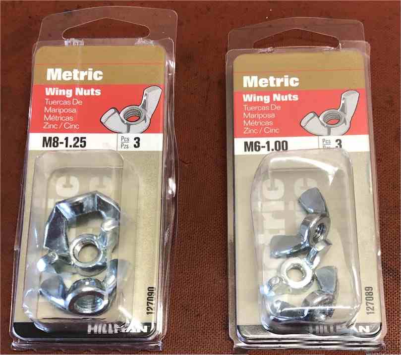

If you want to use Wing Nuts on the Main battery connectors, here are 2 sizes you will need..
Hint: If when turning a wingnut it hits the wing of the wingnut in close proximity to it, file down the wings on one of the win nuts so it allows the wingnut to clear the other.

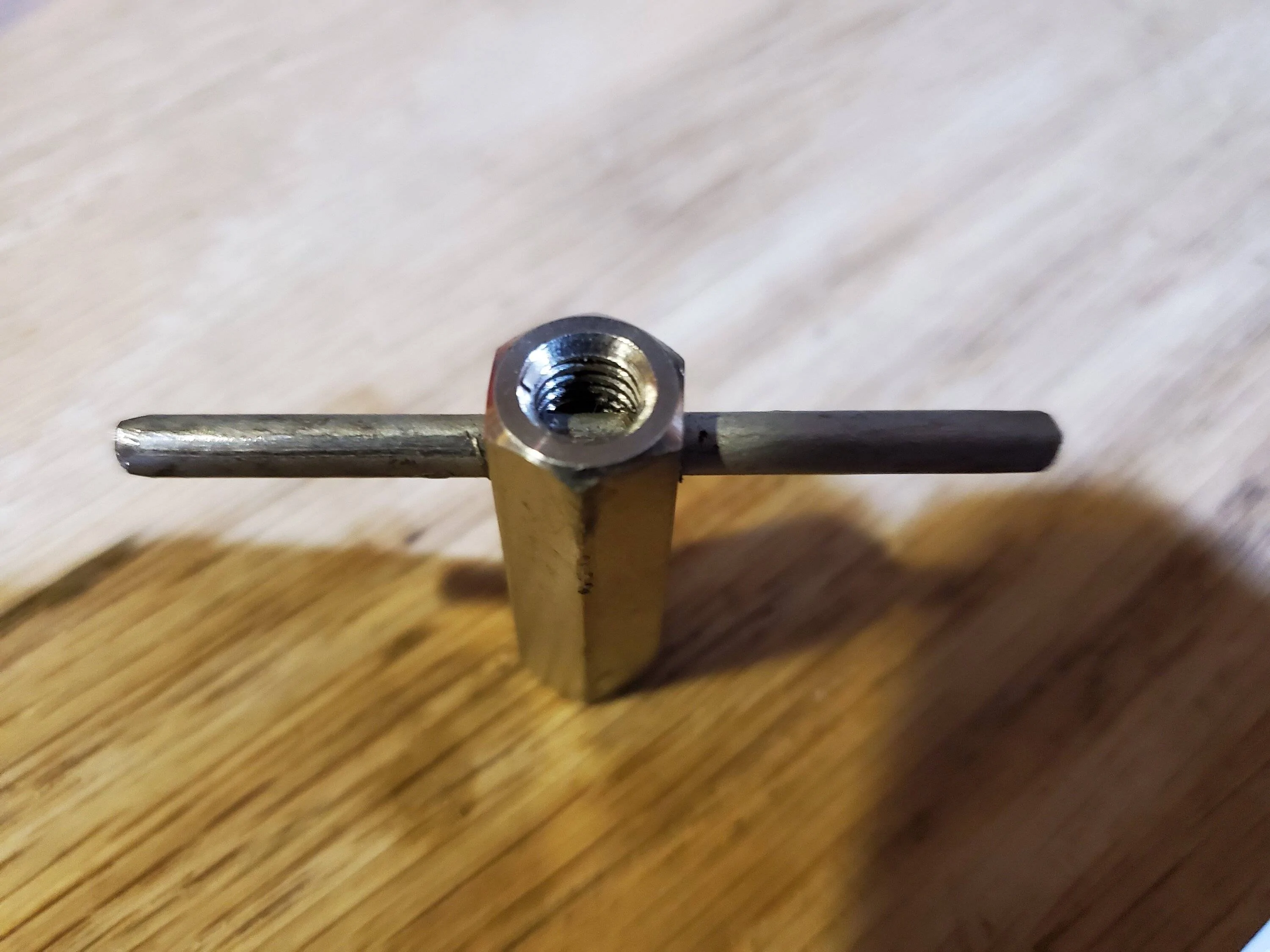

You can make easily up quick disconnects. Take a coupler of the appropriate size and drill hole in it's end and then place an aluminum nail in the hole..
