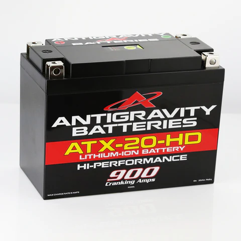

I ran an Antigravity lithium in a '21 Mustang GT for a year (swapped back to standard to trade). It has 900 cranking amps (though not Cold Cranking amps), and had no problems cranking the Coyote's 12:1 compression here in the piedmont of North Carolina. The battery weighs less than 6 pounds. Also, automotive lithium battery's BMS are designed to be mated to standard alternator systems and will be fine being charged by them.
My son has a lithium battery in an adventure bike. He has had to repeatedly bump the starter to warm the battery in order to crank. But, that bike sits for long periods between starts when it's cold. So, a daily driver with lithium should be fine in the cold. A weekender, not so much.
Being in Florida, you should not have a problem with a lithium battery, even with a weekender.
Jeep Wrangler JL LiFePO4 Main Battery Replacement anti 900

It will charge them, but not with the right charging algorithm that a Lithium battery requires.
You can change them with an Antigravity battery. Pretty much all the light weight LiIOn/LIPO batteries have built in controllers/battery management system to properly monitor and charge them. I like the Aintigravity with reserve start (Re-Start) capability.

There are a few drop in LifePo4 batteries. The Dodge boys use them in their 392 equiped monsters to drop some weight. Here is a top dog in the drop in automotive battery segment.
https://antigravitybatteries.com/products/starter-batteries/automotive/ag-24-rs/
