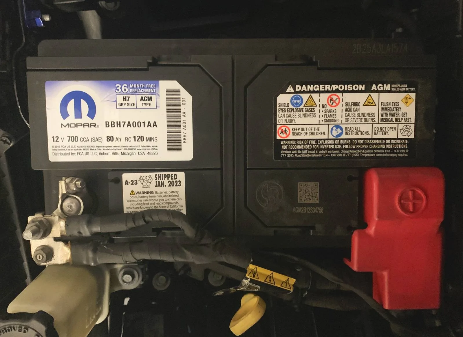

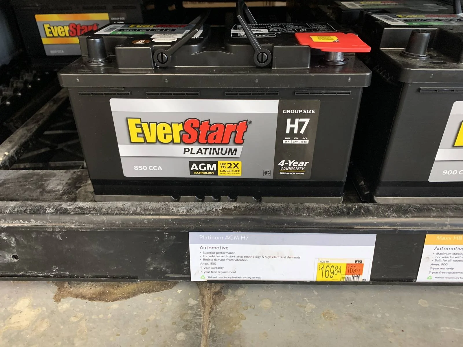

Main Battery replacement:
Interstate MTX-94R/H7 80 Ah AGM 850 CCA
Odyssey Performance AGM94R H7 L4 850 CCA
Super Start Platinum H7 SSB94RPLT 800 CCA
Napa P/N 9894R H7 800 CCA
Batteries+ X2 Power H7 Group 94R SLI94RAGMDP 840 CCA
EverStart Platinum AGM Battery, Group Size 94 H7 850 CCA (Walmart)
Optima YELLOWTOP AGM YEL94R DH7 Group 94 880 CCA
DieHard Platinum AGM Lead Acid Battery, Group H7 850 CCA
Motomaster Eliminator AGM Group Size 94R (H7/L4) 800 CCA
Duracell AGM 94R H7 800 CCA (Sam's Club)
94RAGM ACDelco AGM Group Size 94R H7 850 CCA
FullRiver FT850-94R 850CCA

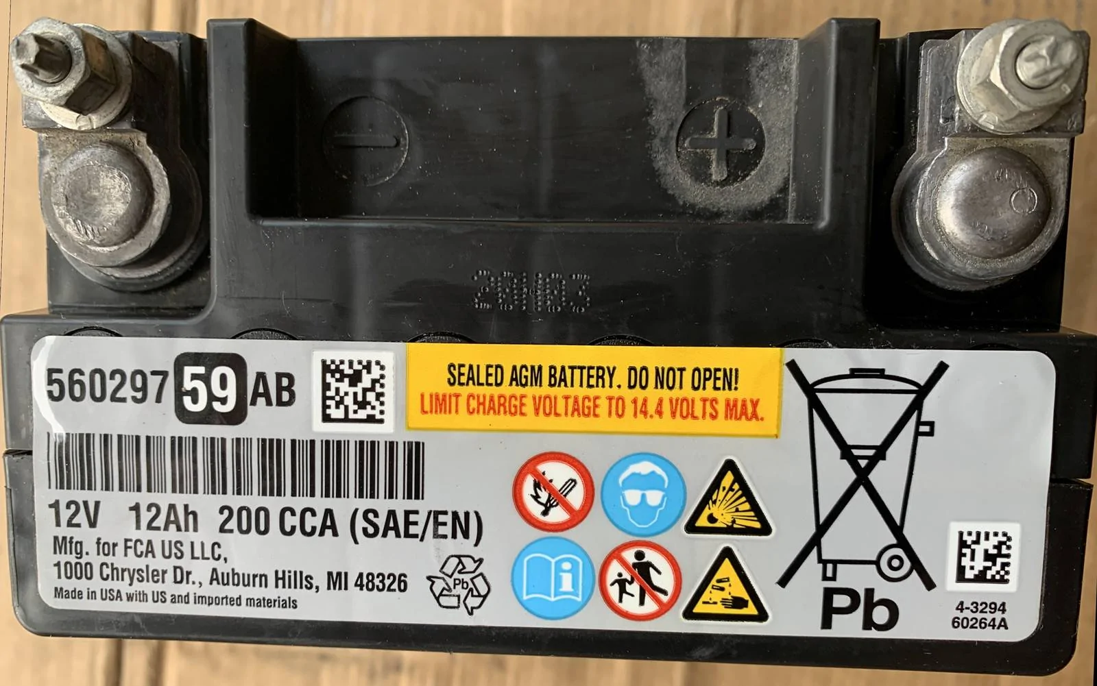

Aux battery replacement:
DieHard Platinum AGM Battery, BCI Group Size 400, 200 CCA Part # AUX14-1
Super Start Platinum Auxiliary Battery Group Size 400 Part #AUX14
ACDelco Professional Gold 88866185 AUX14-200 battery
Interstate MTX-AUX14
Braille (Part# B14115) I5Ah 360CCA - Tests from factory at 483 Crank Amps. Wt. 11.5 lbs.
