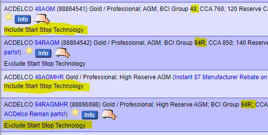

Thanks for the great info, appreciate it all being consolidated in a single thread. Had a question regarding the H7/94R battery. When I went to order it indicates that it is NOT for use with ESS. Anyone know if it is indeed okay to use the 94R battery with the ESS?
@DDESLAU
Disregard that ...
For the Main battery, it does not matter .... Just buy an H7 that is known to fit.... all on the list earlier in this thread will fit.
