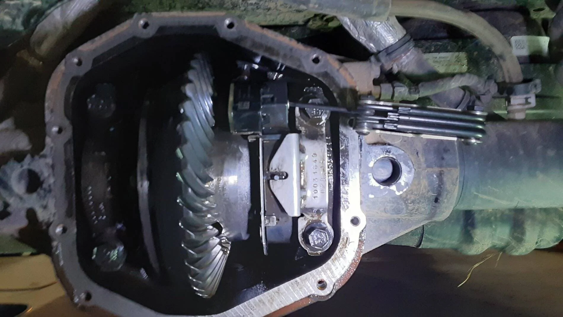

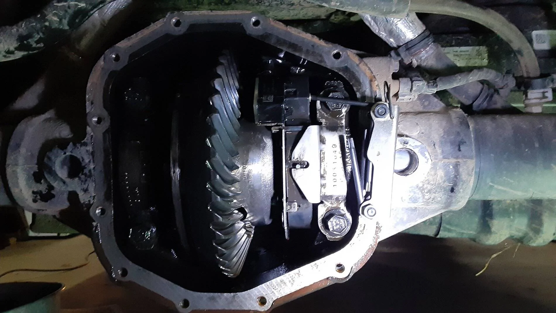

Thanks for the excellent pricedure write-up! Front was almost 1/2 full at 12k miles with no towing. I cheated and used a torx-key set (pics attached) as the shaft is skinny so you don't have to remove the cap bolts.
Only problem I had was a crappy 6-pt Craftsman 10mm socket broke and stripped one of the diff cover bolts. I switched to a thick-walled impact socket after that to break all the cover bolts loose.

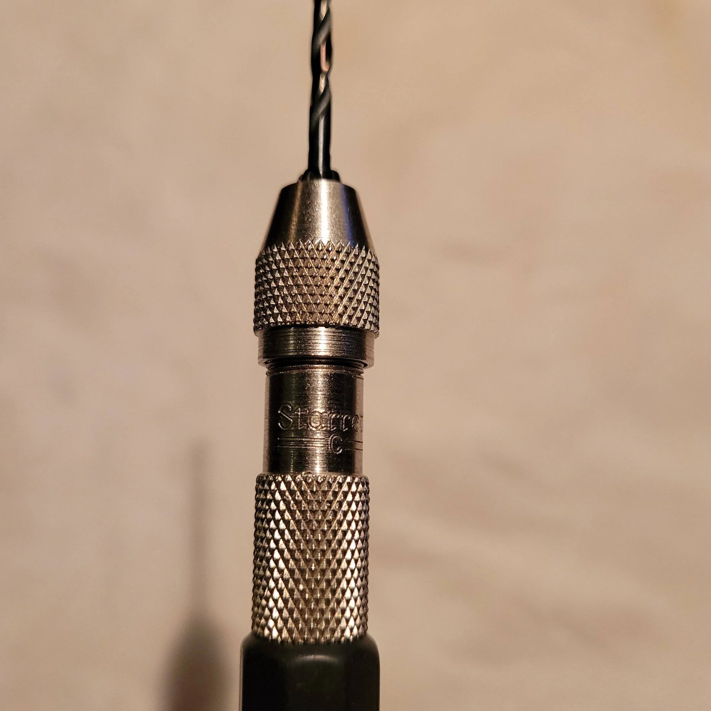

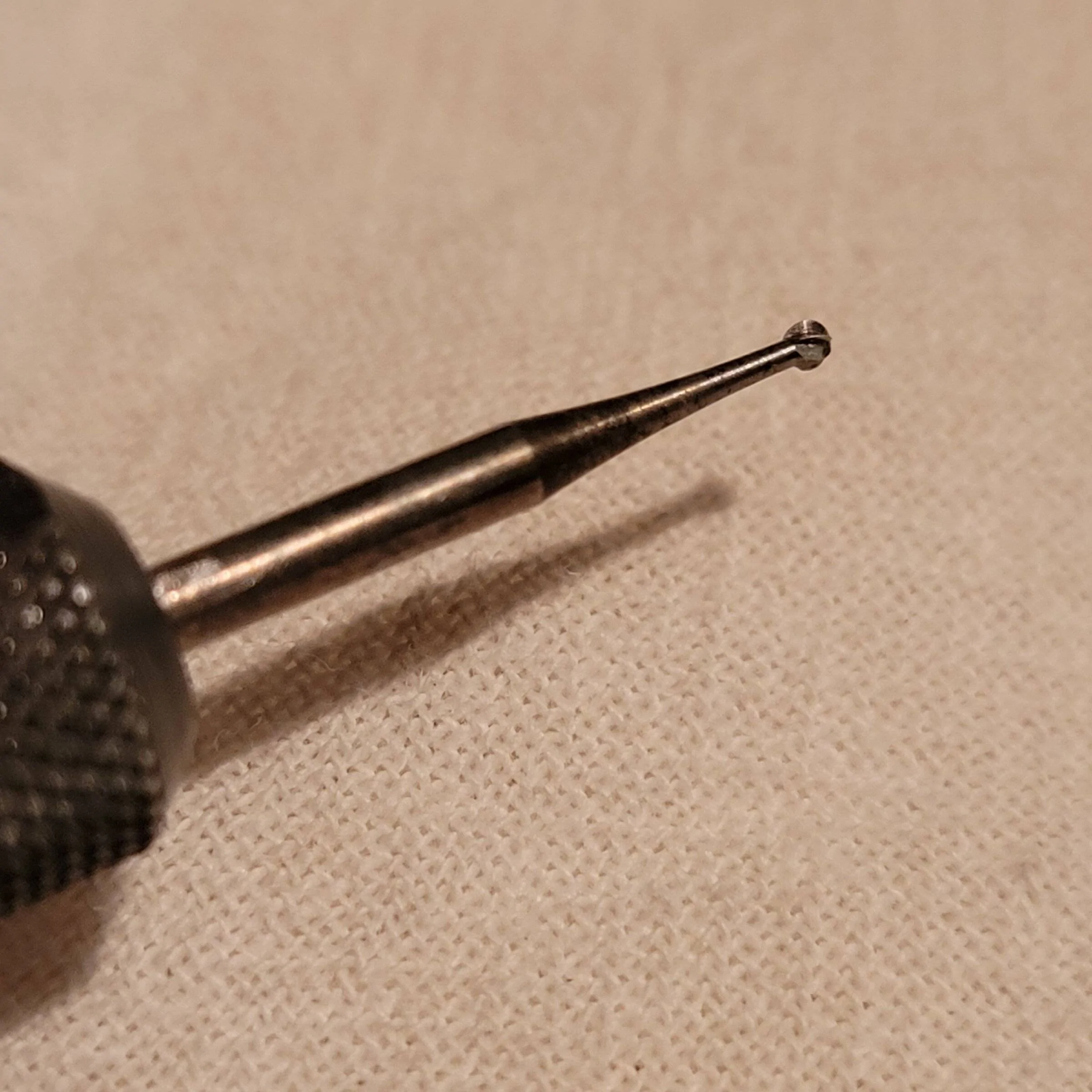

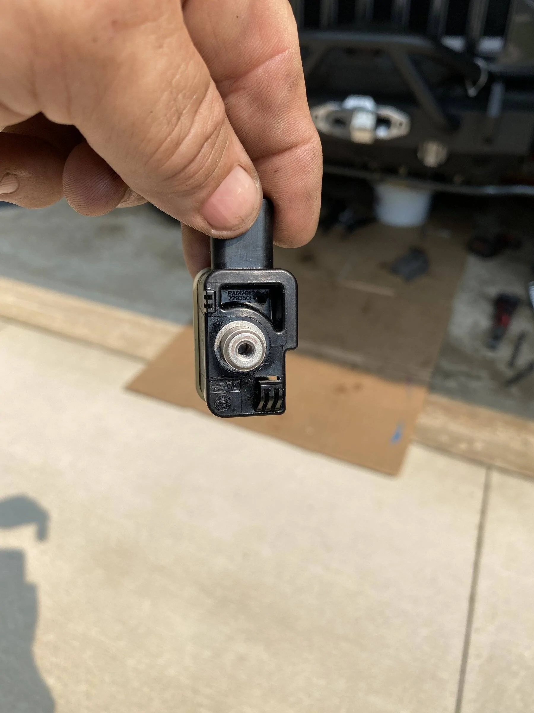

For those of you having a little anxiety about drilling too deep and making contact with the pcb, I was too. I used a small round cutting burr appx 1/32" on my dremel, great control and very little pressure needed to make a starter hole. You can then easily increase the hole with burr (or possibly just buy a 3/32" dremel burr?) but I just happened to have a pen vise to fit a 3/32" drill bit to very easily increase the hole size by hand. Mine is a Starrett and a little pricey, but you can find a chinese one on amazon for less than $10
My truck has 35k mi and both sensors had a fair amount of oil in them, and now they are potted. Happy I ran across this thread by chevymitchell while researching about the gear change I'm currently in the middle of. Would have sucked to get it all back together only to have a sensor issues later on.

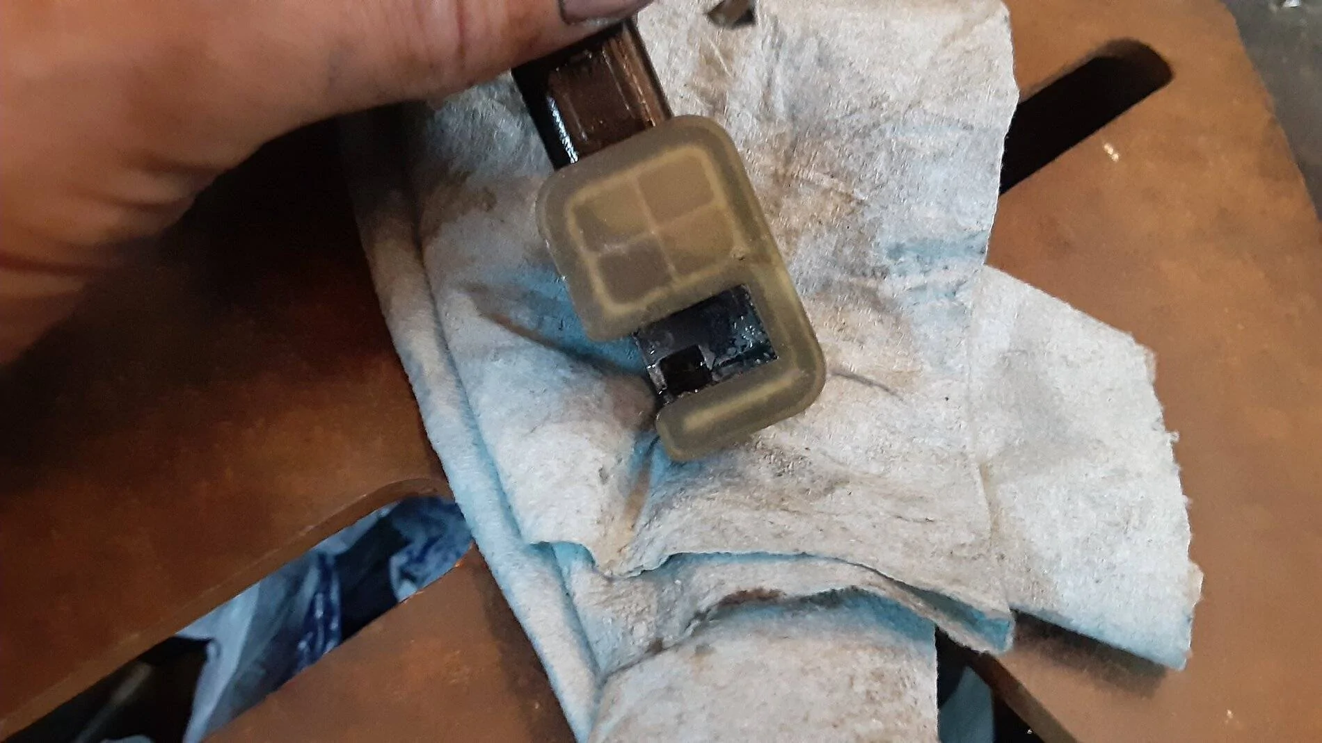

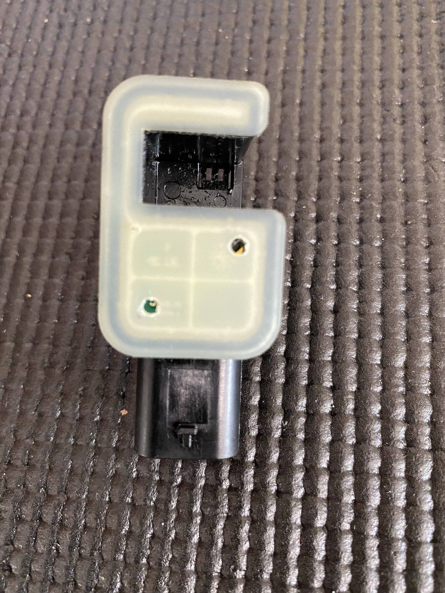

Are you blowing brake cleaner or contact cleaner in prior to potting? Also, everything says three holes yet the pictures only show two. Thx
Do not use brake cleaner, only contact cleaner. And there are 3 holes, only 2 on the clear/yellowish cover and the other is in the back of the sensor. There are pictures of this. You will need to make 3 holes or you won’t be able to fill the sensor completely which would defeat the purpose of potting.

My sensors are working and I have a Z harness in the glove box. haha, I need a new project so this is now on my to do list. I'm still unsure of the 3rd hole location in the black part of the housing. Once I pull one and review your instructions, I hope the location becomes clear.
