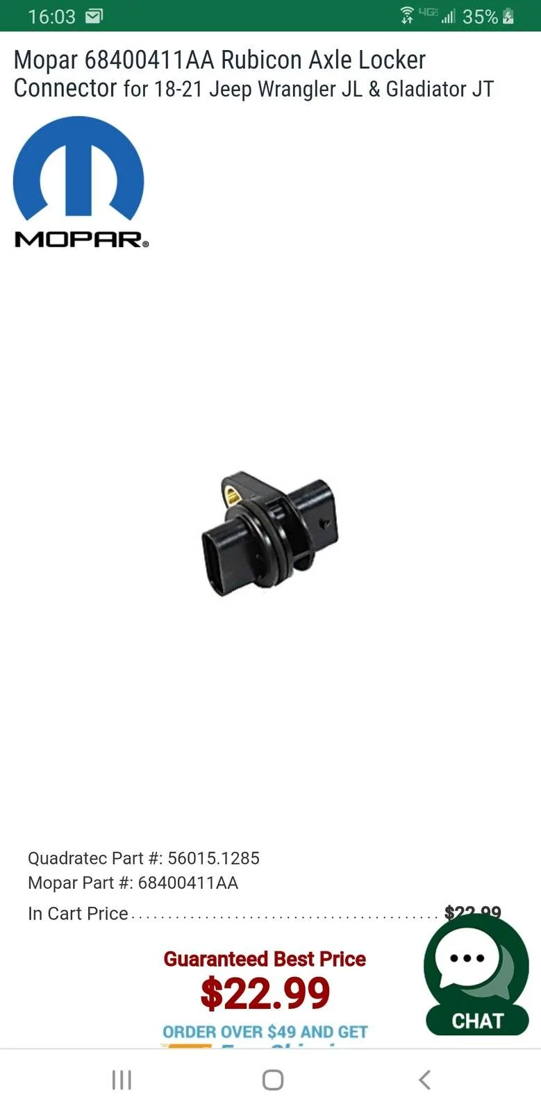

It is now. Part # 68400411-AA ACTUATOR.
I assume that part is what people are having issues with.
This is what returned on search:
Jeep Wrangler JL Locker Position Sensor Potting - DANA 44 Screenshot_20210916-160315_Chrome
I don't think this is the same part everyone else is talking about.
SpaceCase
Mar 12, 2021
210
186
NM
4xe Rubicon
It is now. Part # 68400411-AA ACTUATOR. Says:
"REPLACE SOP PARTS.
RELACED REAR DIFFERENTIAL PASS THROUGH CONNECTOR HARNESS
AND CLEAR ROAD FAULTS, ROAD TEST AND NO FAULTS RETURNED"
Unfortunately, that part looks to come back as the connector.
"REPLACE SOP PARTS.
Nope. That's not the sensor, it is nothing more than a connector that sits in the axle housing allowing the internal wires to connect to the external harness.
