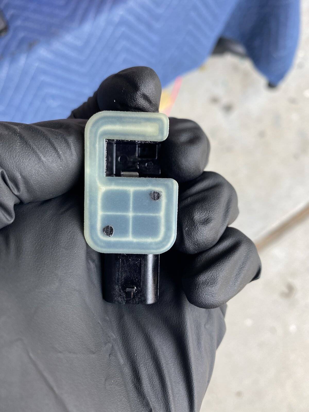

I used a Sharpe to mark the cover with two small black dots. These dots are where I drilled the holes.

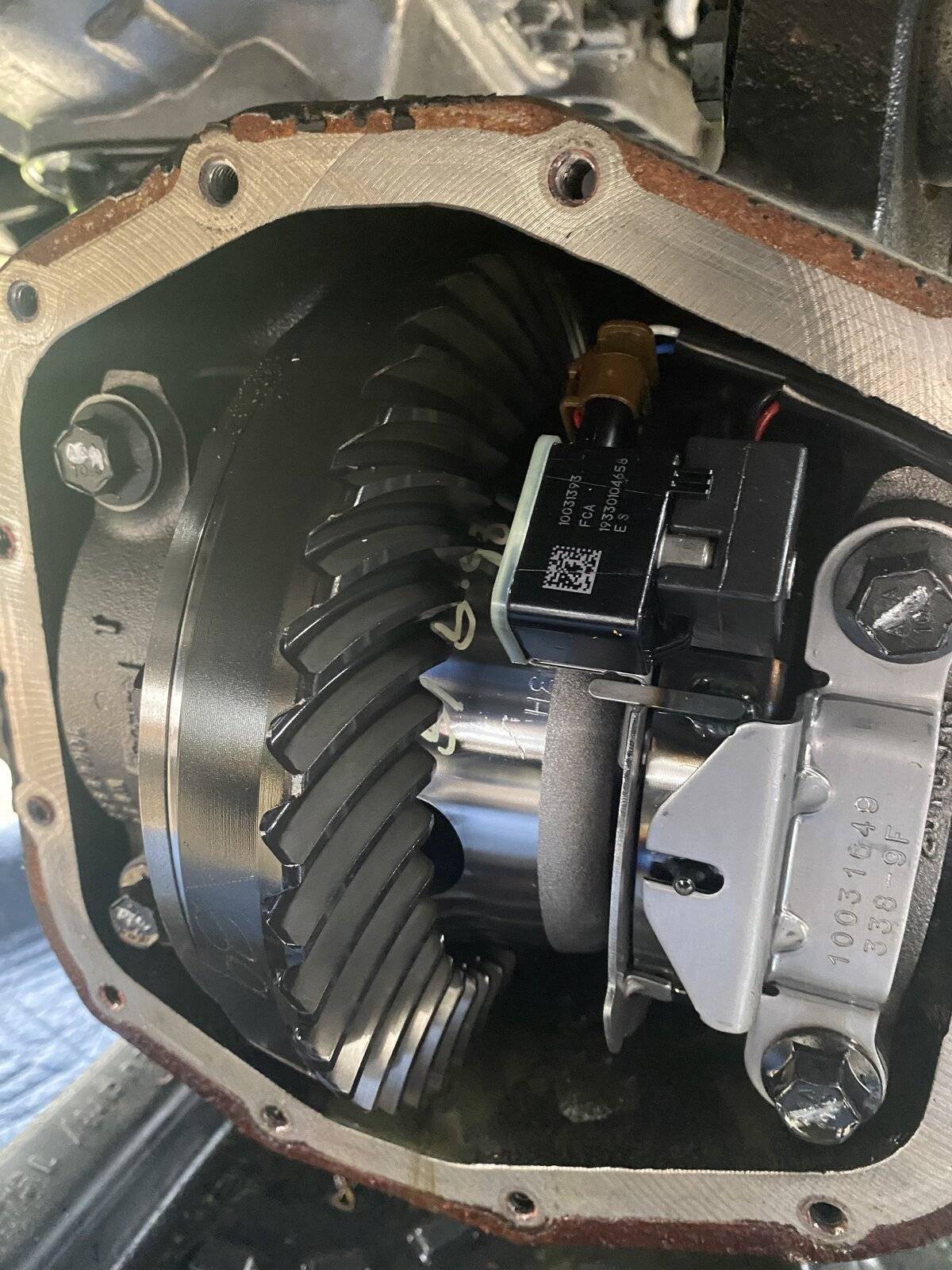

Just finished this on my Gladiator! Process went a lot faster from the 1st time I did this on my JL. What helped a lot was jacking up the front driver side to make it easier to get to the diff cover bolts. I was able to get the sensors out without removing the cap bolts. I haven’t tested the system yet but this was the first thing I did as my Gladiator only has about 460 miles on it! I ended up getting 3 bottles of Amsoil 75w140 and putting it in the F & R axles.

Nope they were dry. Then again the Gladiator only has a few hundred miles on it.
Well, that's still good. I've got 47k on mine and am getting ready to re-gear with 4.56 rings/pinions, so I'm going to pot them when the guy has the diffs apart, if they show oil intrusion. If they don't, then I may not bother with them. It'll be interesting to see what's going on in there.

I pulled mine today and potted them. Pretty easy really, the drilling is not much to worry about. I used a cordless variable speed drill and went slow. Wasn't a big deal. No oil intrusion in either of mine yet
There were some fines on both plugs, front fluid was still really clear. The Jeep has about 1900 miles on it with three trail days in 4wd and some locker use. The worst part is the thread locker on the diff cover bolts. Makes them hard to turn the whole way out and the one I had to do with a hand wrench on the front tested my patience. They are on the bench drying now, going back in in the morning.
I am using Amsoil severe gear 75-90. This is my wifes car and will never tow anything.
