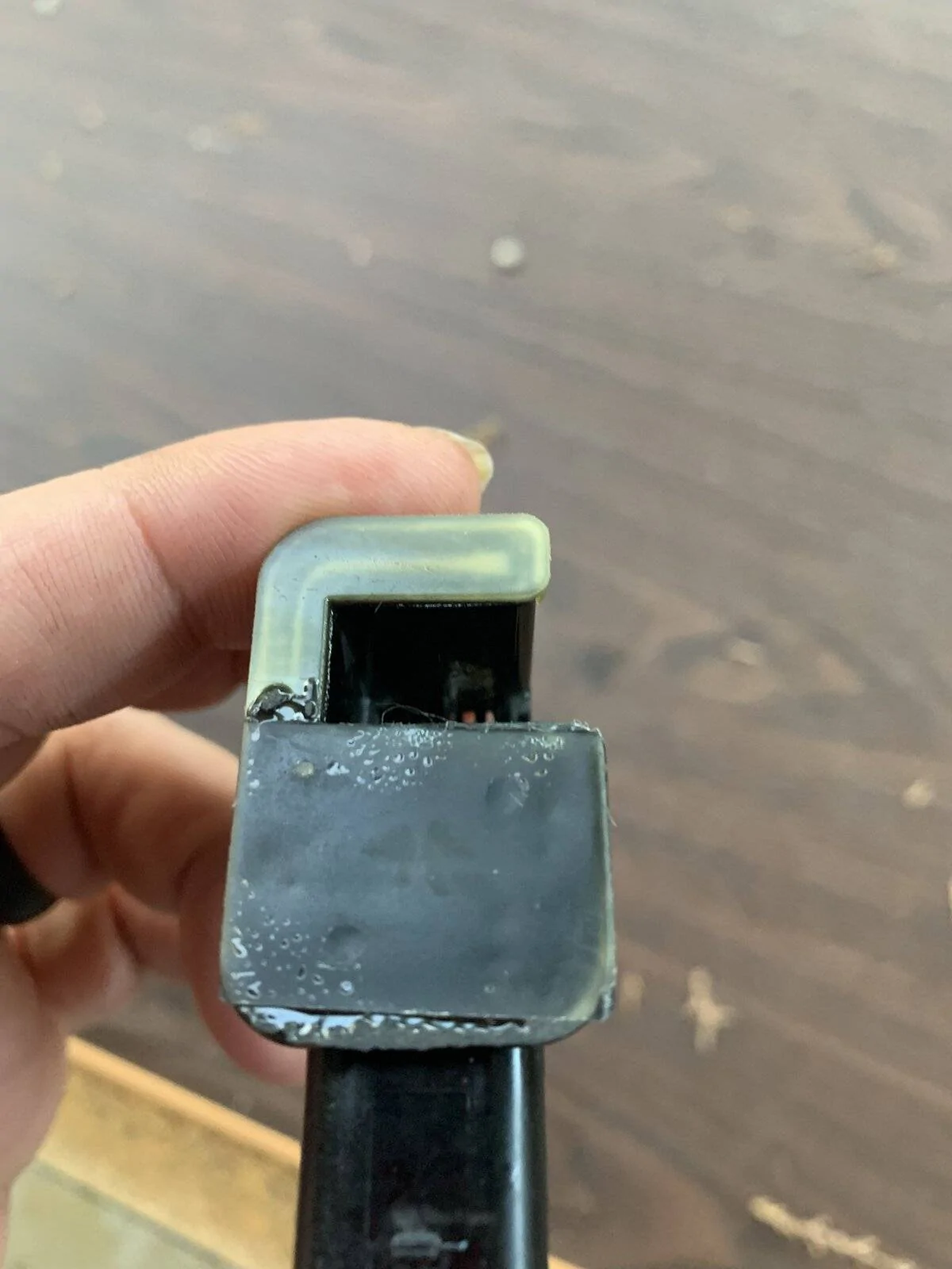

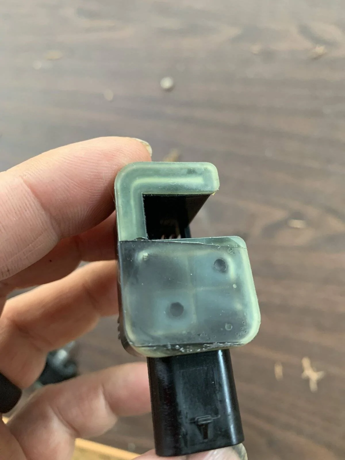

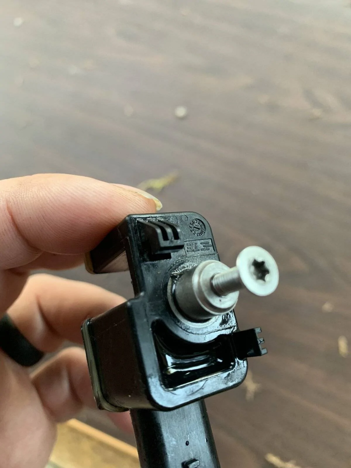

Got it done finally. All tested out and works great. My tape kinda didn’t hold as it should have when I injected the back on one of them, but it fit and works. I’ll just take it as I definitely got the air out.

Did you use a drill press? How did you make sure you didn't drill too far in?
