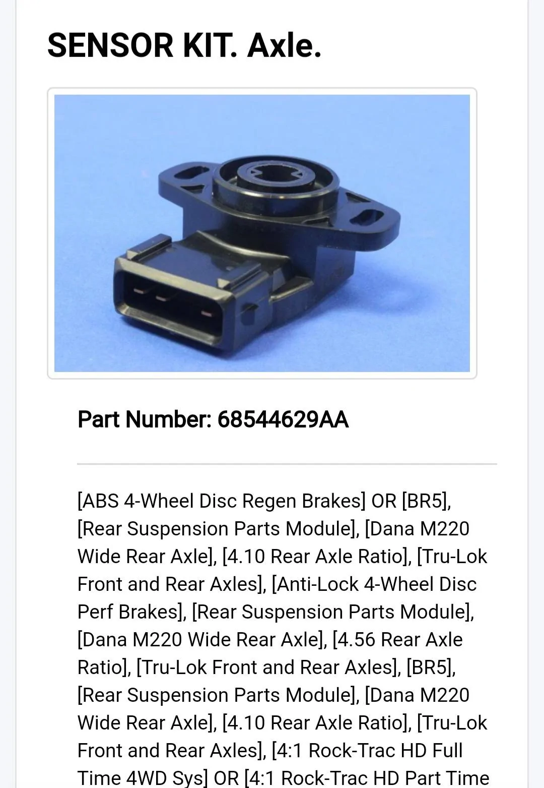

Hi,
Looked this morning for the sensor and almost all came back with "403 Forbidden", wonder if they didn't want the cat out of the bag yet?
1 had a picture:
Jeep Wrangler JL Locker Position Sensor Potting - DANA 44 Screenshot_20220114-074754_Samsung Internet
Although it looks different, haven't seen in person.
