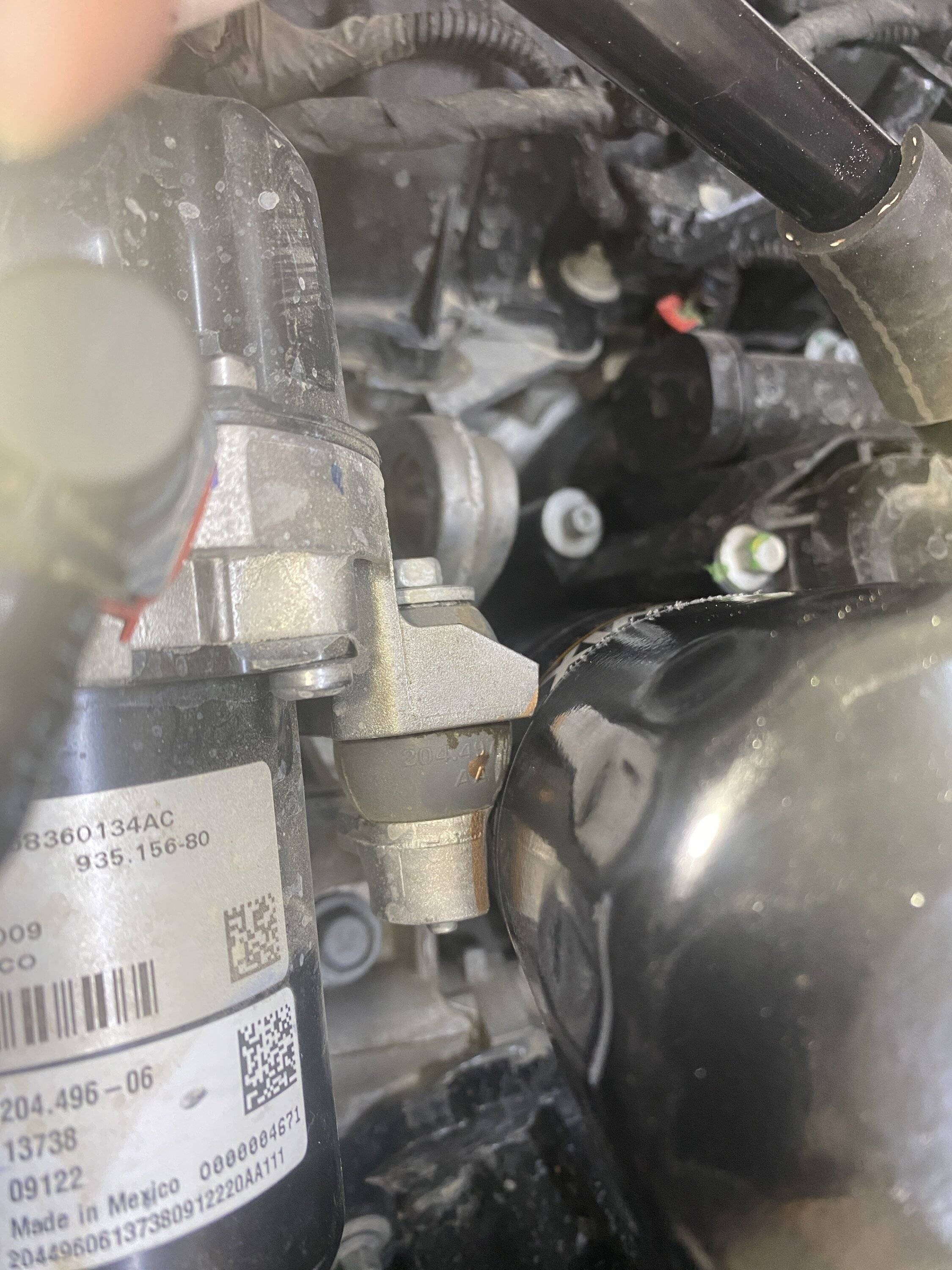

I have one in my JL and JK. I have no idea if it helps, of course, but it's eerie to not hear the ticking lifters on startup. I can't help but think it will help longevity.
If you have the e-torque option, you'll definitely need to create some clearance between a bracket and the oil filter canister.

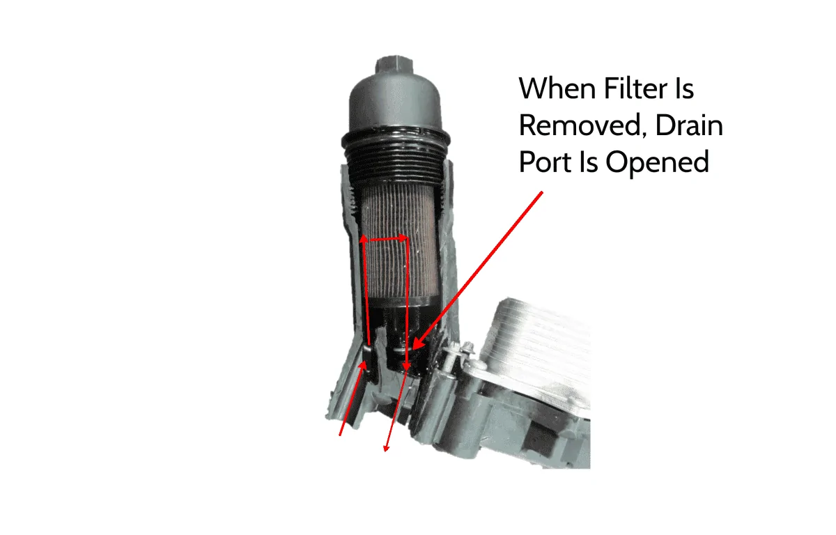

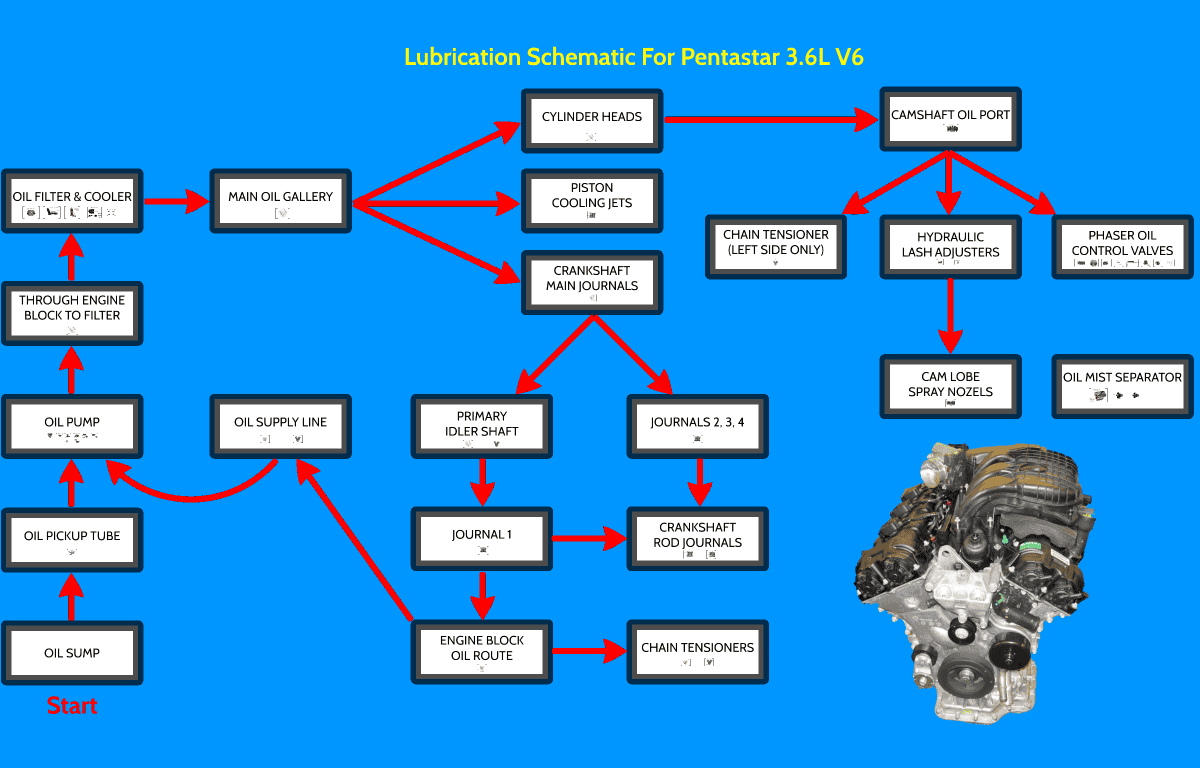

You have to remember that the Pentastar does not suffer from oil drain back as shown in the information below. So, the Baxter will not help in that regard. I always saw the Baxter as a way to either install a spin-on oil filter or relocate the oil and/or install an additional oil cooler.
It is hit or miss who will have issues with the camshaft/rocker arms and not everyone has it happened. The only thing that **may** help is to increase the oil viscosity. The Pentastar is not viscosity dependent, and I would run a 0/5W-30 in it to provide more protection. I have a friend in Texas who has ran 0W-40 from the first oil change and has over 120K on his now with ZERO issues.
From a post I created in 2022:
For those interested, I found this which details the oil system on the 3.6L Pentastar.
Of particular interest is this slide that shows the oil filter in the housing and indicates a drain port in the filter housing.
While there is no anti-drain back valve in the filter itself, the filter does serve as somewhat of an ADBV with its o-ring on the bottom tip of the filter.
There are two things that are almost certain:
1. After all of the oil has drained, if you pull the filter, more oil will drain out indicating the oil is being prevented from fully draining back into the pan.
2. The main oil galleries remain full of oil and I will opine this is where the additional oil comes from when you pull the filter. If the oil galleries did not remain full of oil, there would be measurable and substantial wear on the crankshaft journals and likely piston skirts since those are the first things lubricated when the engine is started. It is the o-ring at the bottom of the filter that "seals" and prevents the oil from fully returning to the pan.

Try this
Let your 3.6 sit over night and then remove the oil filter
What you will see is almost dry oil filter
What you will not see is an oil filter dripping with oil
All the oil has drained out of the oil filter housing
