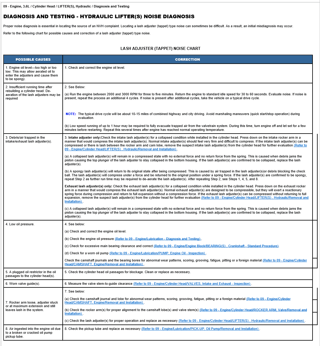

If you're going to do this work, I'd suggest getting a service manual for your JL. Even at inflated prices, it's going to pay for itself.
Jeep Wrangler JL Lifter and Rocker Arms??? 1673800637202
