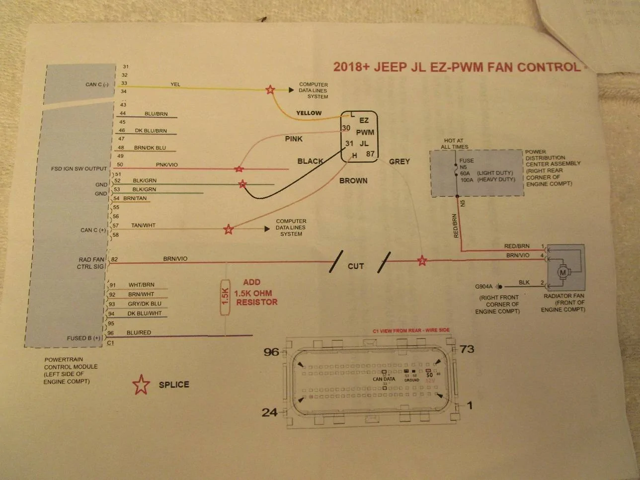

Just installed the Rpmextreme JEEP JL PWM FAN CONTROLLER
This is a game changer . Here is how your fan will work with this device
Operation:
When the engine is running the PWM fan will run at a low Idle speed (15%).
When the module reads the engine temp it will command the fan to the desired %.

Override inputs: These are optional inputs depending on if you ordered them.
These inputs will run the fan as long as the unit is powered up, the engine does not have to be running for these to work. You can use these in various ways.
Example:
When the ( VIOLET ) wire has 12 volts applied the fan will run at MAX speed.
