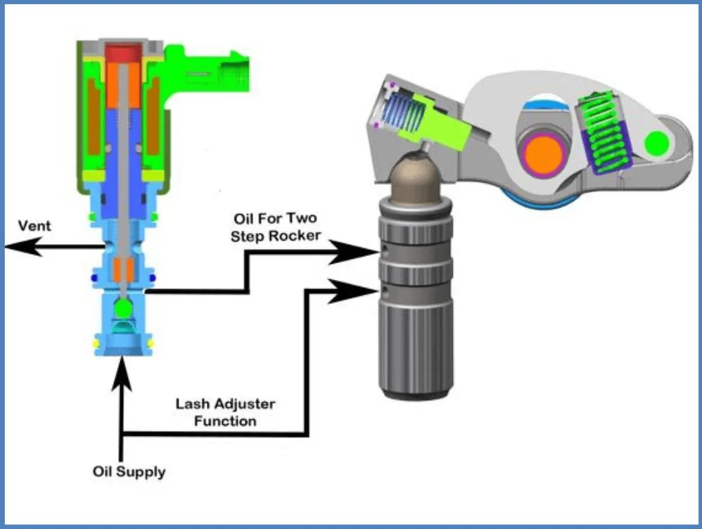

I get where you're coming from, the Pentastar has a solid reputation overall, and it's true that millions of these engines are out there doing just fine. But I think it's also fair to say that the 2018+ Gen III version in the Wrangler has shown some concerning patterns, especially once you're outside the warranty window. It may not be a "bad engine" in the grand scheme, but there are a couple of recurring issues worth keeping an eye on.
Head Gasket Concerns
There’s a growing number of post-warranty failures being reported, most commonly around 70k–120k miles. These aren’t isolated to heavily modified rigs either. A few things stand out:
The Gen III raised the compression ratio to 11.3:1, but Jeep still recommends 87 octane. That’s pushing the knock margin, especially in hot climates or when loaded.
The PCM does retard timing when knock is detected, but it can’t eliminate all pre-ignition. Over time, chronic knock can stress the head gasket seal, especially between cylinders.
While it’s not officially confirmed, several teardown techs have noted inconsistent torque on head bolts from the factory.
So is it a design flaw? Maybe not. But it’s a stack-up of compromises that are showing up more often than you’d expect in stock engines.
Cam Follower / Valvetrain Failures
This one's harder to dismiss. Jeep has issued multiple STAR cases and updated parts for cam followers and cams, which means they acknowledge something needed correcting.
And just to clarify, the 3.6L Gen III doesn't use traditional roller lifters. It uses a 3-lobe cam and a locking follower design:
The outer lobes operate the follower in low-lift mode with a roller.
Under high demand, the inner lobe engages, and the roller bearings disengage via a locking mechanism inside the follower.
The issue is that this locking mechanism can stick or fail, especially when oil is hot or thinned out. And the engine runs 0W-20 from the factory, which helps with CAFE targets but offers less protection under stress.
Failures are more common on the passenger-side bank, especially cylinder #1, which may point to oil flow dynamics, that’s the first in the oil path, and possibly the most starved if there’s aeration or varnish buildup.
Jeep Wrangler JL Latest TSB on the Pentastar engine 1660087034684-png
These aren't catastrophic flaws for every owner, but they do represent weak points in this generation.
Running higher octane in hot climates, using a higher HTHS oil like 5W-30, and shortening oil change intervals are practical ways to reduce risk.
If you’re inside warranty, no problem. But if you're planning to keep the rig past 100k, proactive maintenance makes a difference.
Bottom line: not every engine fails. But there’s enough pattern here, especially from teardown reports and parts revisions, to call it more than just anecdotal. Doesn’t mean the sky is falling, but pretending there’s nothing to it isn’t helpful either.
