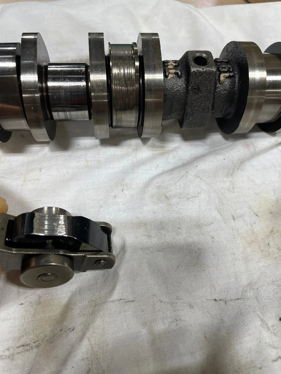

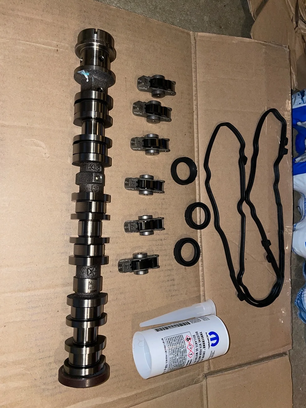

Finally I received a
Jeep Wrangler JL Latest TSB on the Pentastar engine IMG_4771
nd installed the intake camshaft that I bought from Mopar, waited 3 weeks for the kit to arrive, $540 versus $1200 from the dealer.

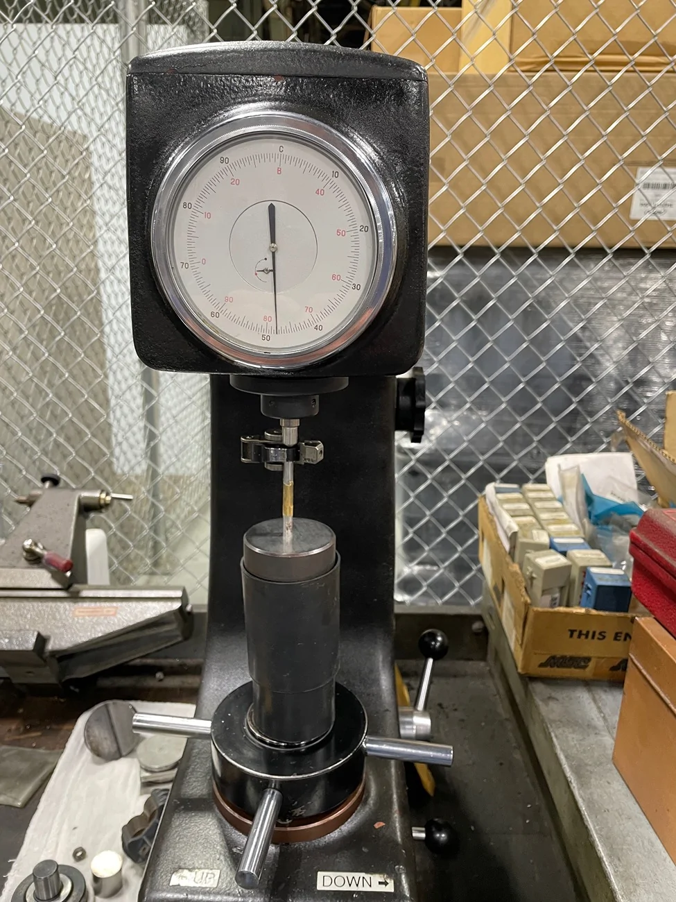

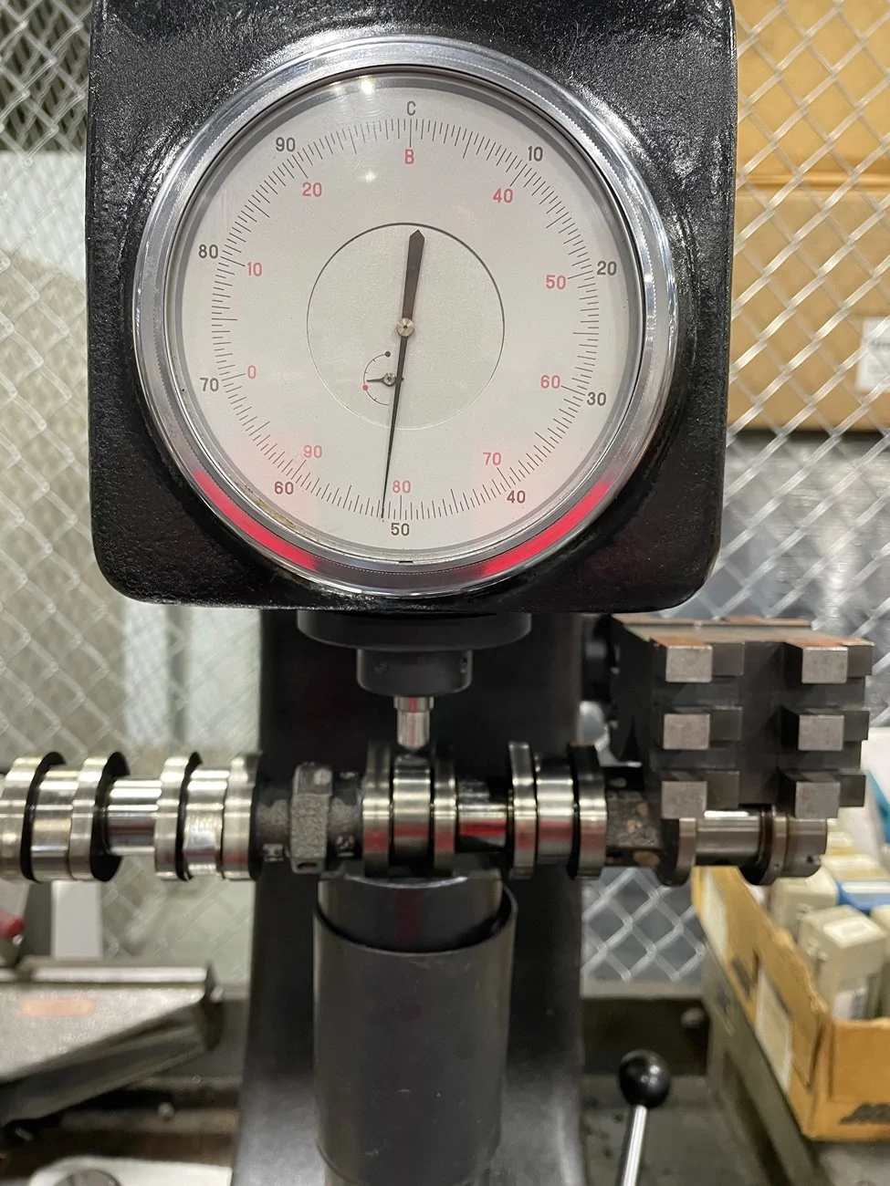

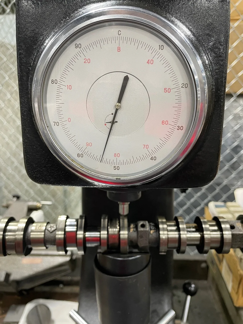

As I mention it on beginning of this post that I would take the cam with me to work and check the harnesses of the cam and the follower
and I got about 53 Rockwell on both parts. It’s kind of on a low side as standard go for 58 to 64 Rockwell.

I checked all the other cams and they all look fine, but I did replaced the cheaper rollers that are on the exhaust cams,
My opinion is ,nothing to do with the cam but oil starvation on the bank one intake cam.🤔
