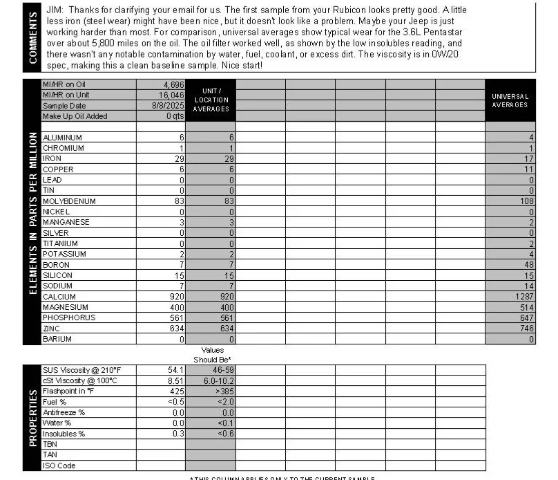

Thanks carlos c for providing the Rockwell hardness test results. I also think 53 is on the low end of an acceptable scale. Back in my hot rod days in the 60s if we had a custom cam ground the minimum we required was 60. Didn’t make any difference whether we were building small block or big block Chevy engines, with the increased springs pressures it was a necessity. These Pentastar’s V6s are working pretty hard and are horse power revving engines not lower RPM torque engines. I agree a little oil starvation could also be a culprit and coconspirator to these camshaft and lifter issues. Knock wood no issues at 17,570 miles. Attached copy of my oil lab report for reference done a 16,046 miles. Only concern is a little on the high side for iron. Will see what the next lab report shows.
Jeep Wrangler JL Latest TSB on the Pentastar engine 23 RUBICON-250808
