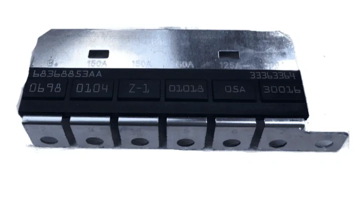

Here is the High amp fuse and location(oval in Red). I just typed into google High amp fuse Wrangler JL and that link came up..I clicked and it was live so I'm not understanding why it's dead for you.
Jeep Wrangler JL Jeep nightmare! Jeep-JL-Fuse-Array
Jeep Wrangler JL Jeep nightmare! Jeep-JL-Fuses-and-Relays
