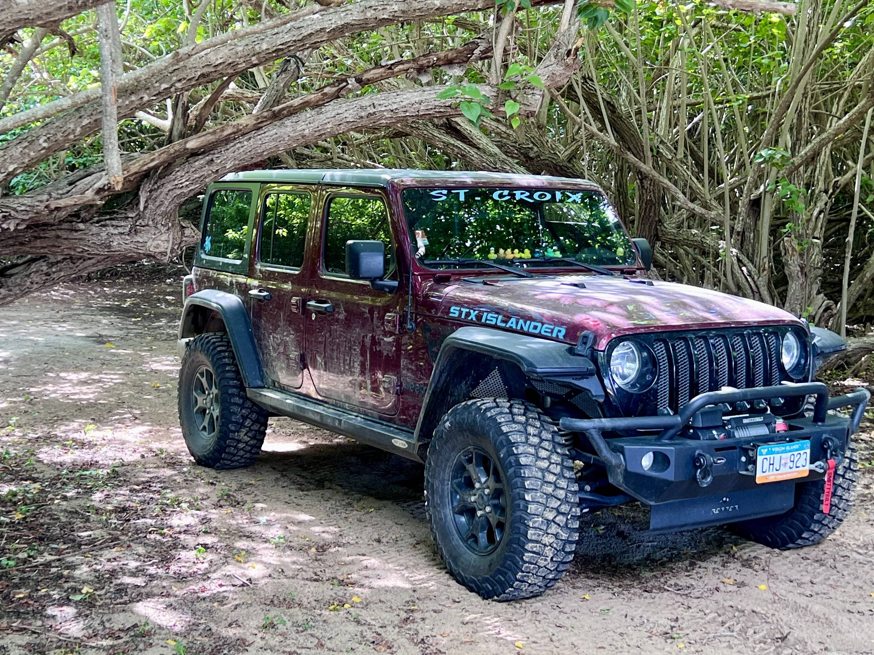

So I hit something on the trails. After getting back on road I noticed slight pull to left and steering wheel a little off center. Also had “service electronic stability control” and traction light was on. I figured it was an alignment issue and/or wheel sensor issue. Took it to the Jeep dealer and all they did was do alignment on the two front wheels. That corrected the pull and the steering wheel issue. However, now the backup camera lines are skewed full right when the wheels are straight. Auto start/stop doesn’t work because it says wheels aren’t straight. (They are). And the power steering is intermittent now. Still have traction light on and still says service electronic stability control. Also hill brake assist doesn’t work now. Frankly I’m scared to take it back to the dealer as they may mess it up even more. Ugh. Anyone have any ideas on what the root cause could be and a possible solution to try?
2022 Wrangler JLU Willys with 2” lift and 35 tires. Thanks!

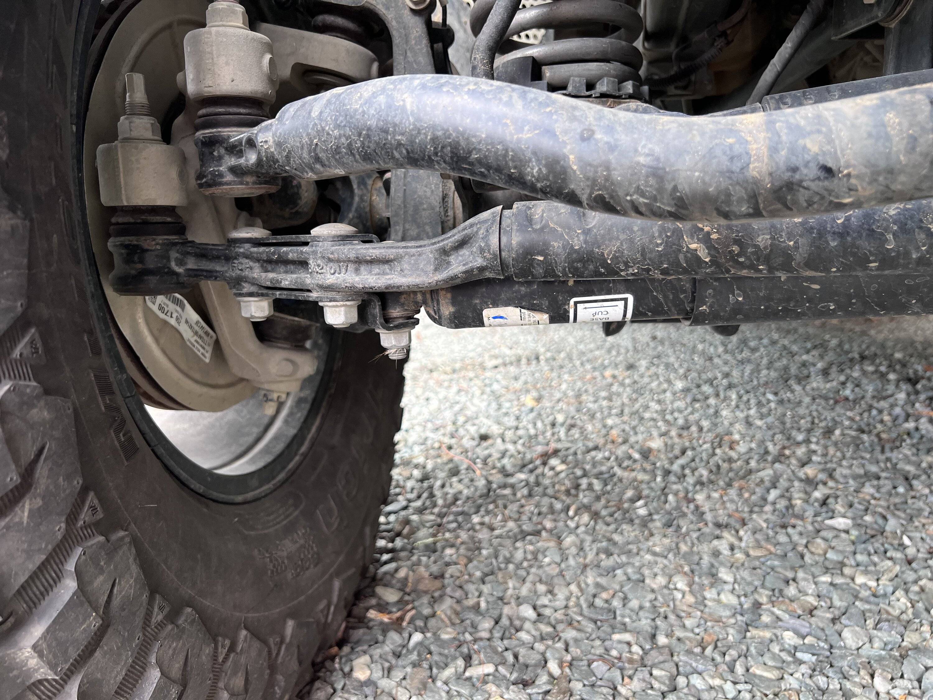

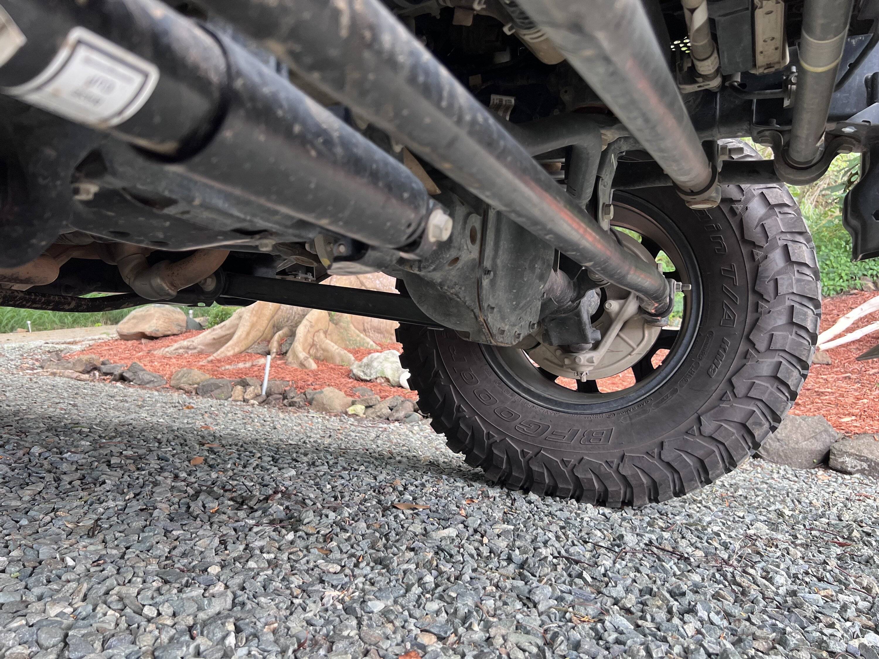

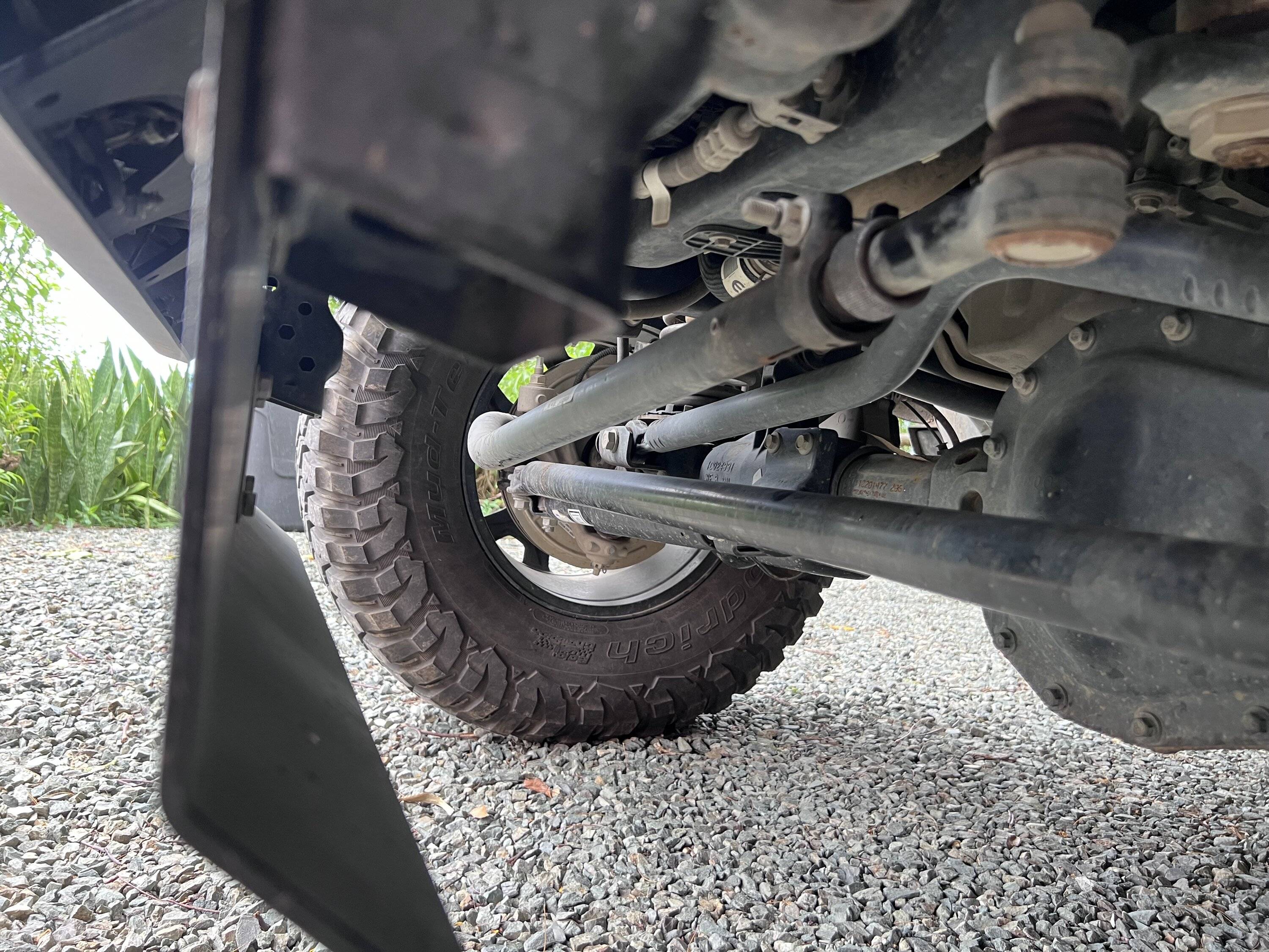

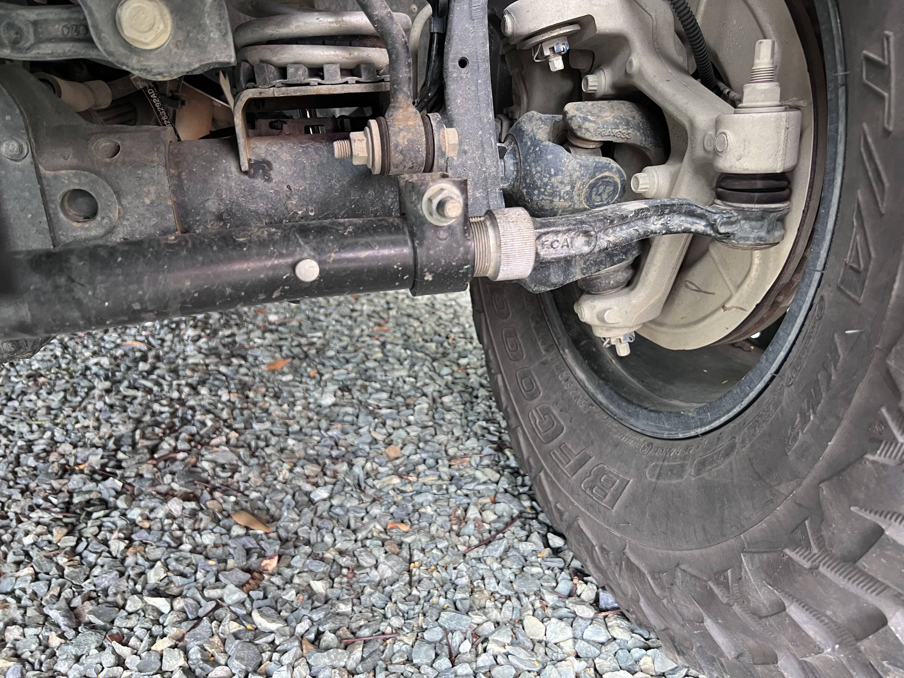

Drag link doesn't look right imo, how well does it steer from full left to right?

It steers fine in both directions. Although now it seems the power steering goes out slightly while turning. And by that I mean it sometimes steers with power and then power goes out a little, takes a little more steering pressure and then comes back on to complete the turn. If that makes sense. Lol.

Your alignment doesn't just get knocked out. Something is bent. I'm betting that it's your drag link. The steering lines issue is another hint. I bet they aligned your steering wheel a full revolution out. The position sensors can't suddenly just be off after an alignment.
Take it back and have them try again, centering the steering wheel, and check for bent components.

My money is on either the drag-link or track-bar is bent.
