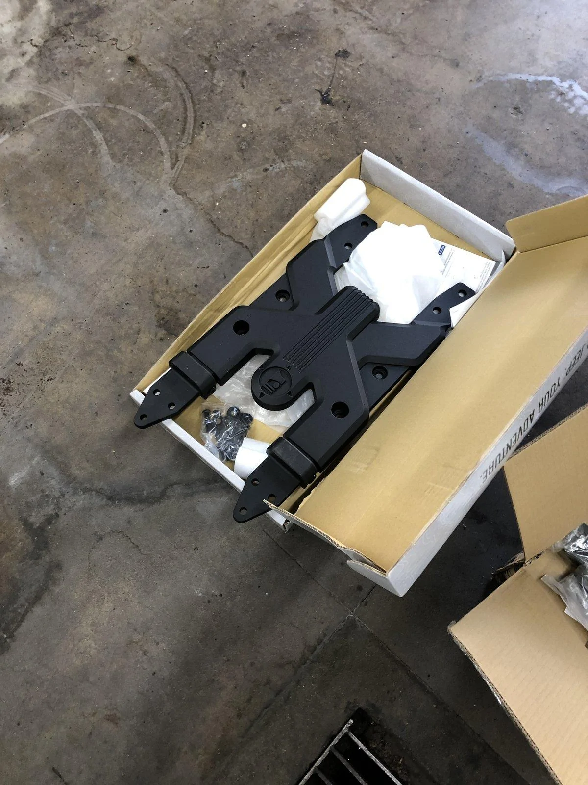

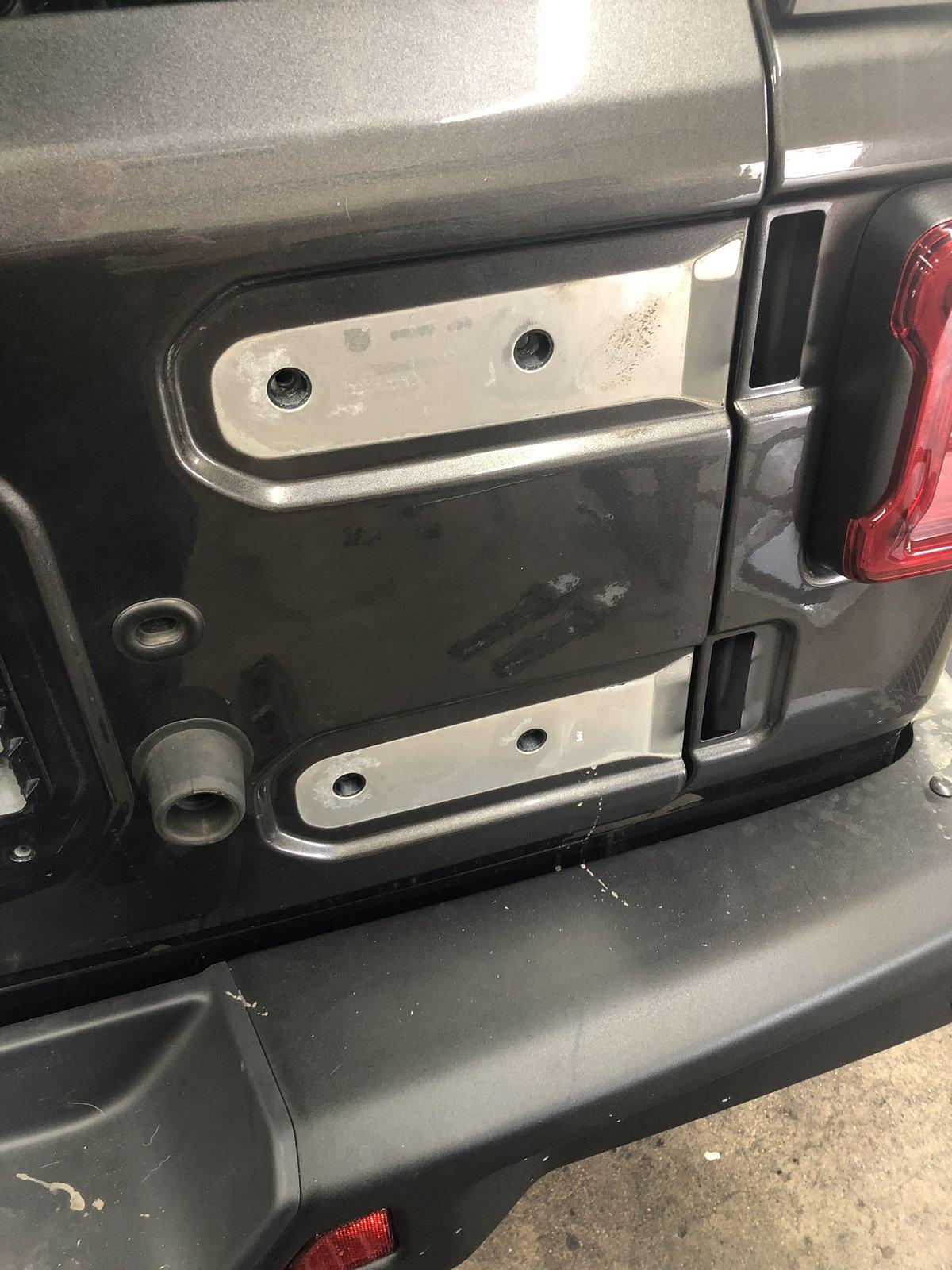

Nope it was on aftermarket wheels and tires, not my first rodeo, heard from allot of other people saying the same thing after buying the Mopar setup. I get the idea of backing up the tailgate itself, but I found that when installing one of three different reinforcement kits that the gate is plenty strong, the weak spot is the hinges.

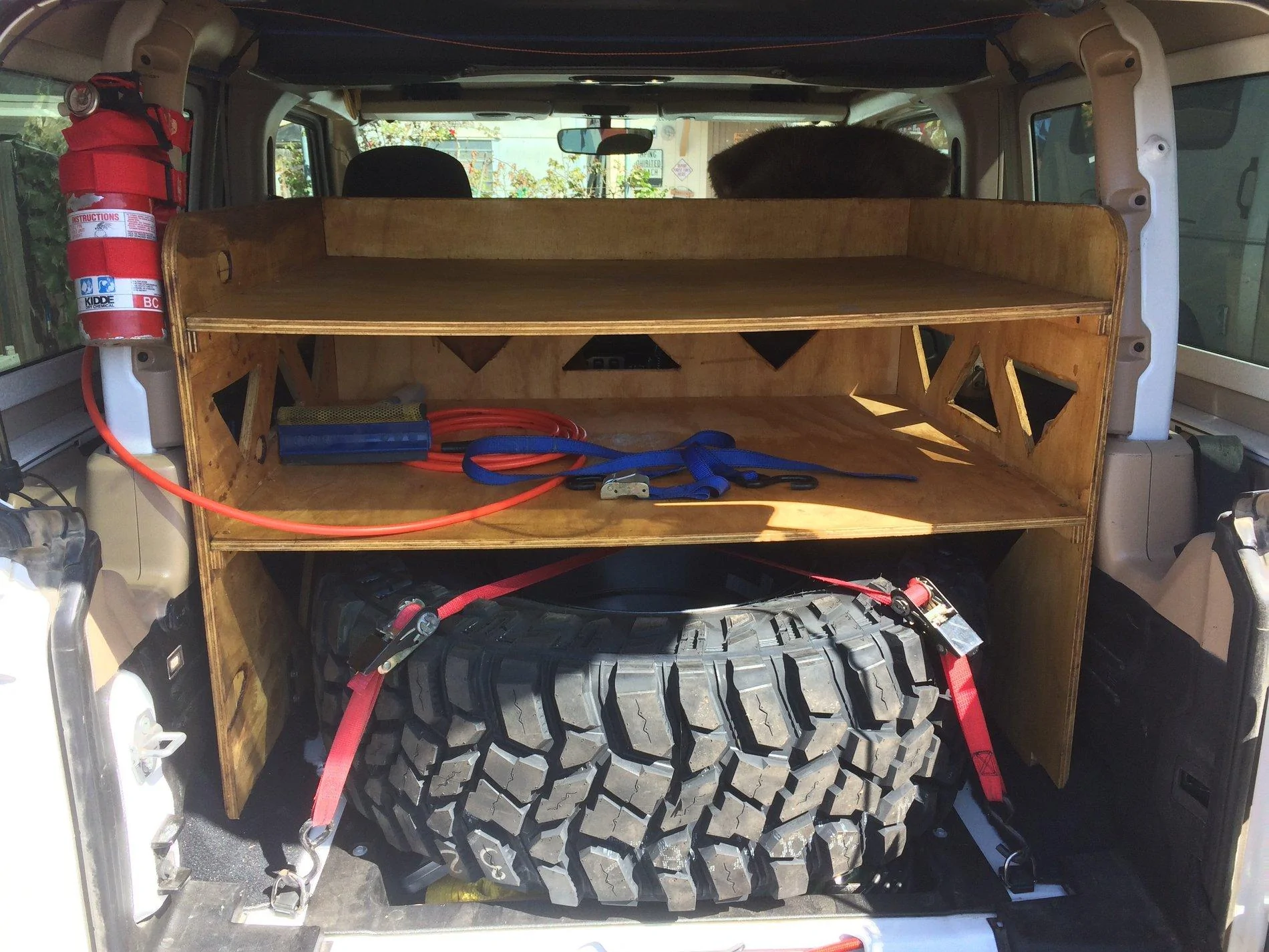

My spare’s location.
Jeep Wrangler JL Is Tailgate Reinforcement Needed? JL spare's new hom
