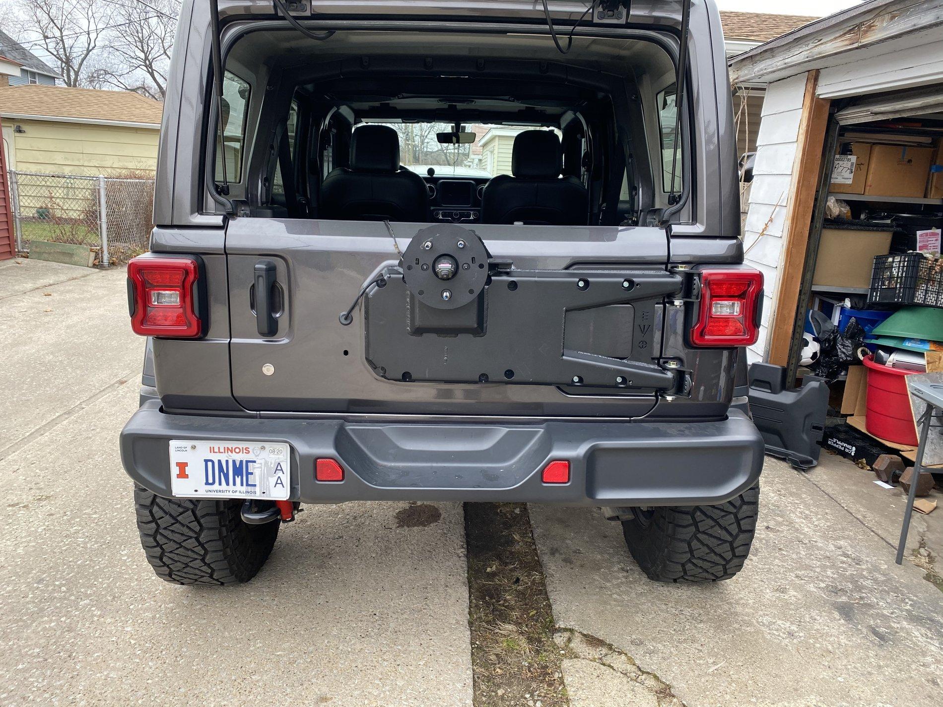

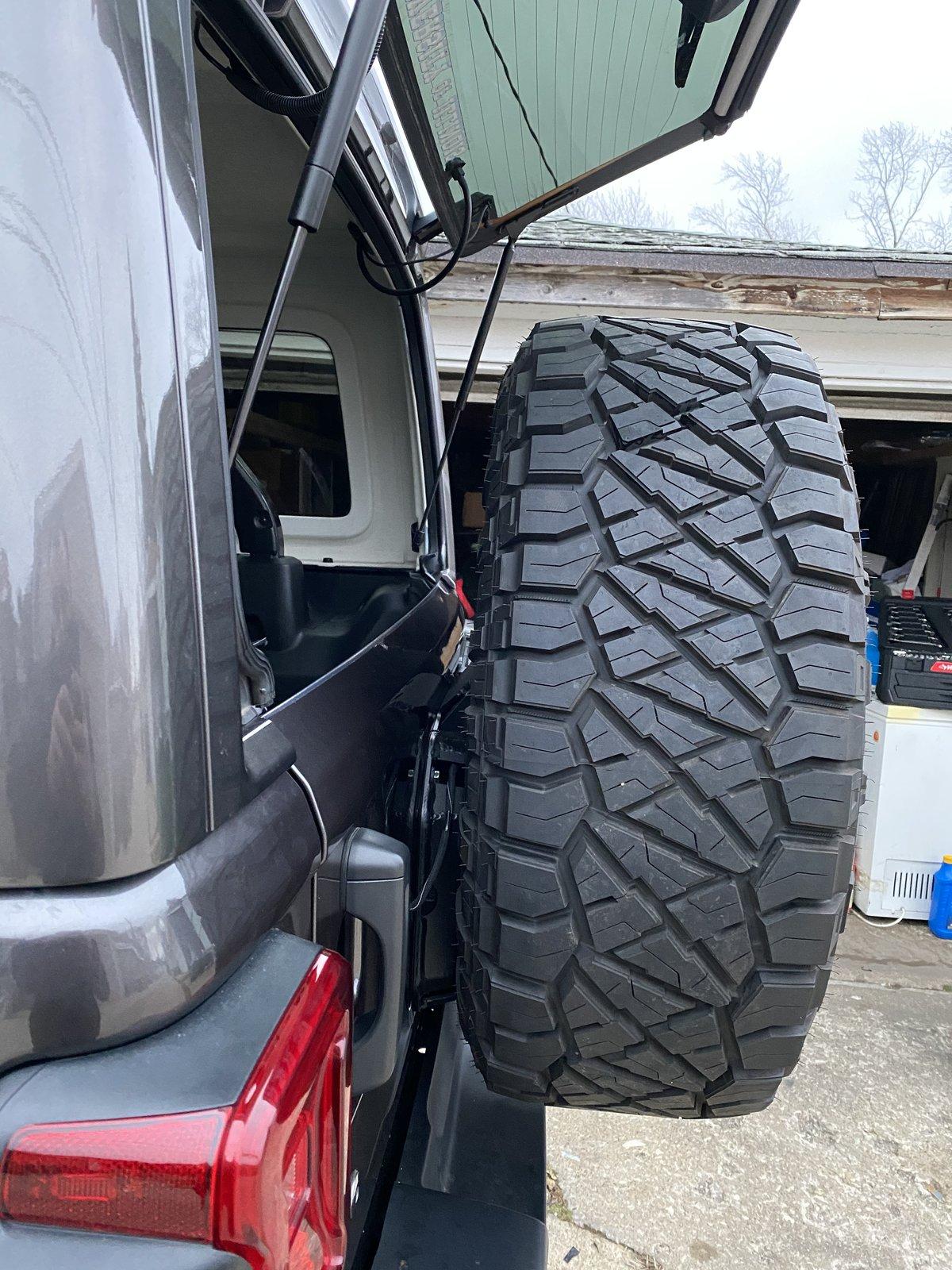

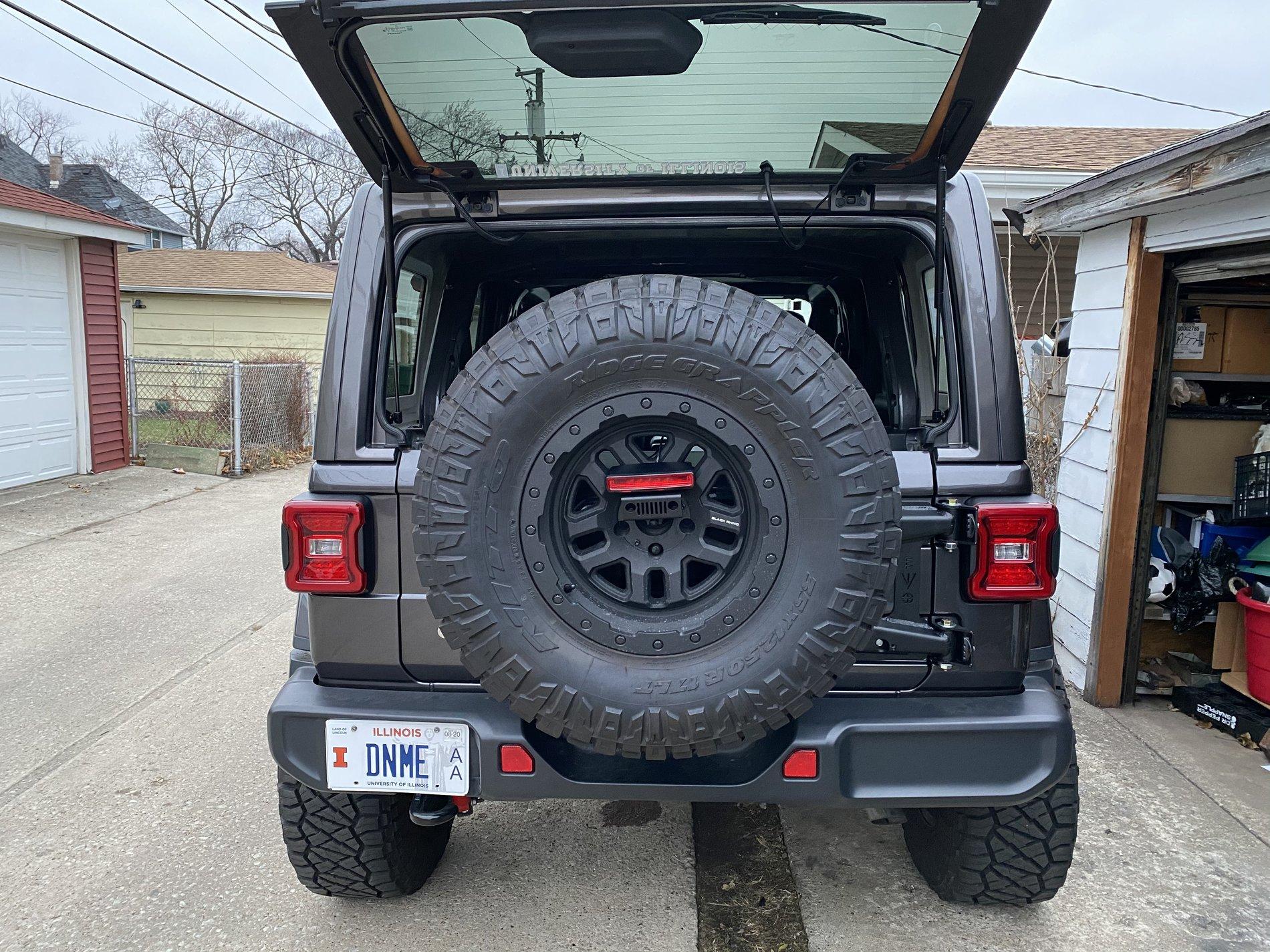

I was running the RC relocation bracket with my 35” Nitto but will hear constant rattles when going over bumps. I installed the EVO tore carrier this past weekend and couldn’t be happier. Noise is gone and feels really sturdy.
