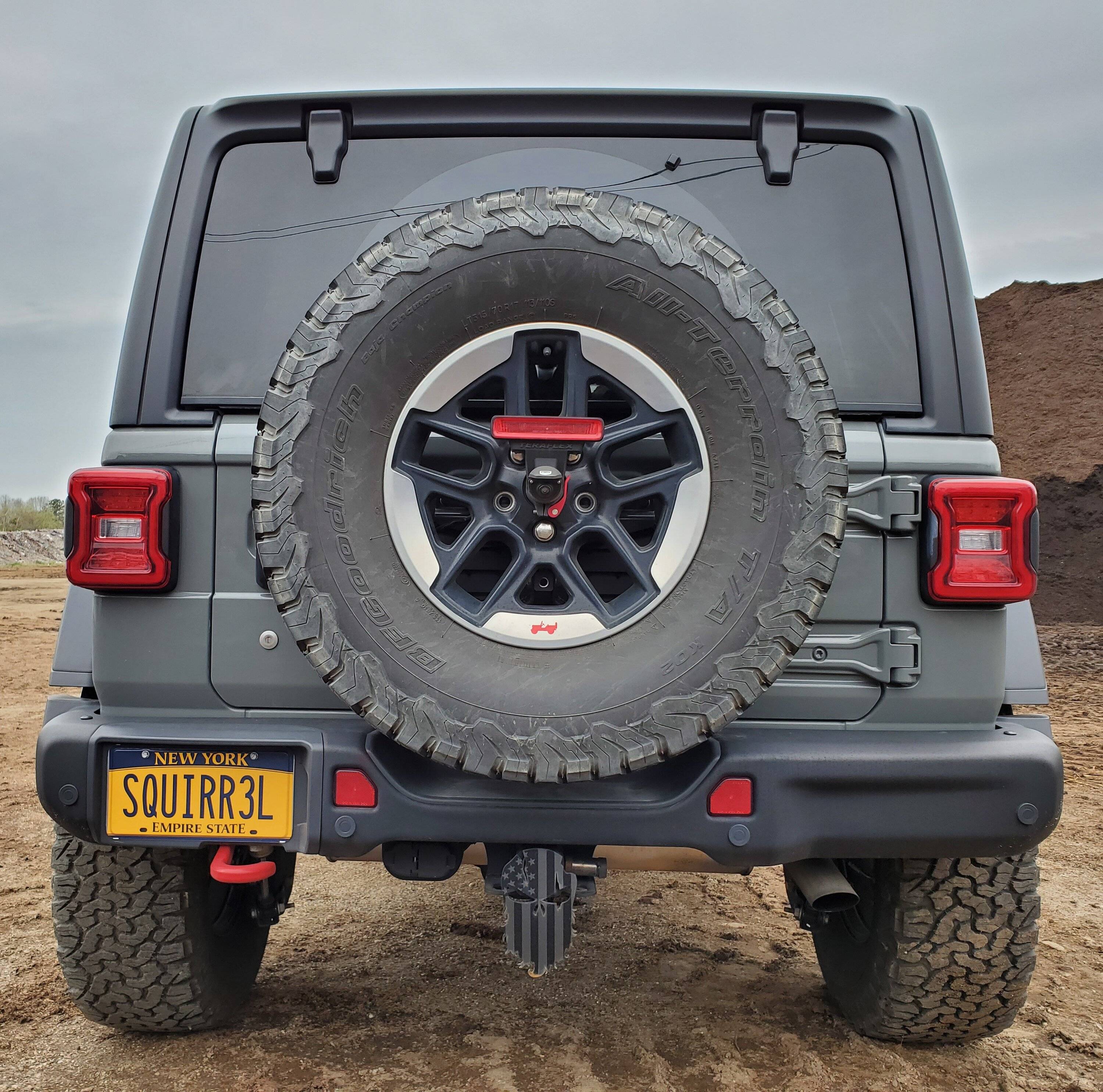

315 ko2's on factory wheels and carrier. The tire was lightly rubbing on the factory steel bumper. Also, I took this shot from a crouched position, to mimic the view from a passenger vehicle. Notice the 3rd brake light can't be seen...

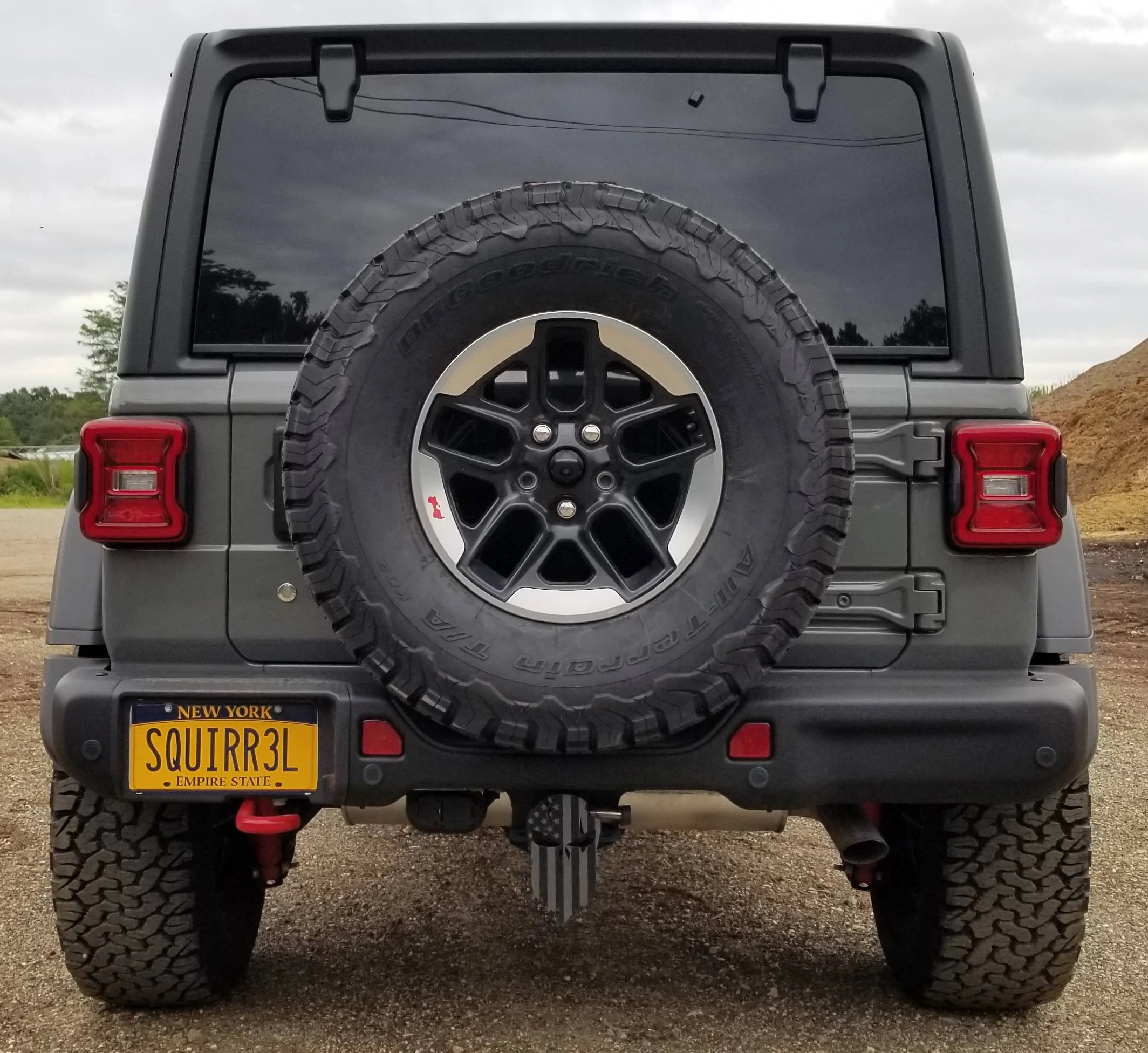

Same tire and wheel on the Teraflex Alpha HD carrier. I set it to the highest position, to get it off the bumper and maximize departure angle. I don't like the spare touching the bumper, because it can move independently from the body, opening up the possibility of transmitting undue stress when flexing offroad. Also, the 3rd brake light gets relocated and back to fully useful...

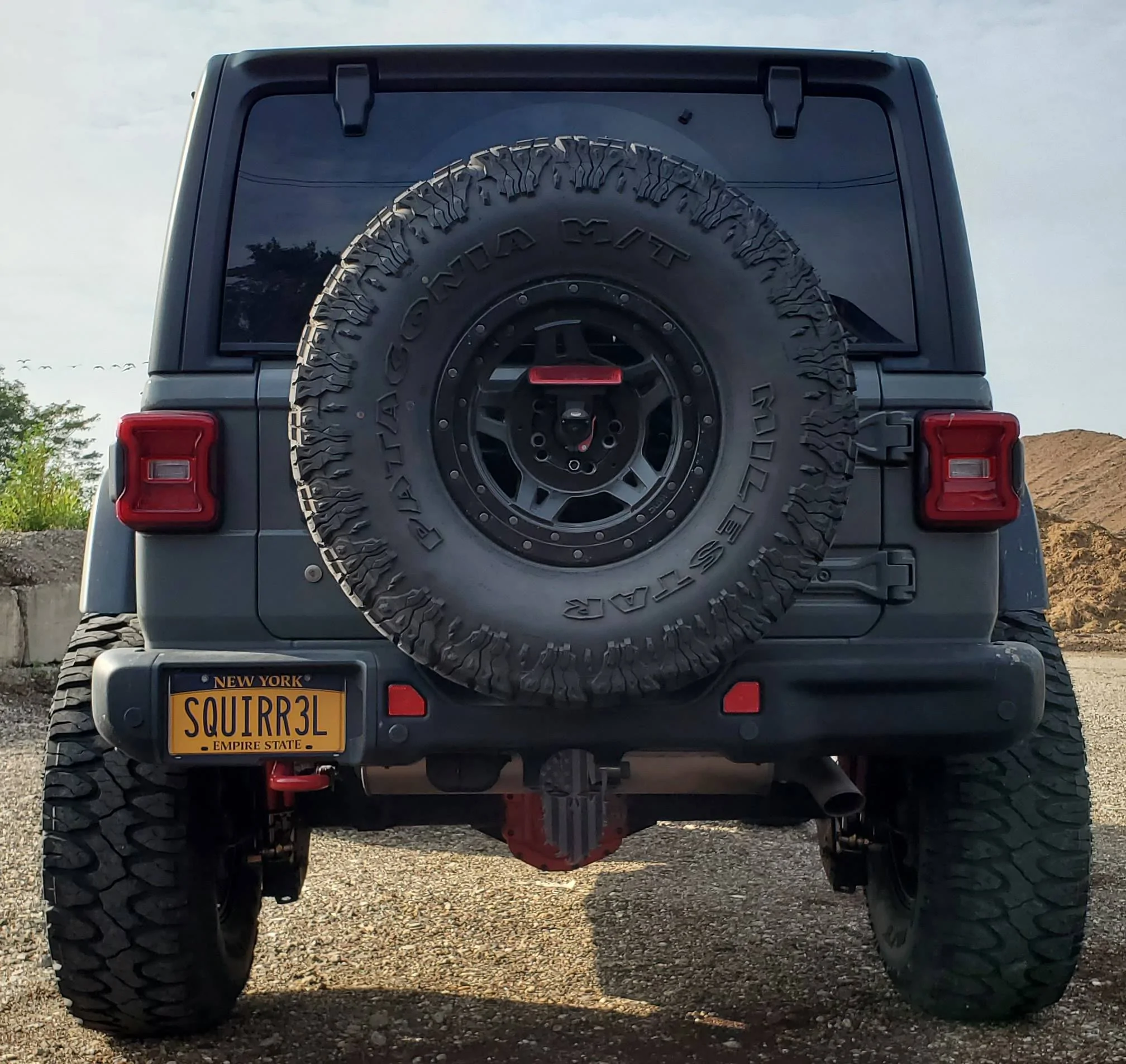

Same carrier, but readjusted to accommodate a 38x13.5 and 17x9 wheel with 4.53" backspace and -12mm offset. The larger tire was less than a spark plug gap away from the bumper. Also, the increased weight was fine on road, but I knew the tailgate wouldn't be happy when bouncing around offroad...
