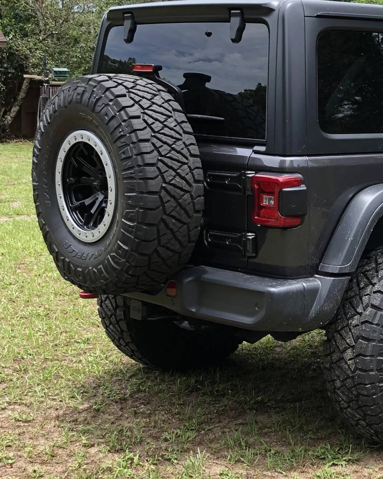

I may be missing something... But that Mopar reinforcement will be needed with 37s. Or, do you think you need a more sturdy brand? I used mine with NITTO Ridge Grappler 37s, and it was ideal. I'm currently running without a rear tire altogether, mind you.

I’m one of the first to say you don’t really “need” it but if I had it I sure wouldn’t get rid of it. Especially going to 37s. Depending on the tire, they can get heavy. I’m running a 37 with factory wheels on mine but the BFGs are pretty light so I’m not too worried about it.

You should leave it on, it will carry a 37 no problem. The factory carrier and tailgate is stronger than you think. I’ve had a 37 on my factory carrier four months now, and I wheel my rig, and no issues......:)
