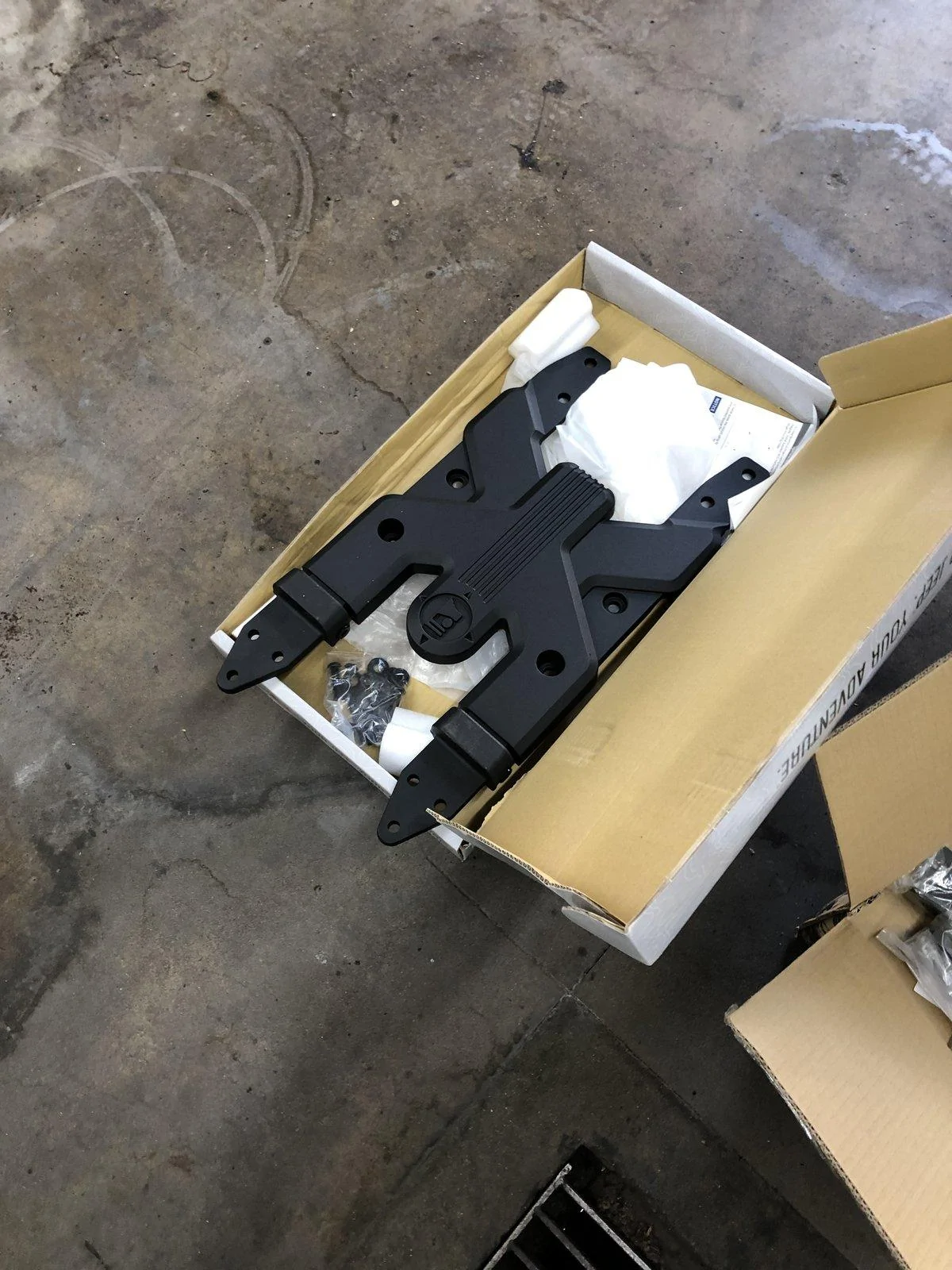

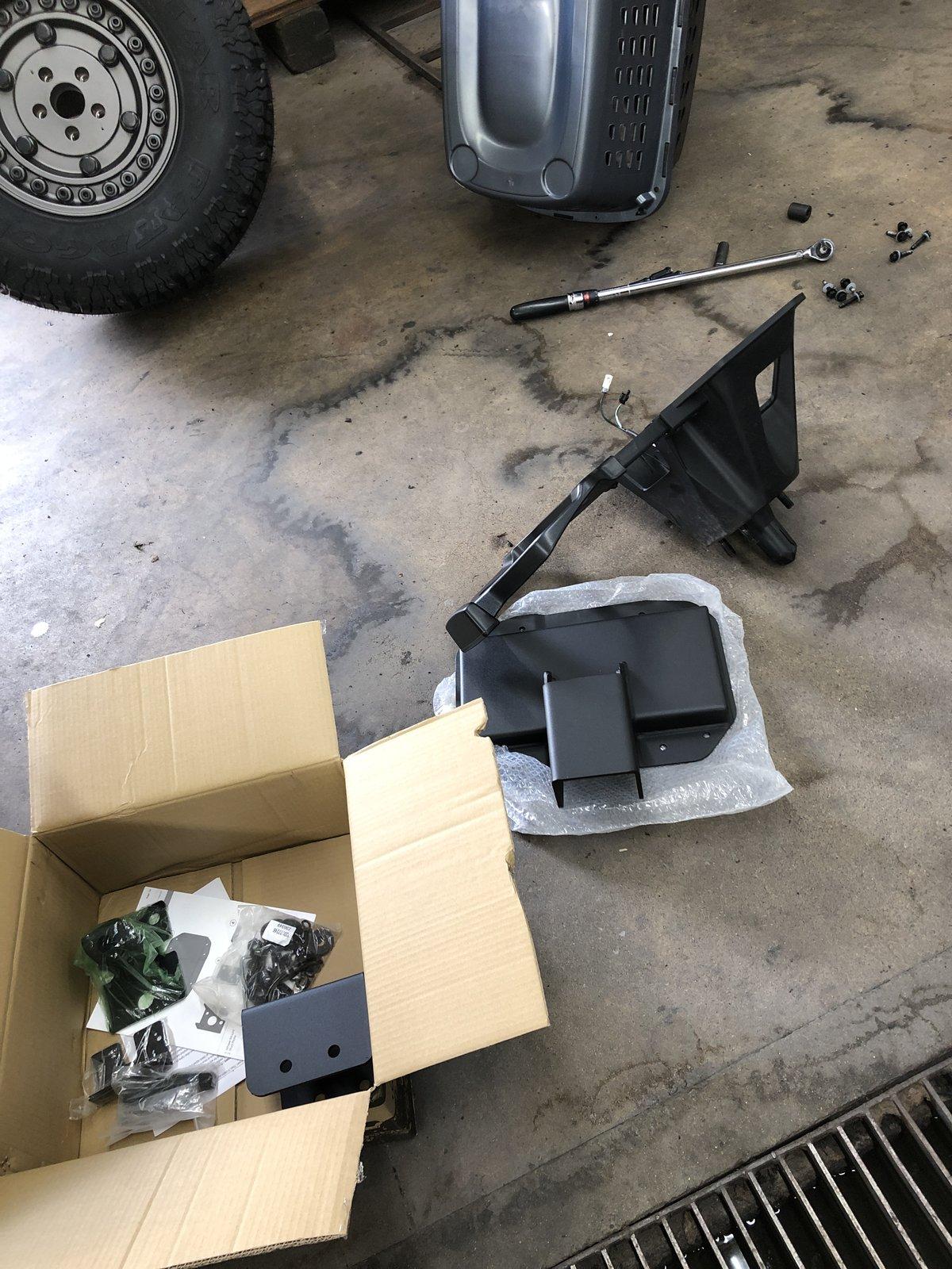

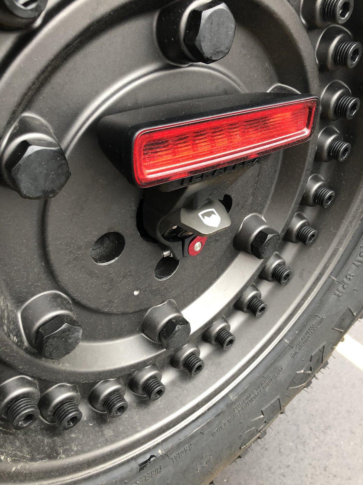

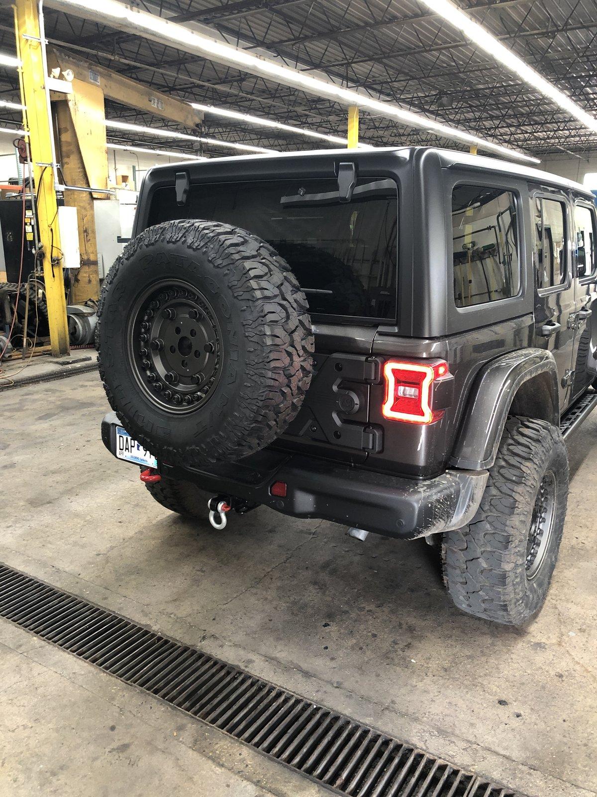

When I first did my 35's with Rhino wheels I was didn't feel the need to get a new setup, the weight just wasn't enough and the Mopar reinforcement is a joke to me. Then when I got my new 27's with beadlocks I was like holy crap I NEED A NEW System!!! I ended up doing the reinforcement when I had the 35's setup and it was honestly over kill. But with my new wheels and tires and an adventure folding table all mounted to the rear gate I am super happy with my combination of the Teraflex Alpha Tire carrier & Rugged Ridge tire carrier setup. The rugged changes the hinges which in my opinion is the only real change that makes a difference, silly Mopar :giggle:. I like the quick detachment of the teraflex for if I actually need the spare you just pull the release and remove the taillight. The setup is so sturdy I can hang from it all day. It is allot of money and the combination was an effort to get around my rhino wheels not having any holes to run the brake light through, but with my new Wheels that have openings I am still glad I put these two kits together! I like not having the brake light in the way when I look back and how the entire spare sits allot higher, clearing the rear bumper and any thing I might hit on the trails, also with the ability to adjust it, I can mount the wheel flush as possible to the back door.
