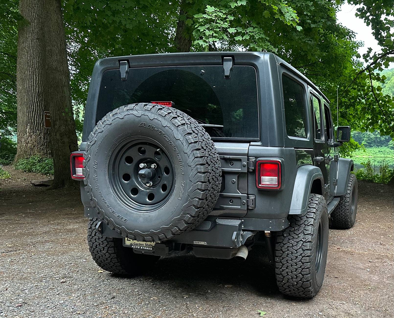

After living with my bfg 35" on Steelies for 6+ months and often having to close the tailgate twice to overcome the sag I finally broke down and added one of these:
https://a.co/d/0bH4DTtX
Completely fixed the issue at a fraction of the cost of the mopar reinforcement or other overkill solutions that some are proposing for 35's. If you plan to go bigger in the future then maybe overkill is good...
