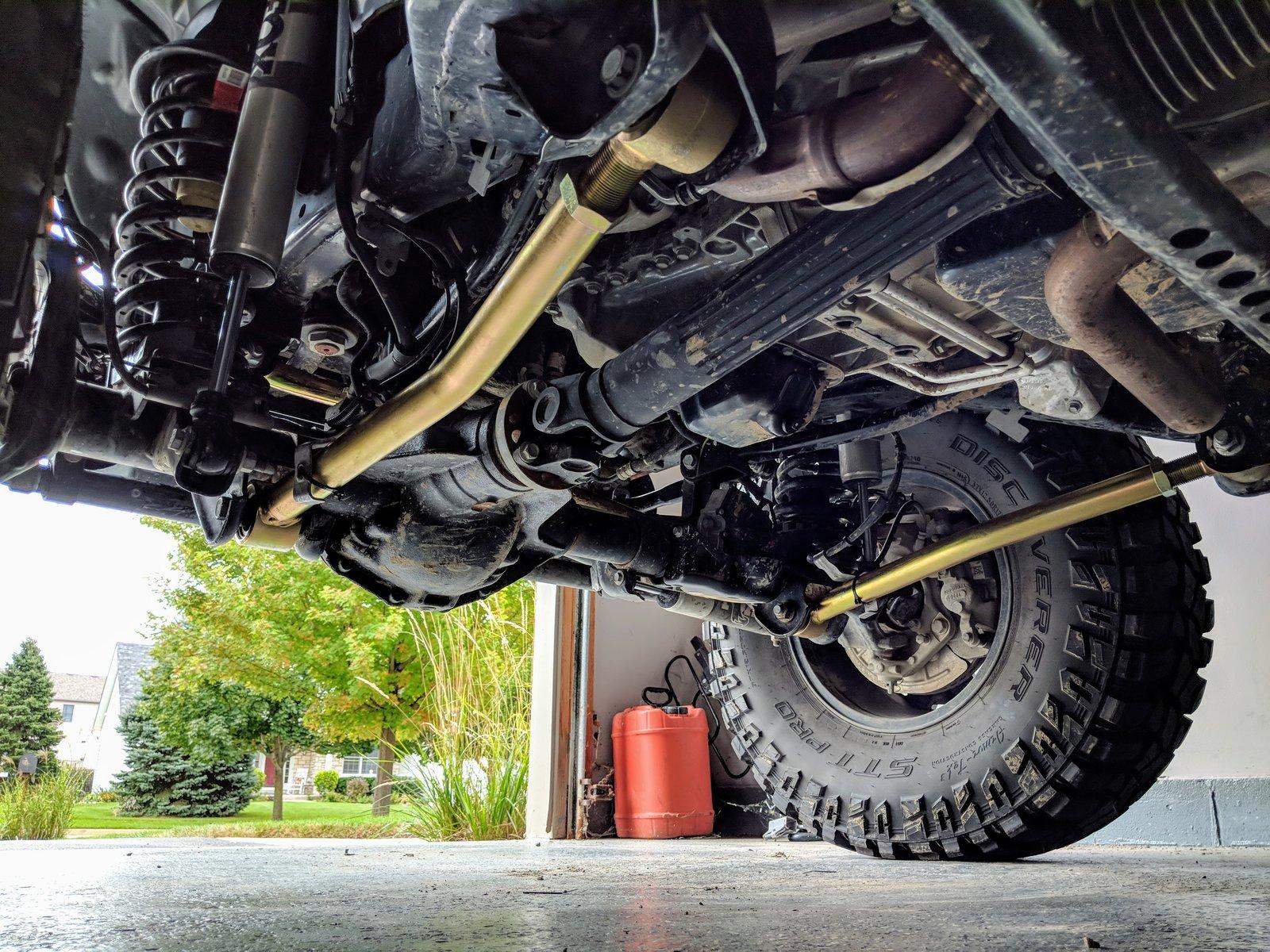

I had the same problem with my Mopar lift and steering wobble. I'm sure if you search my history it will be everywhere there is a thread about steering issues. Above 50 my steering wheel would wobble very very sightly and would drive me up the wall. I tried many things and the best fix for it was adjustable control arms. I extended them to around 6.5 ish degrees of caster (metalcloak recommended 5.5-6.5 and Rusty's even had theirs closer to 7) and it made a night and day difference. The wobble is gone almost entirely on our terrible Illinois roads, there's only one spot I drive on where I can feel it start to happen and this is so minor it's not even 1/32" movement on the wheel if I had to guess .
If I could do it over I would have waited and just gotten a metalcloak lift with falcon shocks or something else that comes with all the proper geometry fixing bits. I ignored all of that when ordering the Mopar lift because I figured a lift from Jeep themselves would be solid. It isn't.
Ignore the zip ties in the photo, ran it like that to the hardware store so I could get a cutoff wheel for that damn brake line bracket.
