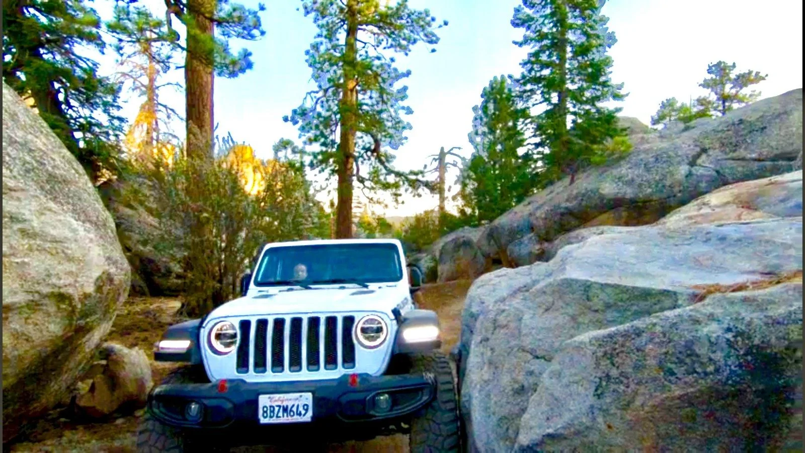

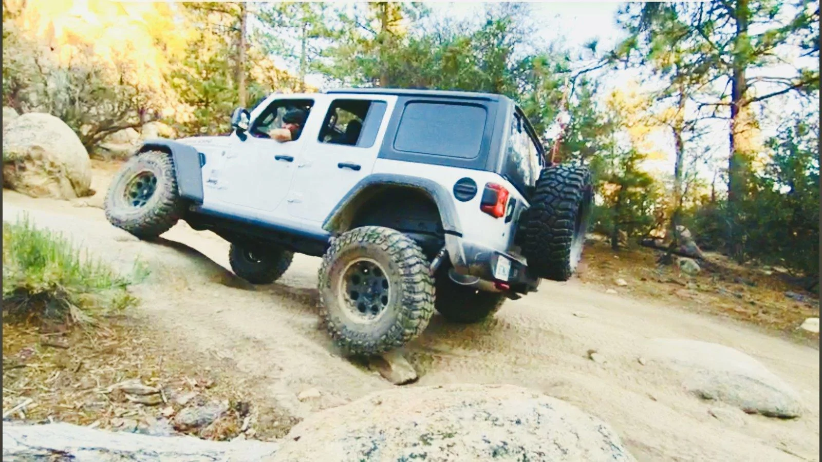

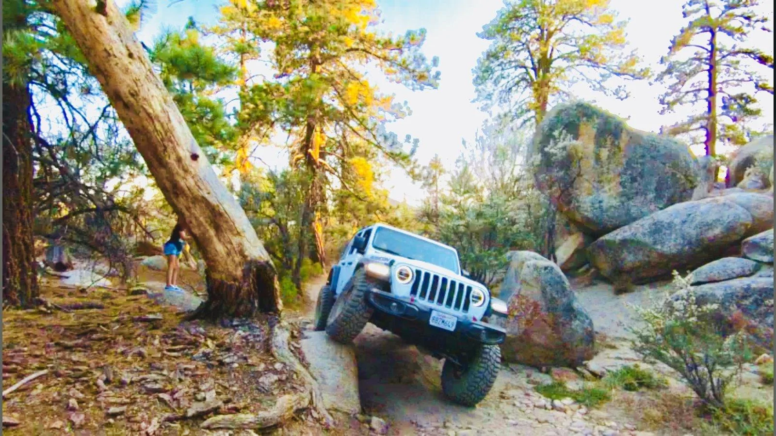

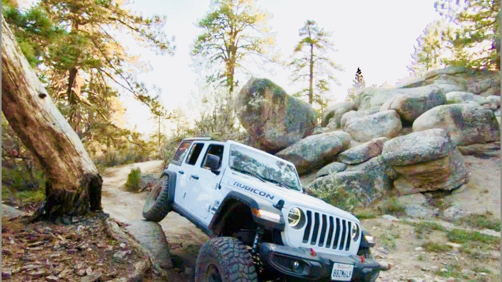

Ok.... So, on road....MUCH better than my spacer kit. I should also note that I’m running at 30 PSI.
Went off road today-Absolutely flawless. Ran the same trail that I did in Big Bear a while back, which was with a JK 3.5” lift on 35’s.
Today was the 2” lift with 37’s, and I felt more stable than ever. Had it tilted at 23 degrees to the passenger side, and couldn’t have been happier.
The RK spring pads worked perfect btw...
37’s and no rub at full stuff, that’s great info :sun:
