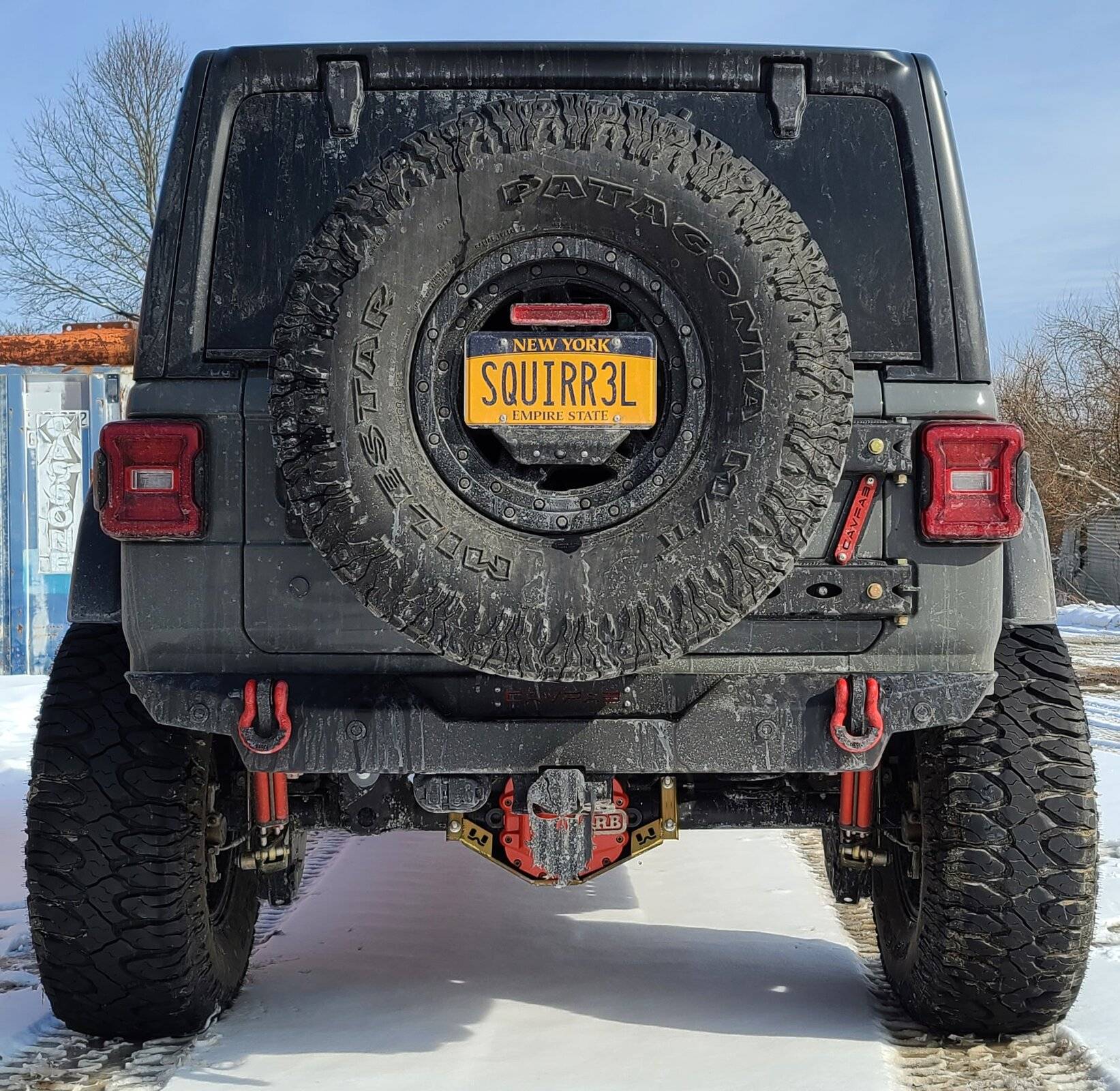

I think the same, whenever someone comments about the sound of the 2.0 motor. A few hundred bucks got me a Borla Touring Climber cat-back, and it now has a tasteful rumble without sounding like I'm auditioning for the next fast and furious movie. And a cleaner rear end with more clearance makes it a multi beneficial modification.
That's a Great Point I forgot to mention. The OEM soda can shaped muffler should be replaced on all Wranglers either way. Modifying the muffler is not only good for improved sound but also for clearance! That's a good looking rig Amigo!!!
