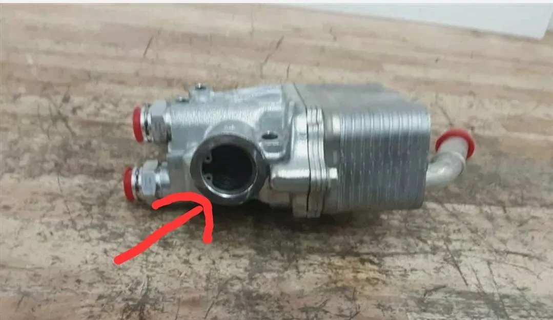

So I ended up ordering new transmission bypass heater. We installed it today. The new part DOESN'T have the bypass valve in it, they redesign this heater.
I'm interested to see if this cures your high temps. If you had a sticking thermal bypass valve does removing and replacing the OEM cooler eliminate the OEM bypass valve as part of the OEM cooler assembly? Or is the thermal bypass in the transmission?
So I ended up ordering and installing new transmission heater for the jeep, mopar part 68485460AB. When I received this part by mail I notice it look different then the the heater that the jeep came with from the dealer. The heater they send me have NO bypass valve in it.. my transmission doesn't pass 195 - 205F after installing the new part, on road or off road. Its just unbelievable. transmission heater cost me $150 after tax and delivery install was $450 (didn't install it at the dealer).
Apparently for "some" reason Part #68485460AB is replacing part #68233384AB which is the original transmission heater came with the jeep..
Attached is a picture of the old transmission heater, the bypass valve is where the mark is.. if your transmission is getting hot this pc might be the reason and that's exactly what ZF technician told me over the phone when I started asking questions about why my transmission is getting so hot.
Again, the new part does not have this valve there.
This is the link for mopar where its also mention part 68485460AB is replacing part 68233384AB. I would call them and give them vin number just to confirm it's actually fit to your jeep.
https://www.moparpartsinc.com/p/jeep__Wrangler/HEATER-TRANSMISSION/94853043/68485460AB.html
Jeep Wrangler JL Hot Transmission Screenshot_20220222-235229_eBay
This sounds incredibly promising. ordering this today
Hey think I’m having the same heating issues. I have a 2.0 sport A/T. Do you think this will help ? I’m wondering if it’ll fit mine.

Hi,
If this is this is the issue you have this part will fix it 100%.
I did a lot of investigation before I replaced it and the only thing that go go worng with my Issue wast this bypass heater.
I can express enough how happy I am for doing thing this. My transmission is not going over 205 In any situation, off roan on road , crawling. It's just unbelievable to see this.
If you decide to to it I suggest you call the service line and give them your vin number to see if this part actually fit your jeep.
I highly recommend it.

Hi,
That’s awesome ! Thanks for the reply. I wonder if the engineers decided to change this for 2020 +. I have a 2019

Hi,
Try to replace the heater, I'm sure you will never see 240f again.
When I had the issue 8 called ZF technical support and the tech guy told me that the heater valve should get fully open once reach to 180f. He said healthy temp for this transmission is 180f to 220/230f.
He was the one who actually told me that the issue I have is for sure the heater valve..
I'm towing smittybilt scout ovarland trailer with 4 person tent on it and water tank, never got more then 208f since I replace this part.
