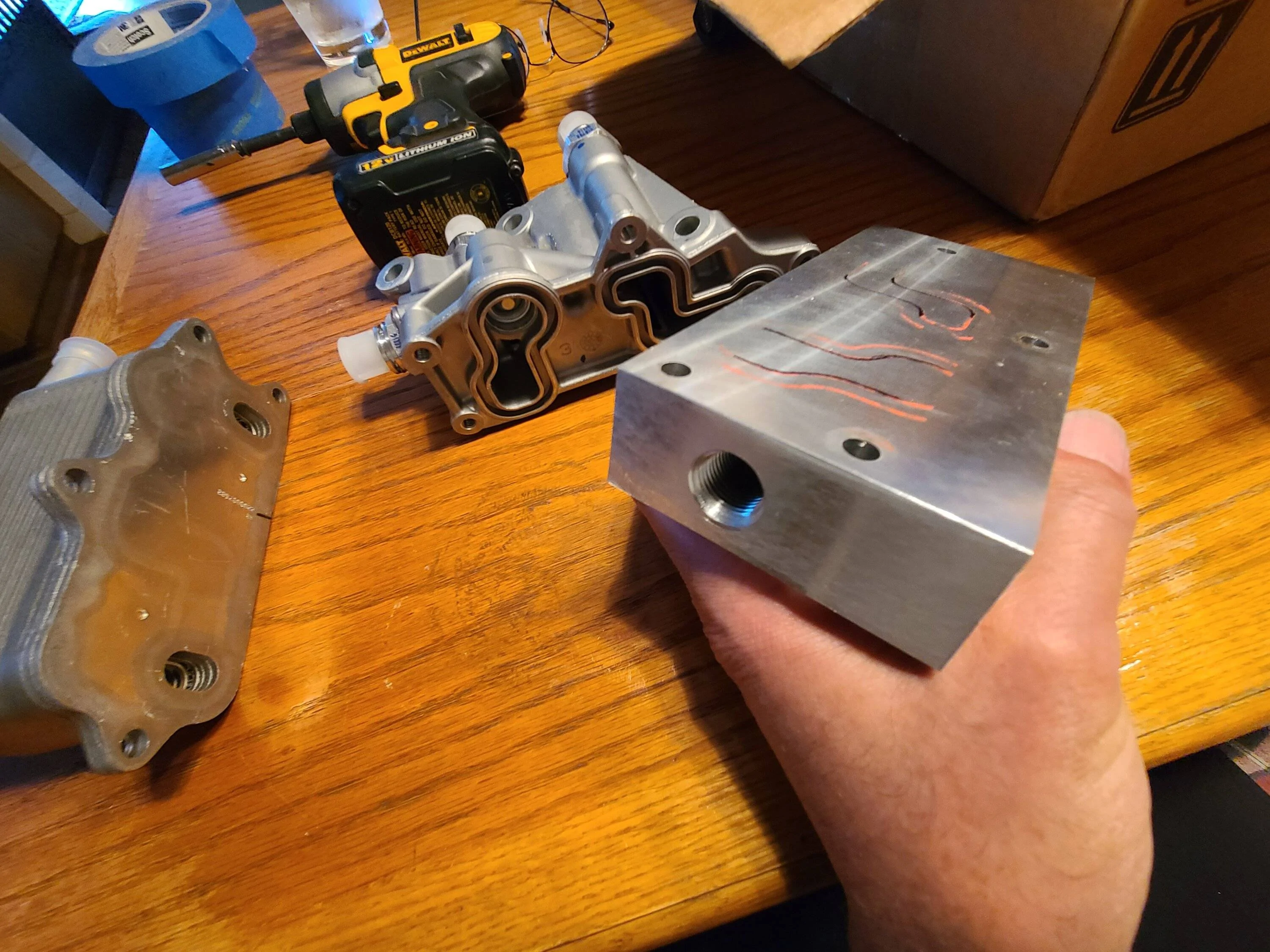

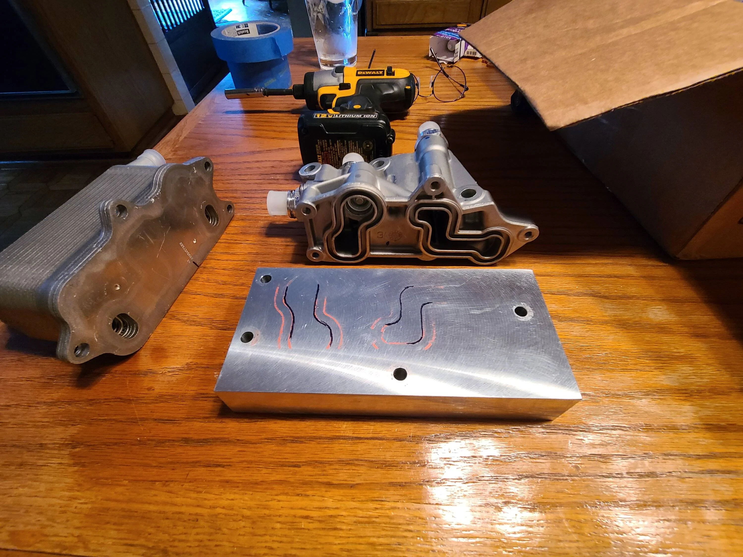

Since I live in southern California, and I don't think I'll ever be using my Jeep in the bitter cold and I'd like to reduce the heat input to the tranmission fluid, I decided I'd eliminate the heater with a bypass (not a block-off) plate. I started on it today. Spent a lot of time looking for things....looking for some aluminum plate, looking for drills, flycutter, tools, etc. But that's the realities of coming into someone else's shop to work on something.
Anyway, I squared up (milled a few sides flat) an old beat up greasy remnant of 6061 T6 I found at a salvage metal yard, transfer punched the hole pattern from the heater, drilled that pattern and cross drilled a 9/16" hole from one end, and threaded it for a 3/8" NPT plug. I didn't finish today before the shop closed, so I'll finish up next visit. Maybe tomorrow...
This evening, I borrowed some of my wife's artist tracing paper, cut a small patch and then taped up the face of the valve body where the O-rings go, with blue masking tape a few layers thick, then put assembled the plate on the valve body with the tracing paper between them and torqued it down. I took it out in the garage and found a 2x4 a couple feet long and beat on the plate a bit to get the tracing paper to transfer. The tape acted like a shim to push harder on the areas I wanted to transfer the tracing paper ink. I used a felt tip to more permanently mark the ports from the valve body. I'll mill out the pockets tomorrow down into the cross drilled hole. This will be the port that replicates the heater flow path. I'll probably machine it to make it more shaped to the valve body periphery to help lighten it. You'll see....it'll be "a thing of rare beauty" ;) .
BTW, those of you that wish to not have heating from the engine coolant, can simply disconnect the coolant lines from the heater and loop them back. I wanted to get it out of the way of the driveshaft as I'm getting an aftermarket front driveshaft.
