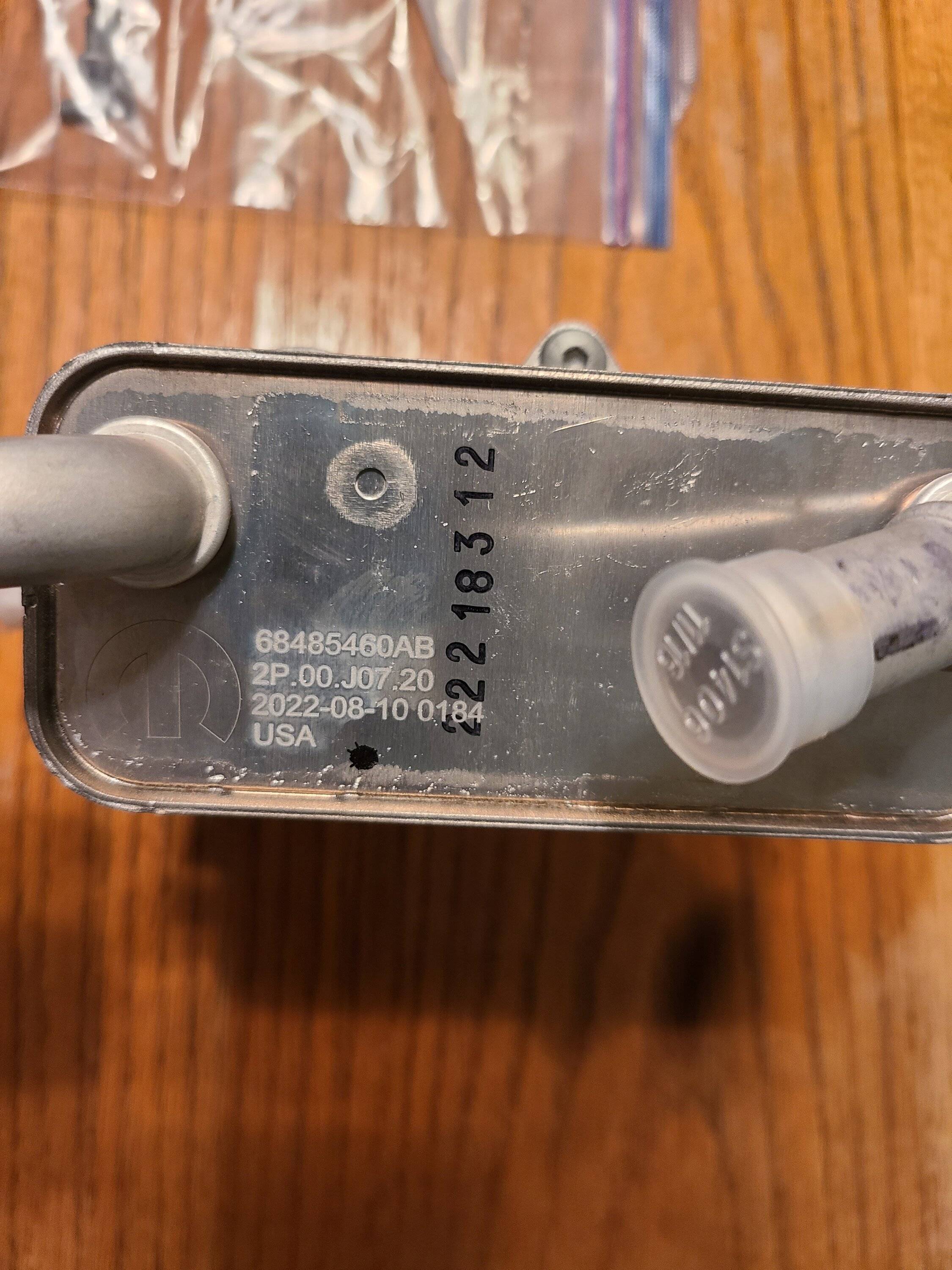

So I ended up ordering and installing new transmission heater for the jeep, mopar part 68485460AB.
Apparently for "some" reason Part #68485460AB is replacing part #68233384AB ….
https://www.moparpartsinc.com/p/jeep__Wrangler/HEATER-TRANSMISSION/94853043/68485460AB.html

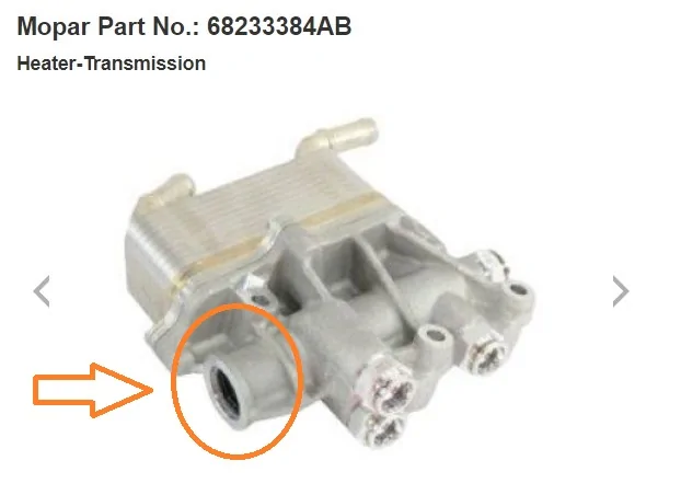

How would one determine if they have the older heater version with the bypass valve? Have a 2021 JLUR.
Also, I do monitor the engine temps in the dash regularly, but what ware the ideal operating temps for coolant, transmission, oil, etc.?
Look at the heater assembly valve body. If it has a round boss cast onto the body, with a plug and snap ring, it is the old heater assembly.
Jeep Wrangler JL Hot Transmission old heater

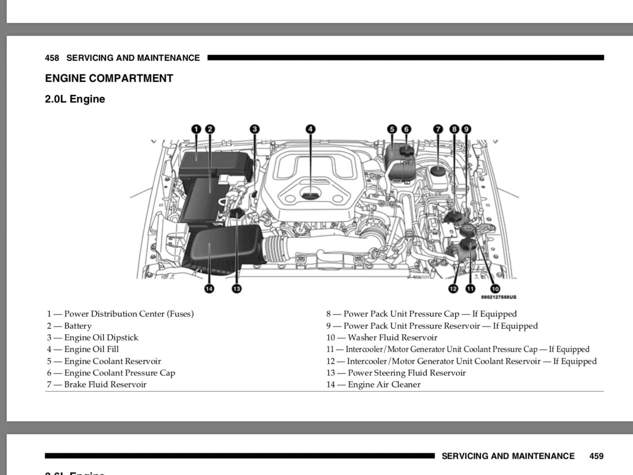

Thanks Roanie, not being mechanically inclined (but trying to learn since I got my Jeep) where-ish, approximately, would it be located? (see photo)
Jeep Wrangler JL Hot Transmission engin
roaniecowpony
Dec 4, 2018
194
12,913
20,420
Retired Engineer
The part is located on the side near the bottom of the transmission next to the driveshaft.
Here is the new heater. Note there is no boss on the casting to contain the thermostat. Also, the heat exchanger itself, will have the part number 68485460AB
Jeep Wrangler JL Hot Transmission 20221018_071025
Jeep Wrangler JL Hot Transmission 20221018_071617
