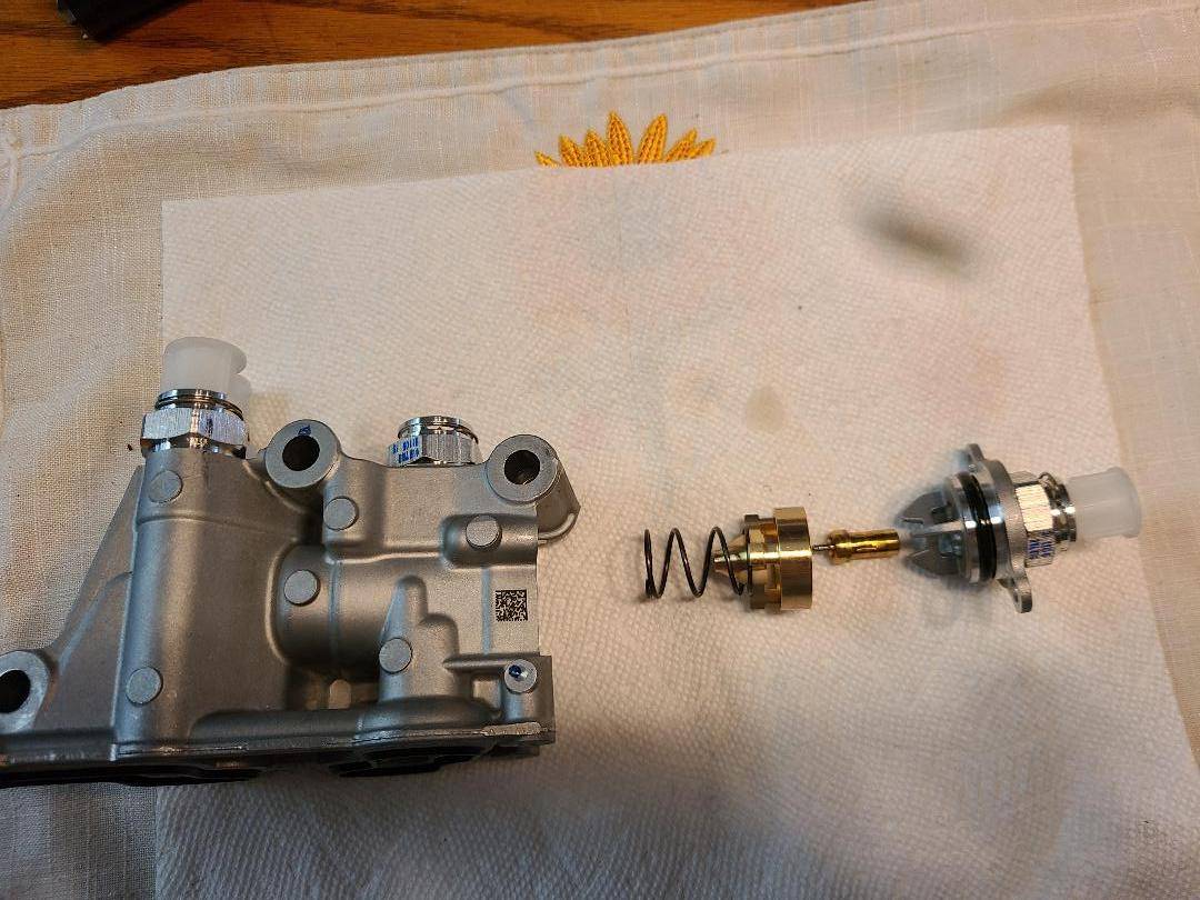

This is the new heater/valve body. Note that the end with the guts there is not a thermostatic valve. It appears to be a sort of pressure regulator. The heater is pretty much full flow and there is a smaller pressure bypass valve (arrow) and passage.
Jeep Wrangler JL Hot Transmission Heat exc
Jeep Wrangler JL Hot Transmission Heater disassembled

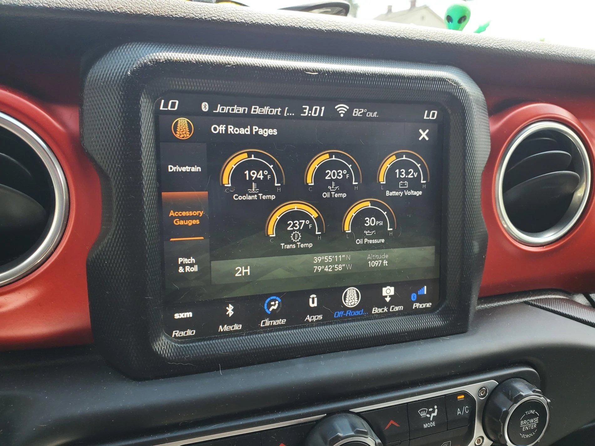

Waiting to see how this turns out for you. I took mine to the dealership today and they said it was normal, even though I know my temps are high. If I start the Jeep and just let it idle, the trans temp will sit around 203. If I drive for 30 minutes or so, it will be between 212 to 224. If I tow my jetski trailer it will hit 237. Dealer blamed my 35" tires, but that really doesn't explain the 203 trans temp at idle.
The annoying this is the cooling fan hits max jet-engine speed somewhere between 212 to 224, and once the fan hits that speed it will not shut off, even if the temp drops back below 200, you have to restart the engine to make the fan stop. It's pretty loud and honestly embarrassing to pull into a parking lot with a Jeep that sounds like it's about to explode.

So I ended up ordering new transmission bypass heater. We installed it today. The new part DOESN'T have the bypass valve in it, they redesign this heater.
So I ended up ordering and installing new transmission heater for the jeep, mopar part 68485460AB. When I received this part by mail I notice it look different then the the heater that the jeep came with from the dealer. The heater they send me have NO bypass valve in it.. my transmission doesn't pass 195 - 205F after installing the new part, on road or off road. Its just unbelievable. transmission heater cost me $150 after tax and delivery install was $450 (didn't install it at the dealer).
Apparently for "some" reason Part #68485460AB is replacing part #68233384AB which is the original transmission heater came with the jeep..
Attached is a picture of the old transmission heater, the bypass valve is where the mark is.. if your transmission is getting hot this pc might be the reason and that's exactly what ZF technician told me over the phone when I started asking questions about why my transmission is getting so hot.
Again, the new part does not have this valve there.
This is the link for mopar where its also mention part 68485460AB is replacing part 68233384AB. I would call them and give them vin number just to confirm it's actually fit to your jeep.
